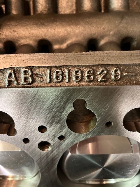

  10. eddie1
    Joined: Jul 27, 2006
    Posts: 571
    eddie1
    Here's the casting numbers. Not sure which brand of gaskets he's tried & unfortunately the gaskets that it was originally ***embled & used successfully for the past 6 years were tossed out

  11. 73RR
    Joined: Jan 29, 2007
    Posts: 7,344
    73RR
    It looks like you have some serious c/r. Nice.
    Your block is indeed a truck casting, 1956-331.
    The heads are 1957 Industrial, Ind56A
    More numbers here: Cylinder Heads | Quality Engineered Components
    The block is typical of the Poly blocks with an elongated pushrod hole and the gaskets most often have accommodations for this. It is unclear as to why the gasket would have interfered with the pushrod.
    For replacement head gaskets just use the 1956 354 part. Yes, you can use a 392 gasket; it will have a larger bore but all else is the same.
    Place your new gasket on the head surface and verify that all holes line up. Do the same on the block and also verify that the dowel pin fits the hole.
    Blocks made after 1955 should have the revised coolant hole at the rear of the deck so not sure which coolant holes you found covered by a 354 gasket...:cool:
