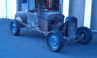

    Here's one (desoto) in a roadster, i'm not reversing the firewall just took a piece out for some m***aging. I'm not cool enough for my own build thread, but heres a sneak peak.
    (radials are for mock up only)
    Kevin

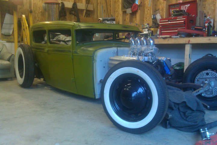

    Here is mine maybe I will finish it one day
