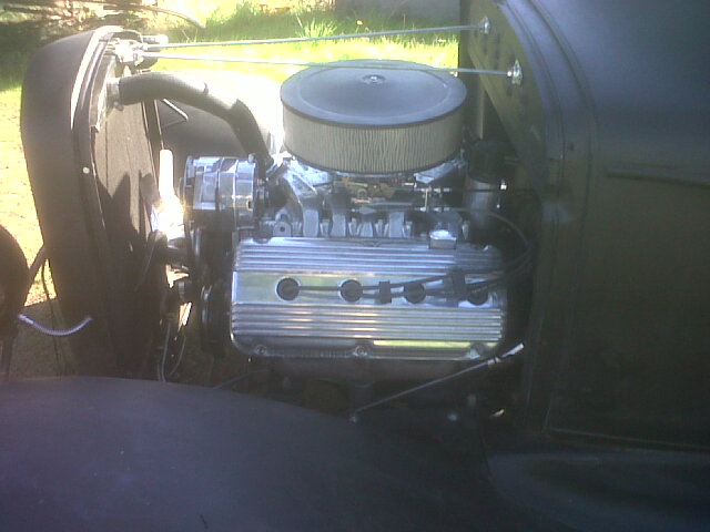

    This is what i was talking about, I made it fit on a 31 frame, i'll put it out there for everyone else

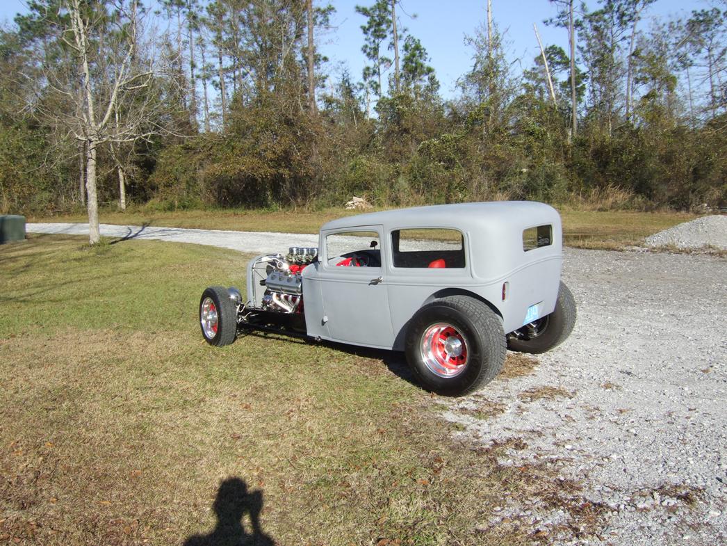

  10. My son's 31 sedan sans roof. 330 DeSoto, *****en firewall, Chev water pump no problems anywhere.

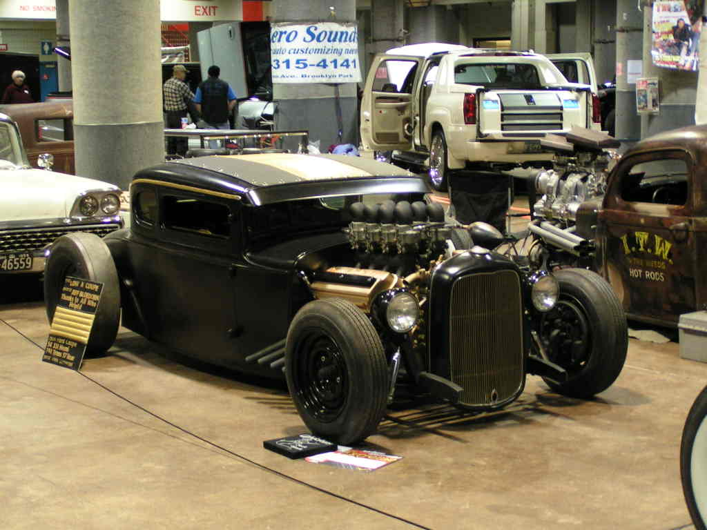

    My baby Hemi...

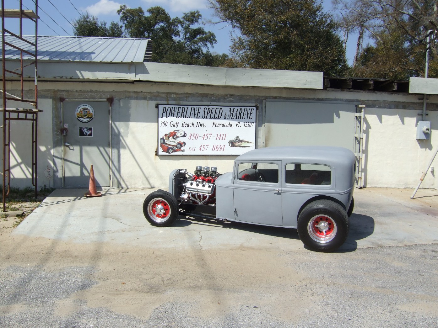

    Here's what I did when all I had was a 31 slant window 4 door town sedan and wanted a hotrod. Since the slant window cars don't have visors I used a 63 Plymouth trunk lid to make a new area above the windshield and the top from the same 63 Plymouth to fill the rest of the roof. The car has a 2" chop and is channeled 8". To make it easier to get in the car the doors were lenghtened 4". The engine is a 341 Desoto mated to a 518 od Mopar ******. Mopar A body 8.75 rearend. I decided to build my own 3 deuce intake and use Rochesters.

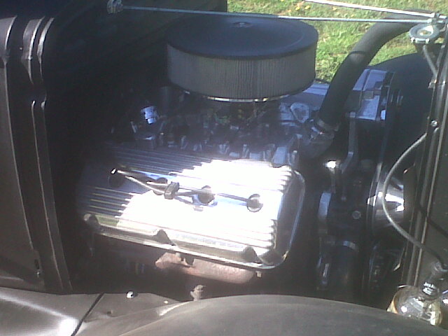

  19. here is mine with help from ***us. Hope to be on the road this year.'55 331.
