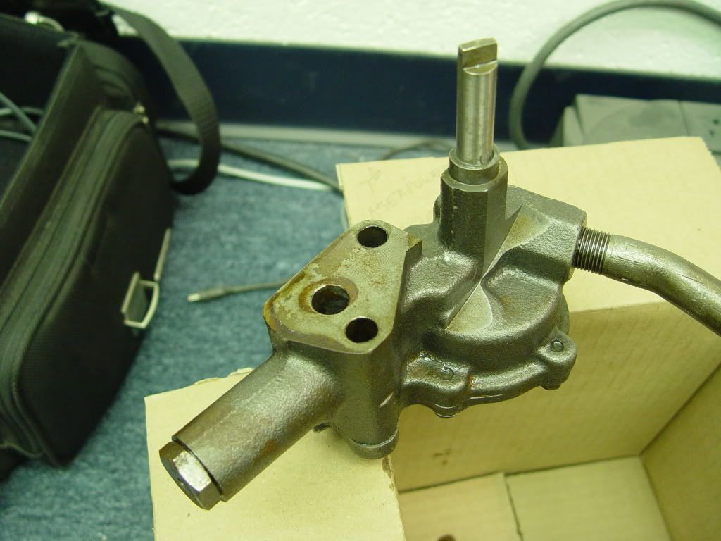

Early Hemi oil pan and pumps - need some input
Discussion in 'The Hokey Ass Message Board' started by scootermcrad, Jan 28, 2009.
  1. I think you have a replacement pump (maybe low mileage?) for several reasons:
    1.) The small cover screws (four in your example) do not have the "DPCD" head markings.
    2.) No Chrysler casting number on the cover. The swinging pickup pumps used 1323361, and the threaded pickup pumps used 1406255.
    3.) The "USA" mark in the casting. Seems to me that would have been unnecessary in the 1950's. Additionally, the OEM castings usually had either a "DPCD" mark or a foundry designation, or both.
    If you have any other pumps, compare the markings. Are there any casting numbers on the pump body? Look closely around the pressure regulator boss.
    The tag and stamping font sure look like Melling to me... I googled "Melling M50" and look what I found:
    http://www.streetperformance.com/part/melling-automotive-products/oil-pump/379702-m50.html
    http://store.summitracing.com/partdetail.asp?part=mel-m50
    http://webpages.charter.net/dhomstad/D500EngineFrame1Source1.htm

    WOW! You appear to be correct! That makes me concerned though... this might mean I can't use it with the earlier 331 block. This pump came off of what would have been a "Dodge" 331 Truck motor (actually a 331 Chrysler installed in a Dodge truck).
    As a new thought, the truck block is pretty much toast. Can the larger rear main cap/pump mount be used on an earlier block?? I could just have it line-bored (and will probably need it anyway, based on what I see).
    OH! No markings on the pump anywhere. Only the USA bit and the tag with the 50 on it.

    ***uming the pump I have is in fact the OEM replacement we discussed earlier in the thread, would I make the ***umption that it would still use a standard rebuild kit (if it even needs it)?
  14. The pump you posted pictures of is, in my opinion, a Melling (aftermarket)replacement - nothing OEM about it.
    I say its a huge ***umption to say OEM parts will fit, as Melling could have used whatever size/design gerotors they wanted (or have in production) to get the volume they designed for.
    You need to measure the inner and outer rotors heights as well as diameters to know for sure.
