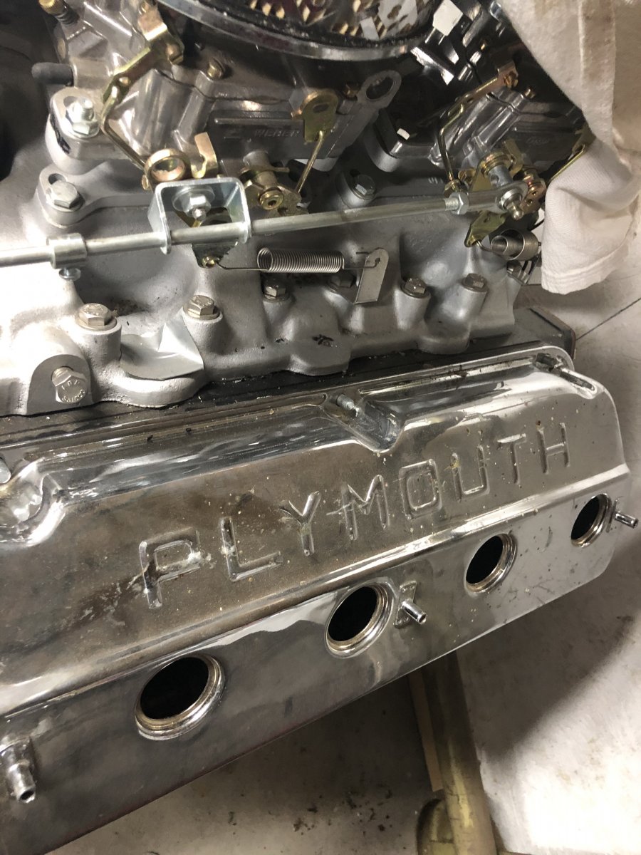

  15. Try building a Plymouth HEMI:D DEC6CC50-4DA1-4FFE-BD86-0E447AFDA8B9.jpeg
  16. gimpyshotrods
    Joined: May 20, 2009
    Posts: 24,585
    gimpyshotrods
    I would, but those valve covers are hard to find.
    Desoto291Hemi and scotty t like this.

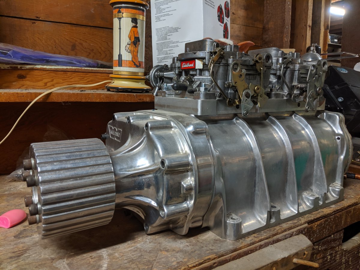

    I know. I have two 354s. One 6-71 blown, one not.
    scotty t likes this.
  19. Pics of blown 354? You're right about those rare Plymouth valve covers!:rolleyes:
  20. gimpyshotrods
    Posts: 24,585
    gimpyshotrods
    Both are in every piece that they could be in. I spent the weekend working on blower rotor clearances, rotor timing, and the design for the hidden (gasp!) EFI system (just don't tell anyone here).

  23. gimpyshotrods
    Posts: 24,585
    gimpyshotrods

  24. Hombre
    Joined: Aug 22, 2008
    Posts: 1,075
    Hombre
    Now those are cool pieces! Well done.
