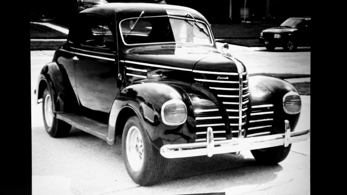

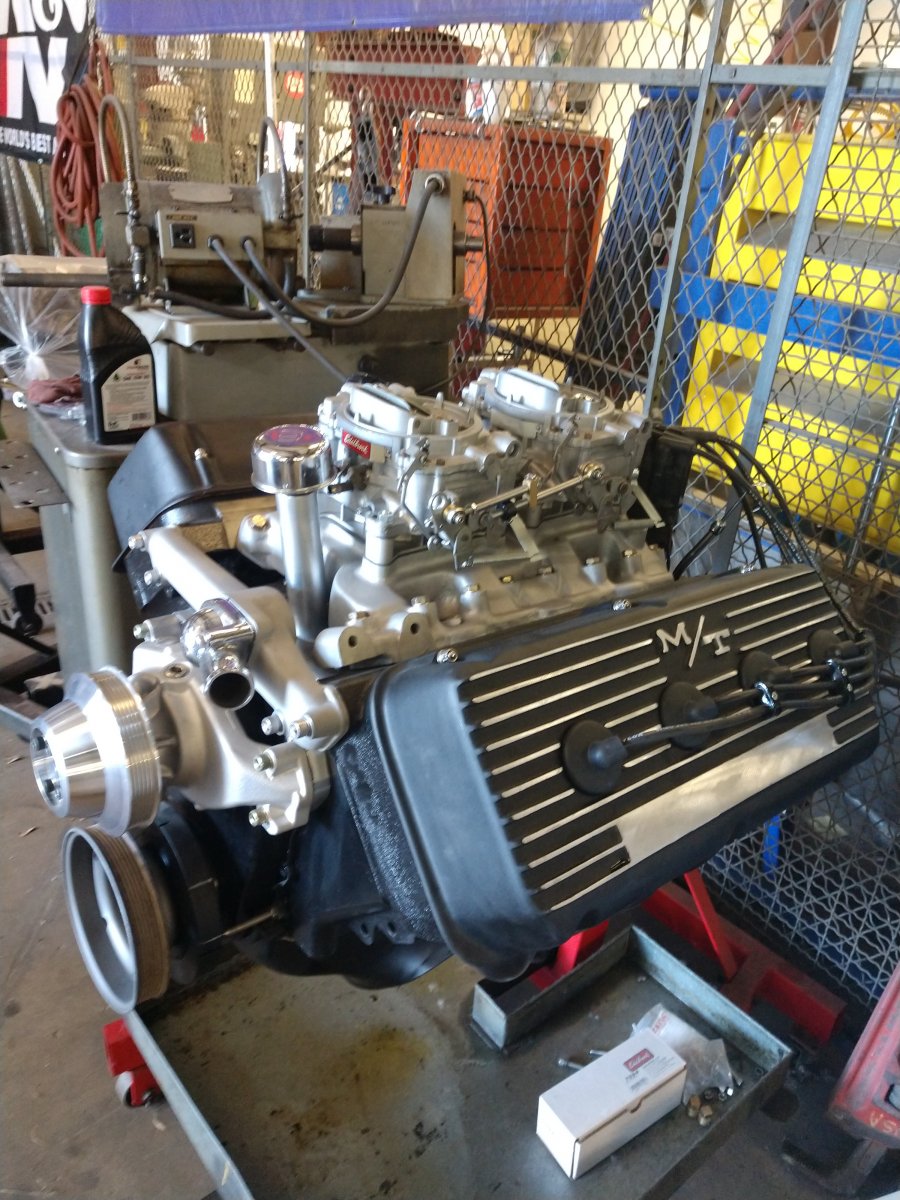

    from ohio
    I have had two 426 racing engines and they are sweet. I have a 392 to put in my 39 Plymouth for the street. IMG_20190914_120702764.jpg IMG_20161211_081440677.jpg
