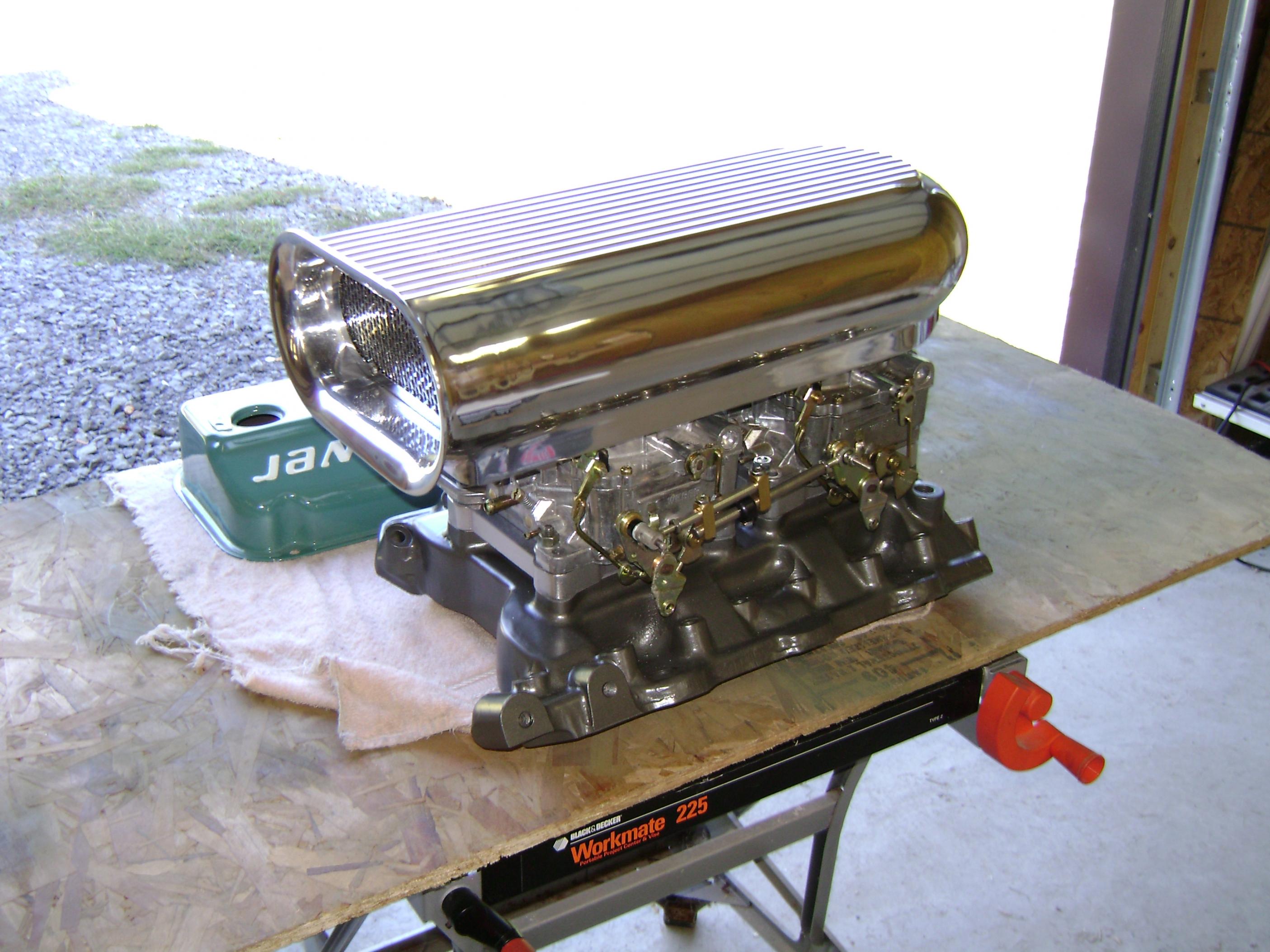

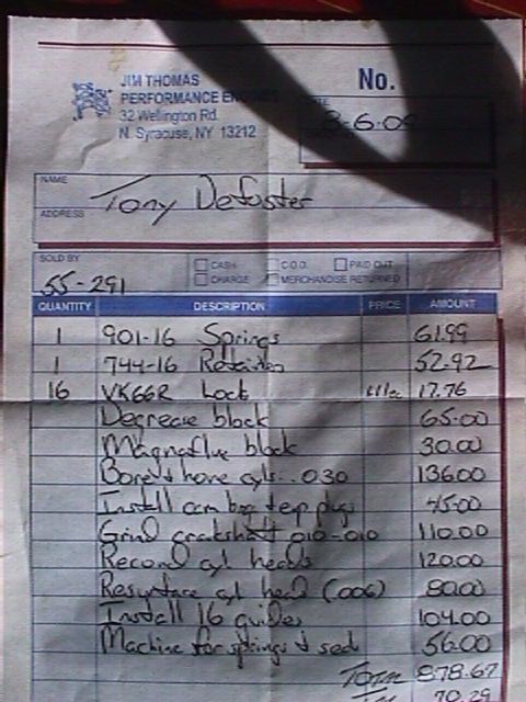

  20. $400 for .030 new pistons & pins(Badger)/rings(Grant), $198 for rod/main bearings(King), $100 for a set of NIB Comp Cam Roller Lifters(unused from sold project), BIG $$$ for Roller Cam!, Stock valves in perfect condition, pistons individually fitted to each bore, ALL threads in head and block chased...picture of Bill for Machine work enclosed. Try Falcon Global in FL for obsolete parts. That's where I got most of my stuff for my rebuild from, and they're VERY competative...:D
