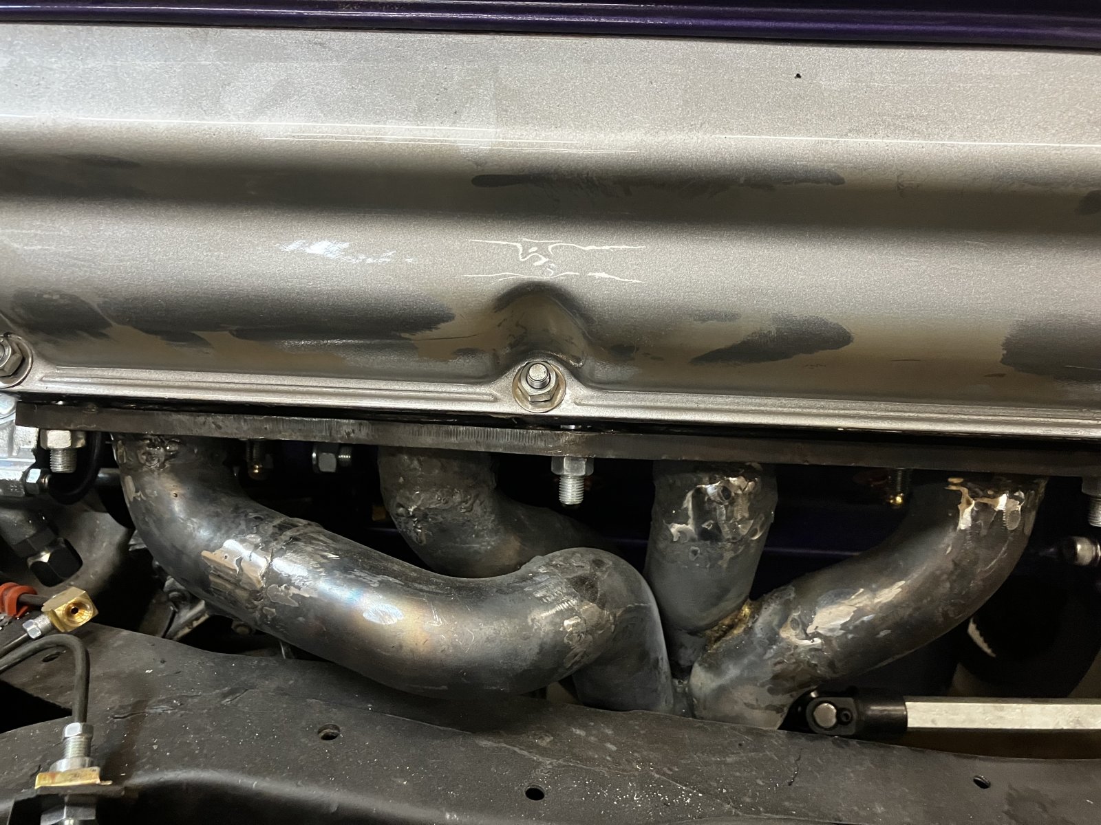

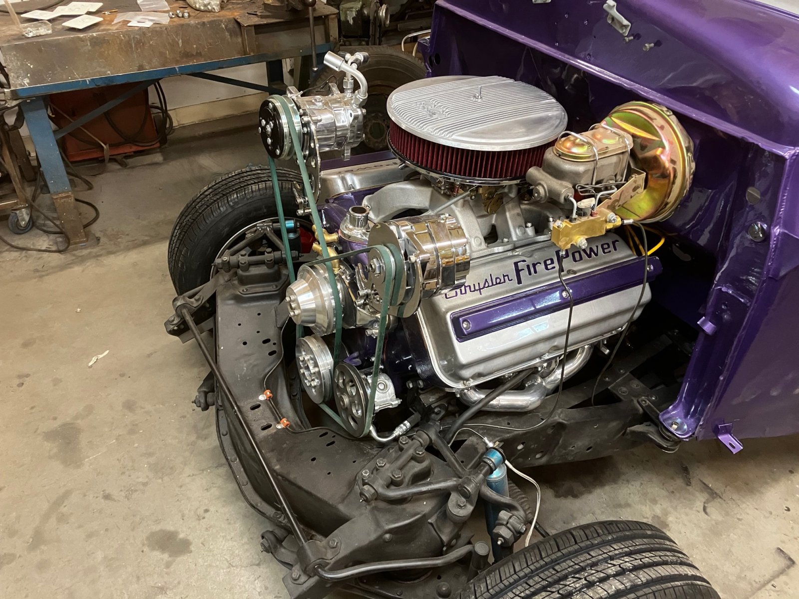

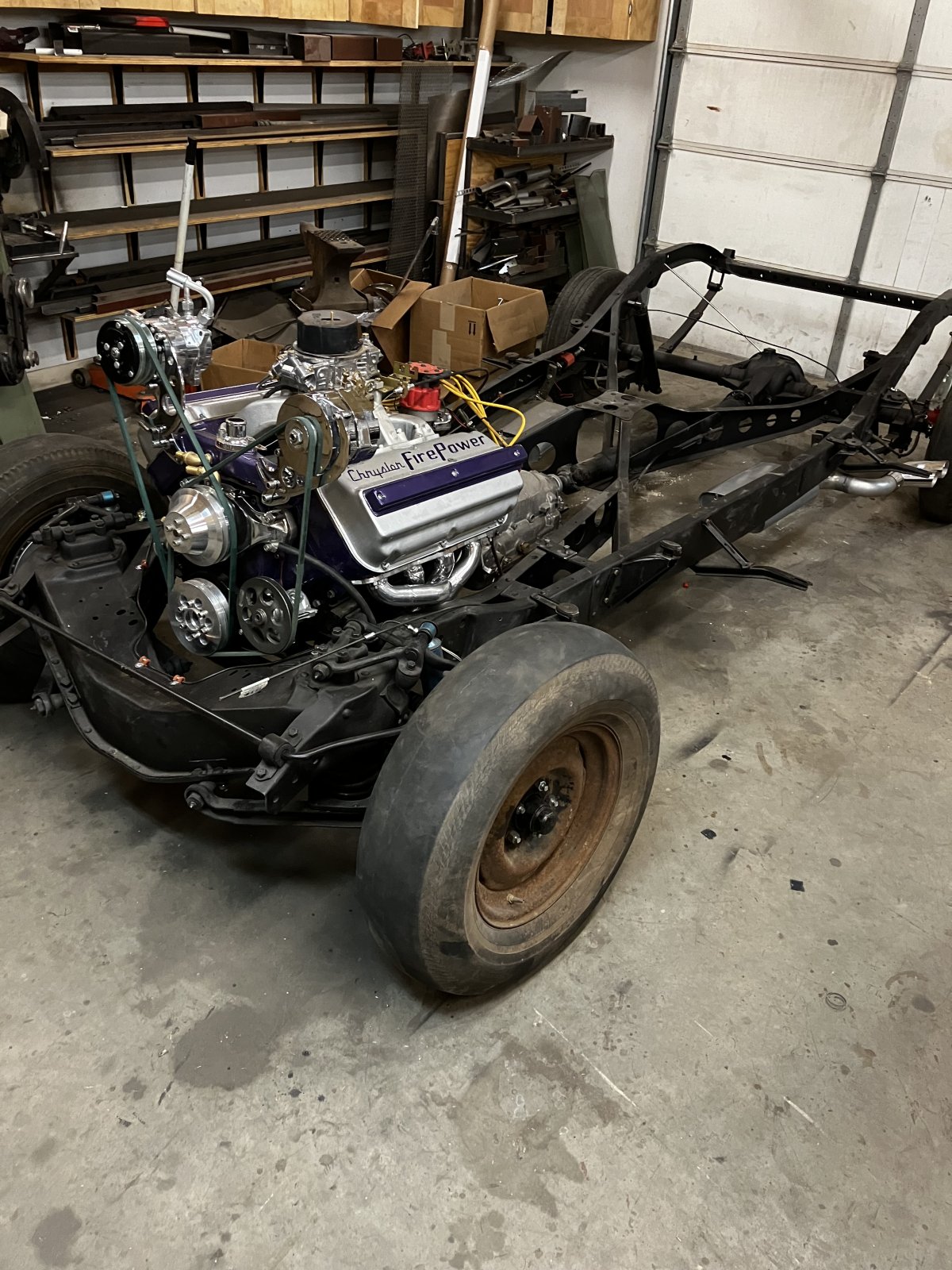

    I just put a Chrysler 331 in a '40 Plymouth. I was able to use all the stock sheet metal. Had to weld a couple small pop-outs on the inner fenders to clear the front of the valve covers. Your baby hemi should fit.

    You might be confusing the photos of my '54 331 inn my '40 Plymouth with the author LeoSmall's engine. He didn't post any photos. And I went the other direction from you on my other 331 in my Willys. I bored it 1/8" over making it a 354 then adapted truck heads for the bigger valves and ports over the small passenger ones on '52 engines.
