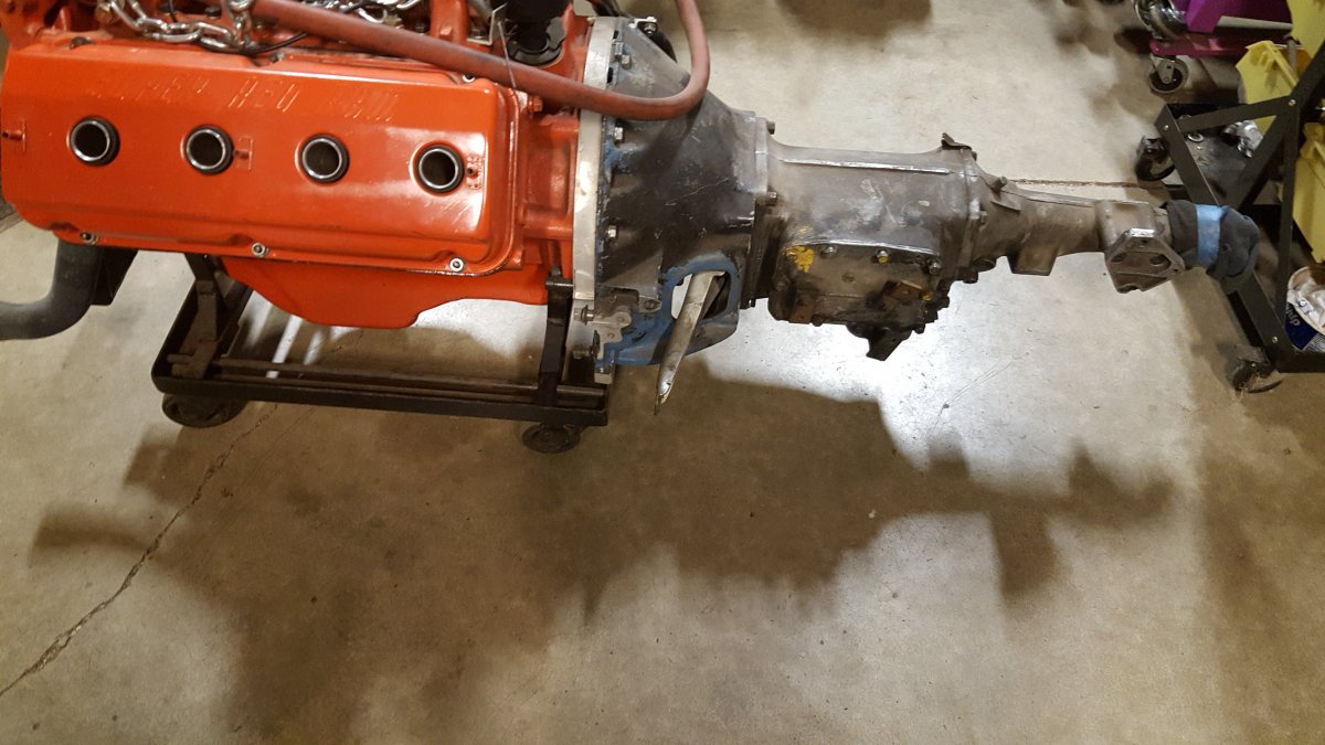

  6. If there was a Cheaper, Easier or Better way to do it I would have found it by now. I use a complete 340-360 Flywheel and Clutch unit, just drilled the 8 bolt pattern into the Flywheel. No machine work for Ring Gear required.
    20171008_080623.jpg The Wizzard

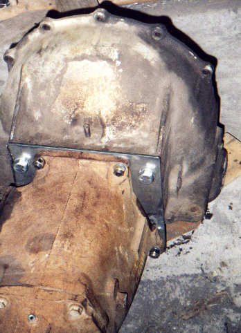

    Here is pic of Kerry's set-up:
    Look through my website for more information.
