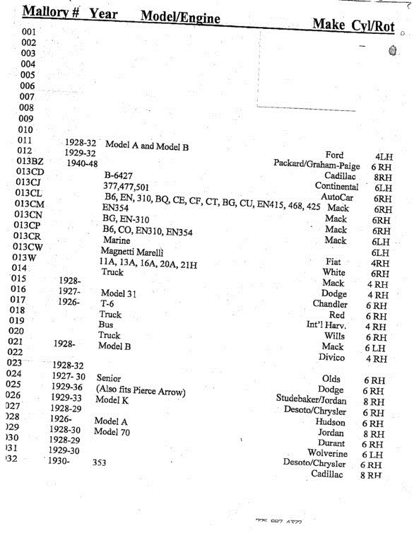

    If the points are not significantly burned, you can just file them with a points file, and use them again. I put a lot of miles on Mallory distributors and never replaced points.
    11 is for a Model A, as you thought.
