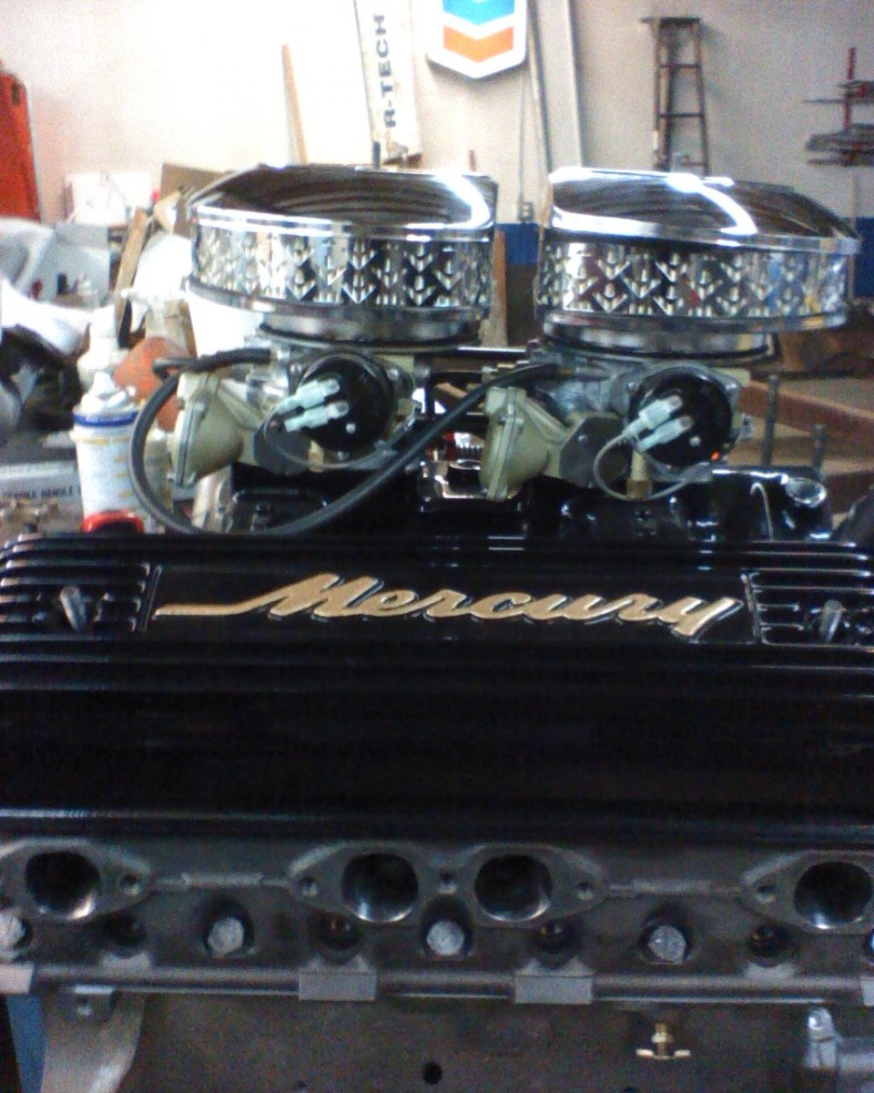

    In the late 1950s,as I was looking for a OHV V8 of some type for my hot rod build,my first pick would of been Studebaker with a 4bbl,but what I did find that was low mileage,was Ford Y-block Thunder Bird from my good buddy's Dad,airline pilot for Eastern. He had crashed his 57 t-bird,it was still behind his house growing tall weeds more then two years later. So I ask,at the right time it seems,he said I could have the Y-block V8 if I got the rest out of there !! I used it for my highschool hotrod,my first sweethart. I have kept it,still drive on good weekends. Only thing about anything other then SBC,is others cost more for upkeep and race parts are harder to find.
