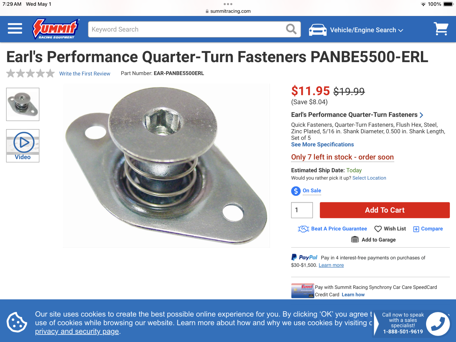

    They might have been hex wrench flat head Dzus fasteners with beveled washers? Did you find any hex wrench versions in their old catalogs?
    These days they sell these self ejecting ones with the hex.

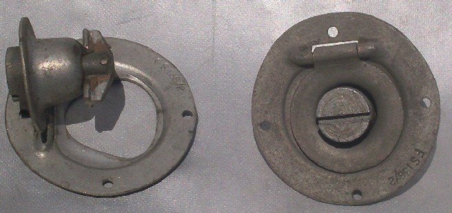

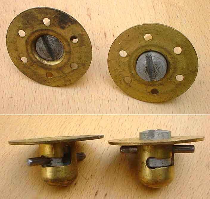

    Prewar aviation fastners used on British war birds...

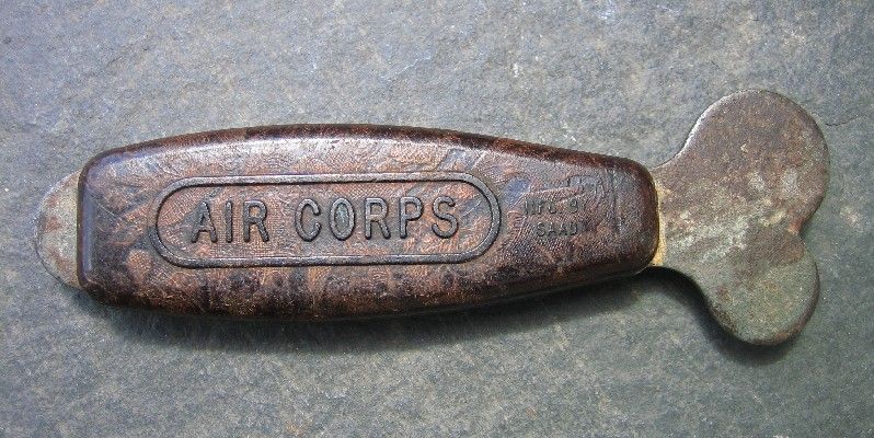

  12. And the period correct tool (the Snoopy tool) is the icing on the cake upload_2024-5-2_9-9-9.jpeg

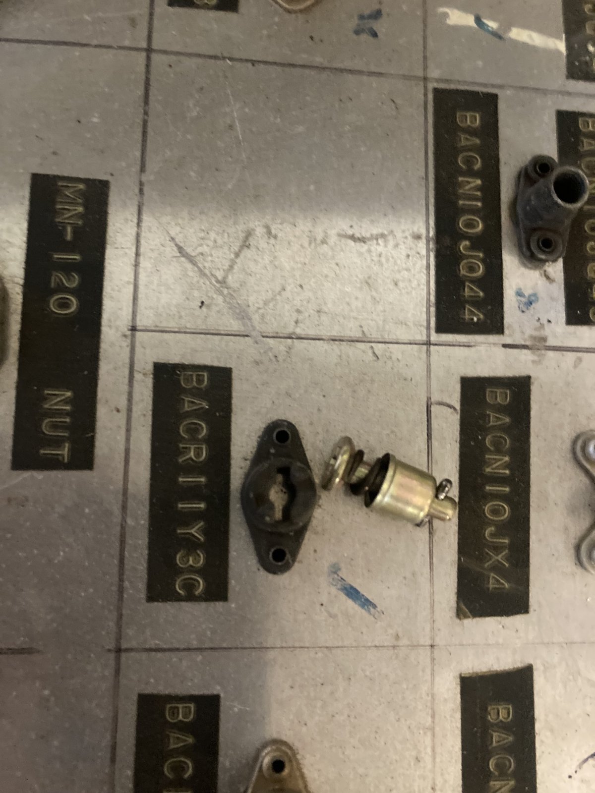

    IMG_9606.jpeg IMG_9608.jpeg IMG_9608.jpeg Here’s a vintage one next too a female they have a star washer that holds the male to the female, and a selection of aircraft anchor nuts that get attached to structure and majority would attach using unf fasteners/screws , just to show you the options that could be on the back of those fasteners holding that panel.

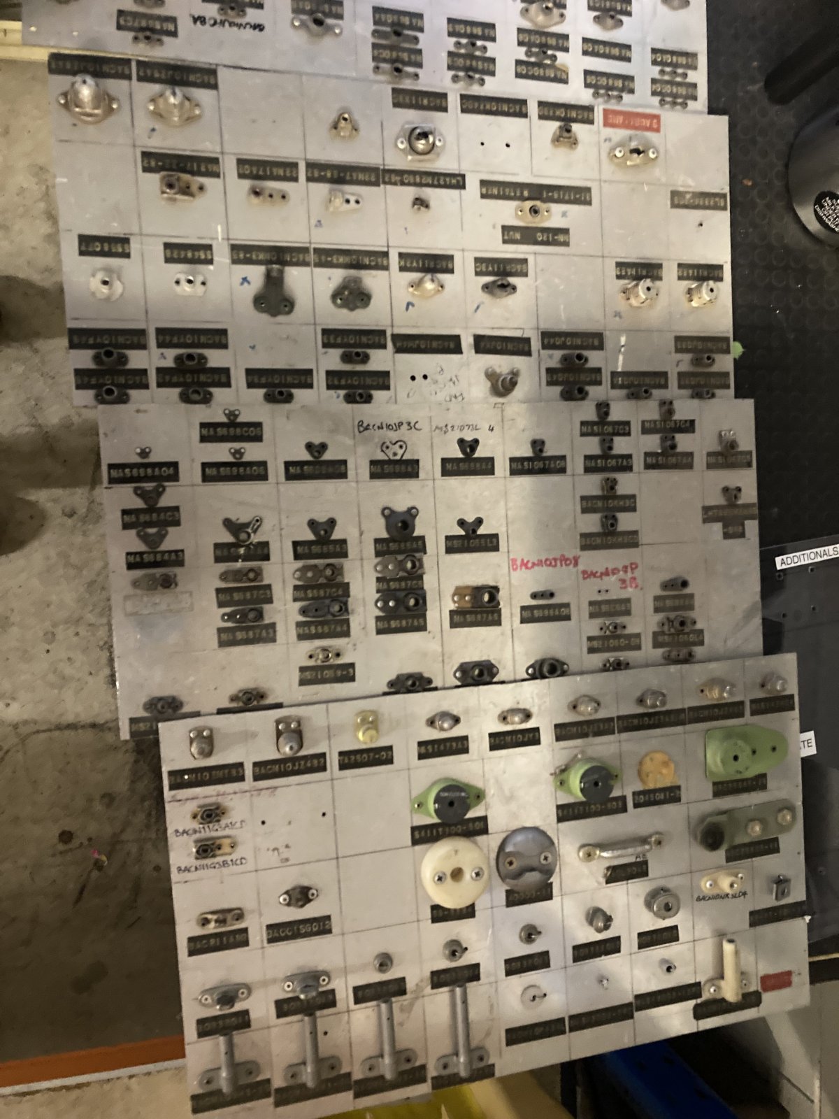

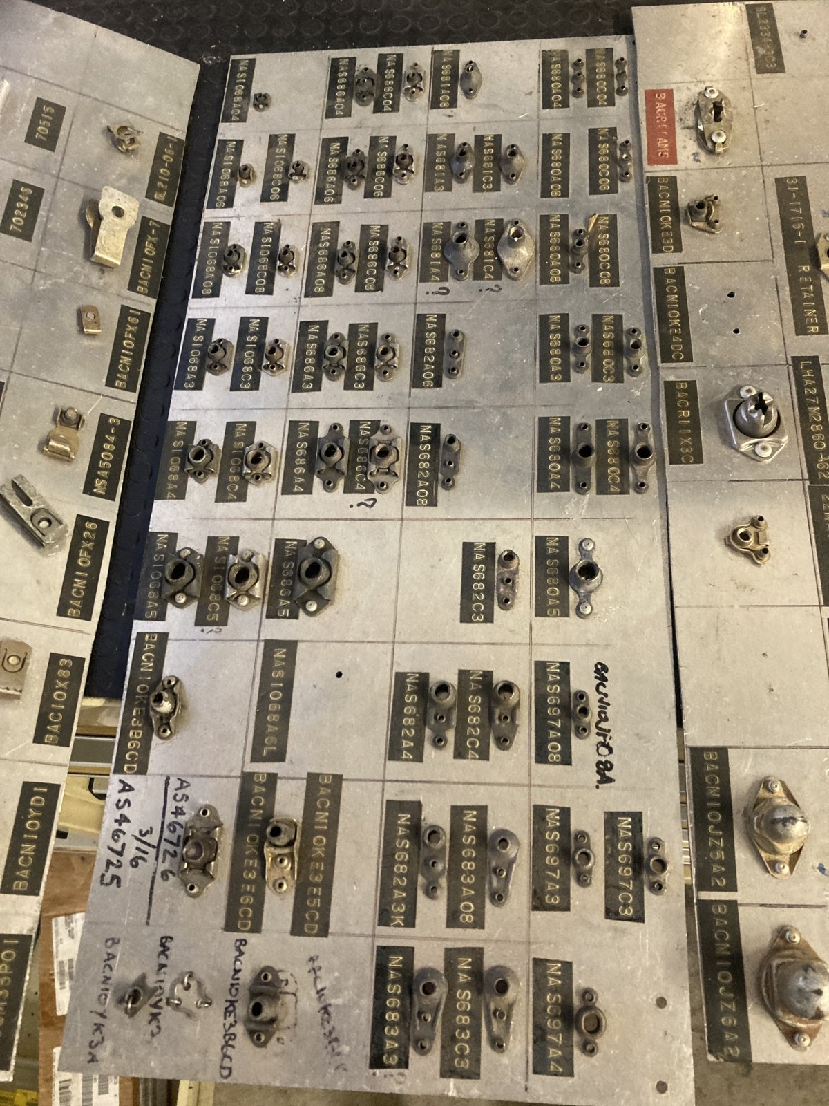

    image.jpg Here’s some more modern versions, plenty of female cam locks in this lot

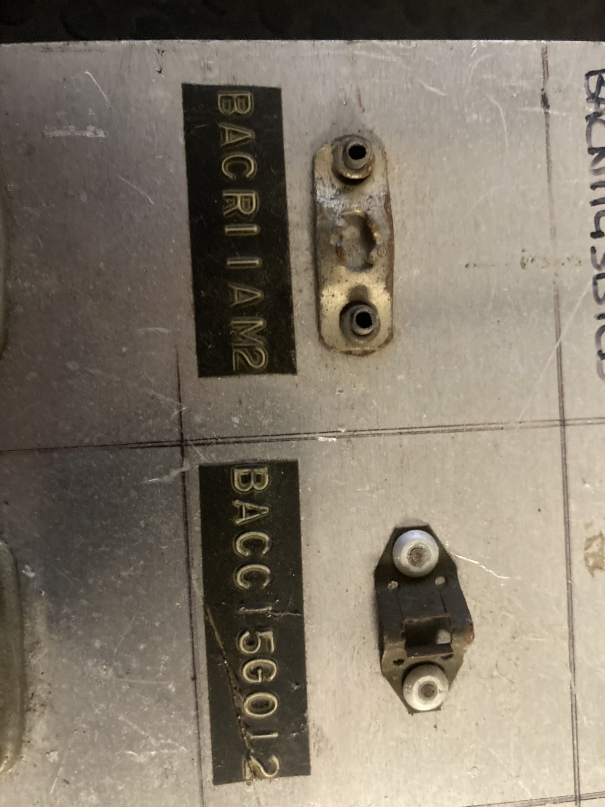

    IMG_9611.jpeg IMG_9611.jpeg IMG_9610.jpeg Sorry just realized how blurry the photos are , hopefully better ones here if anyone wants references part numbers

    Ryan If you look at the tab above the fasteners your referring too, you can see the two rivets that hold a camloc base or anchor nut , these hundreds of variations but most are riveted on like a dzus fasteners

    I love the example boards. Someone went to a lot of time and effort to mount up and label each one for easy identification.
    Makes me wonder about the missing examples though. If it was me, I could imagine getting to the end of a job and missing that last fastener needed to finish. I could wait 2-3 days for a new one to come in... but wait a second... I know where there is a spare one :)

    @Harv I don't know if they have them in your corner of the globe, but the auto parts store I worked at had boards like that for the various annoying plastic clips for late model stuff, so you could match them up. Beats a computer screen picture or having customers dig through the divided boxes.

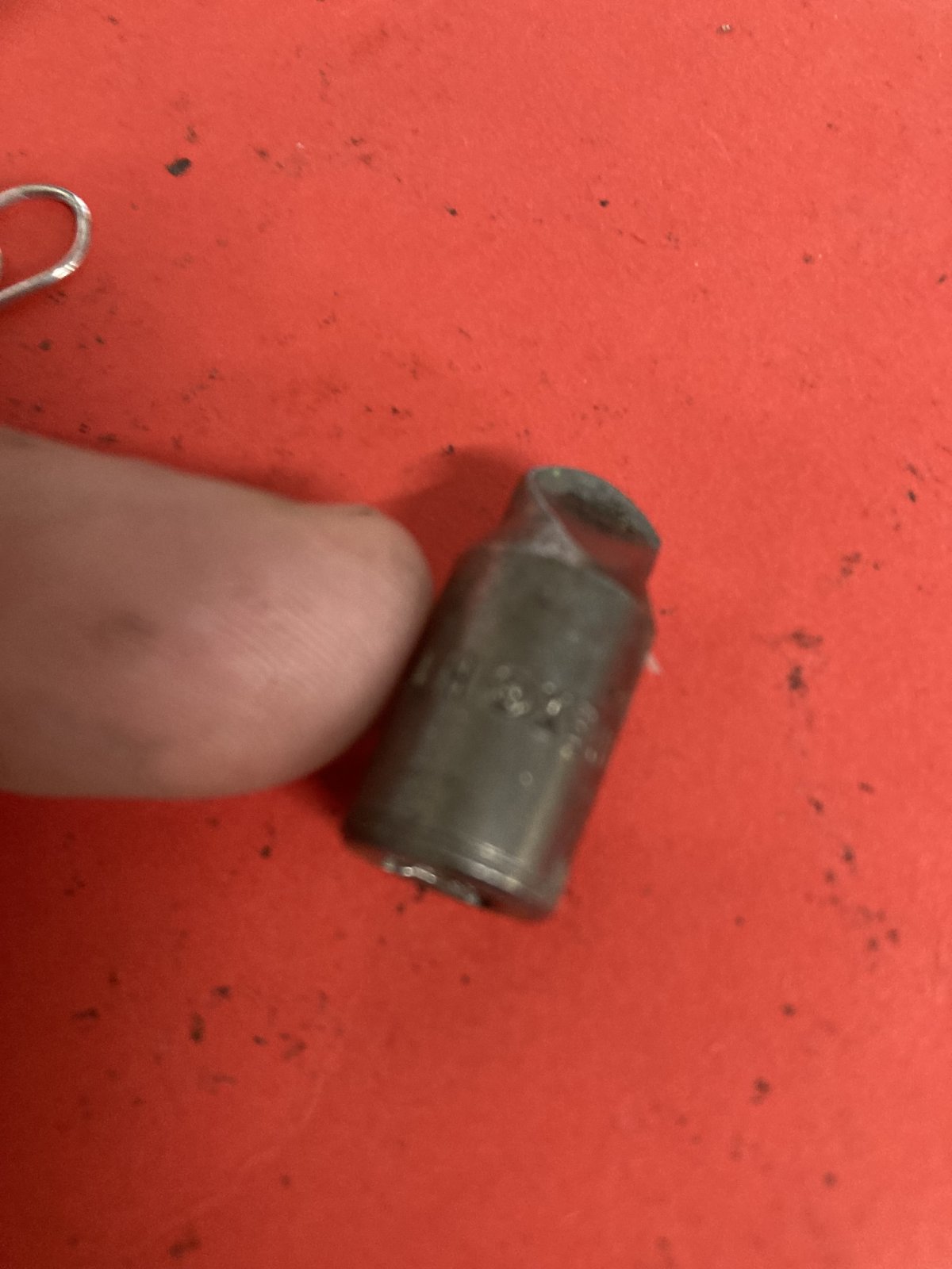

    you can actually get cam locks with the Mickey Mouse ear tabs dzus and others , there’s a few different ones out of curiosity here’s a apex bit for doused fasteners and el types that we use on speed braces and ratchets , they come in about four different sizes

    It’s getting rarer to see a sample board. Some of the older fastener stores do though.
