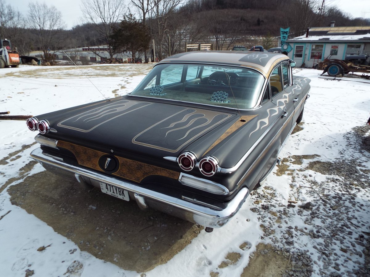

    Got a photo of that car? POCI meet in WI this year :)

    Bird man here's you a couple pictures. Just a family cruiser and will be my daily driver this year. DSCF5956.JPG DSCF5954.JPG

  14. Bird man
    Joined: Dec 28, 2009
    Posts: 1,030
    Bird man
    from Milwaukee
    *****in'
    rebstew187 likes this.
