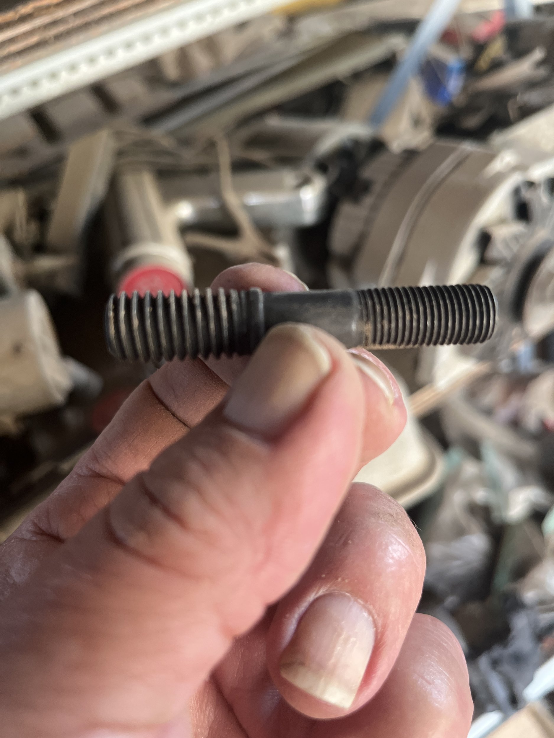

    Not sure on the BBCs, but for a SBC the stud is pulled, then tapped to 7/16th.
    I’ve a set of screw in studs. 3/8th on top, 7/16 in the head
    let me go verify
    bchctybob likes this.

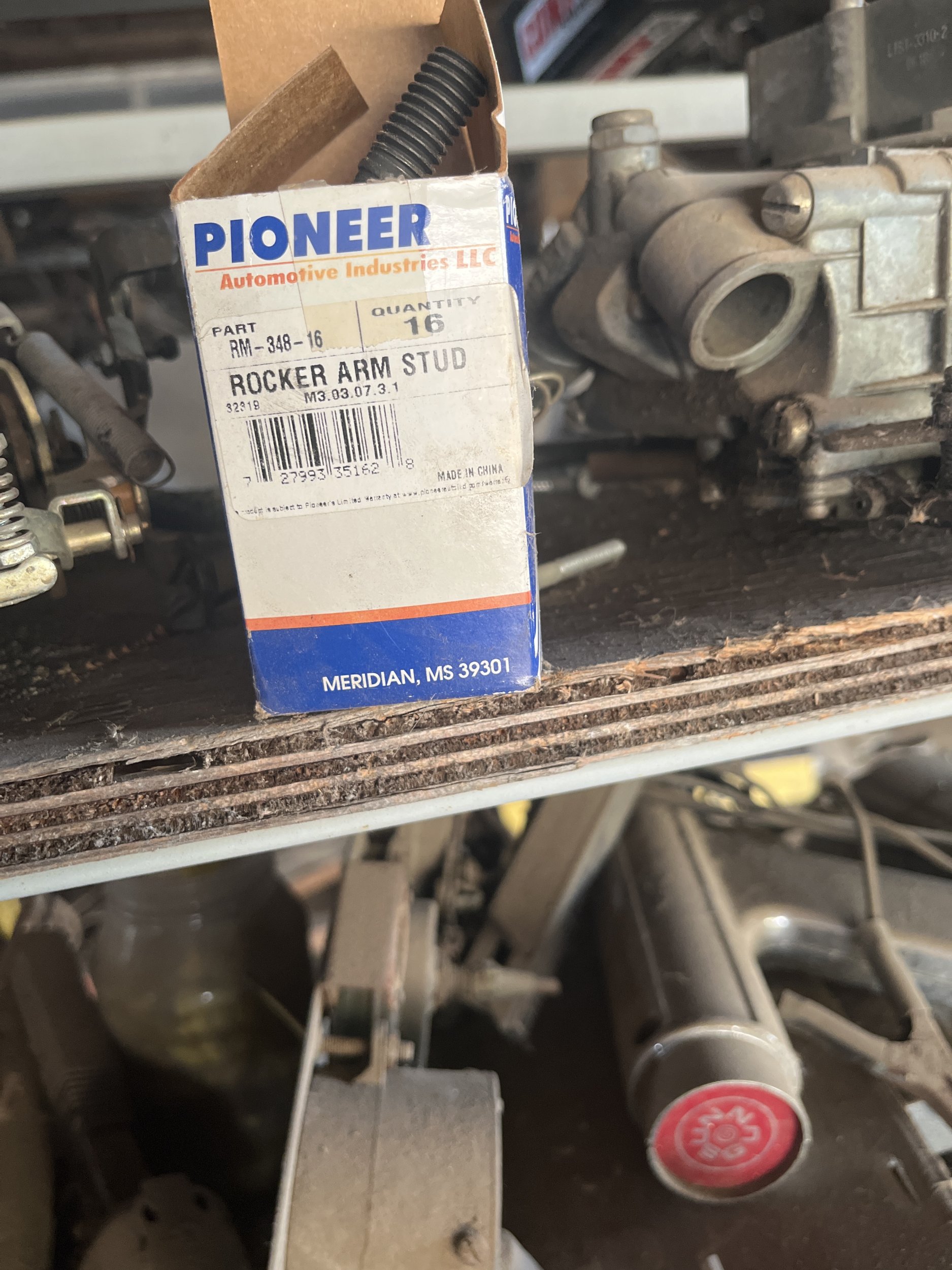

  10. Budget36
    Joined: Nov 29, 2014
    Posts: 15,048
    Budget36
    I won’t be using them, if you need them, will send your way
  11. Budget36
    Posts: 15,048
    Budget36
    Here’s the box

    It occurred to me that I might still have a ‘62 Tempest rocker arm and stud on the shelf out behind my shop leftover from my Tempest project. Sure enough, there they were. I’m assuming that Pontiac used the same geometry and therefore rocker arms on their 1/2 of a 389. They had bottleneck studs that were 7/16 where the ball sits and 3/8 nuts. My later model rockers also use 7/16” balls but have 7/16 threads. Dimensionally, the old Tempest rocker looks to be the same but the slot is slightly longer in the later rocker.
    So it appears that the later model rockers and balls will work on my ‘62 heads with the new 7/16 screw-in studs.
