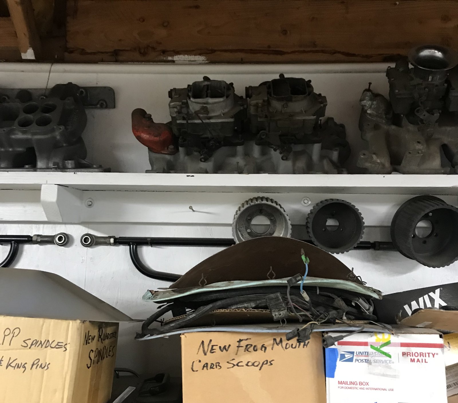

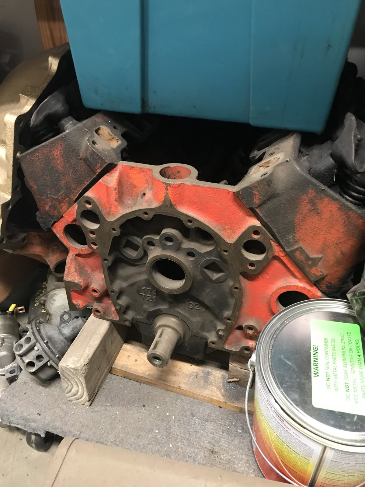

    The heads….
    The intake….
    I’ve got too much junk. I wish it was all cool and stored neatly like Moriarty’s stuff. Lol
