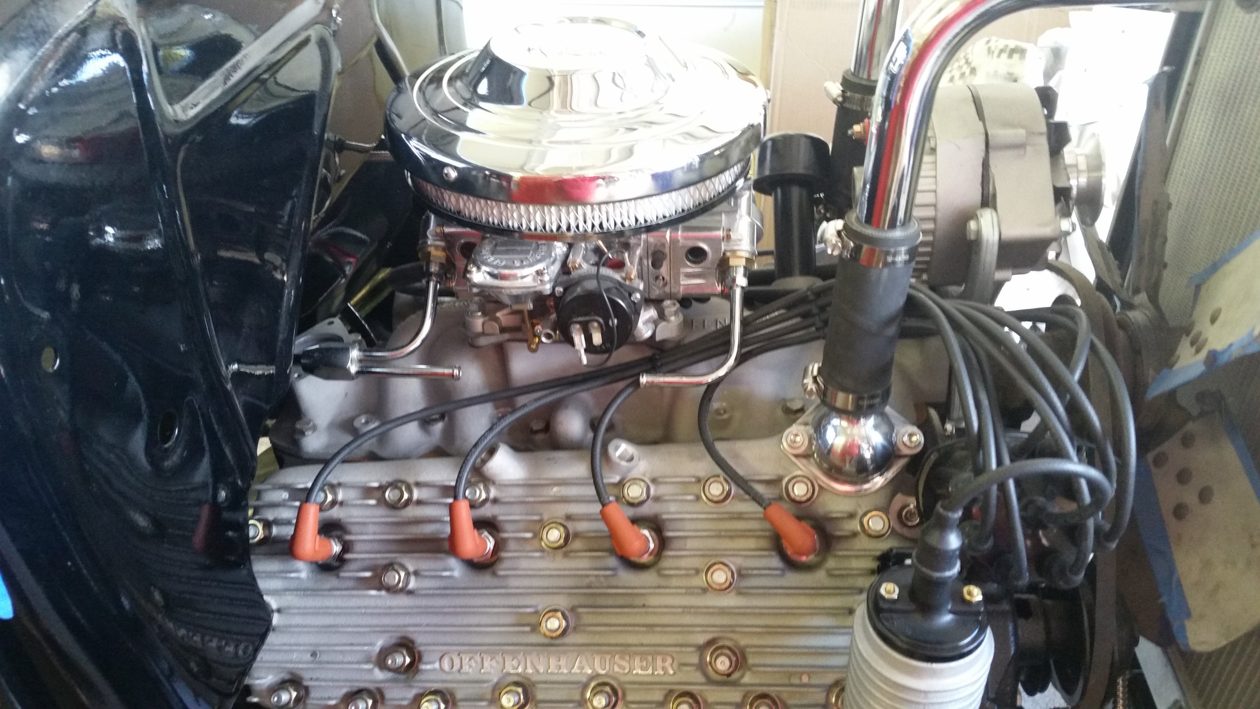

    I bought a $35 dollar air cleaner from Speedway and took the top off it and replaced it with a Mercury hubcap for use on my flathead when I ran it with a 4bbl. It came out nice I thought. Didn't stay with the 4 bbl though. If I can find a pic of it I'll post it up. Was simple to make.

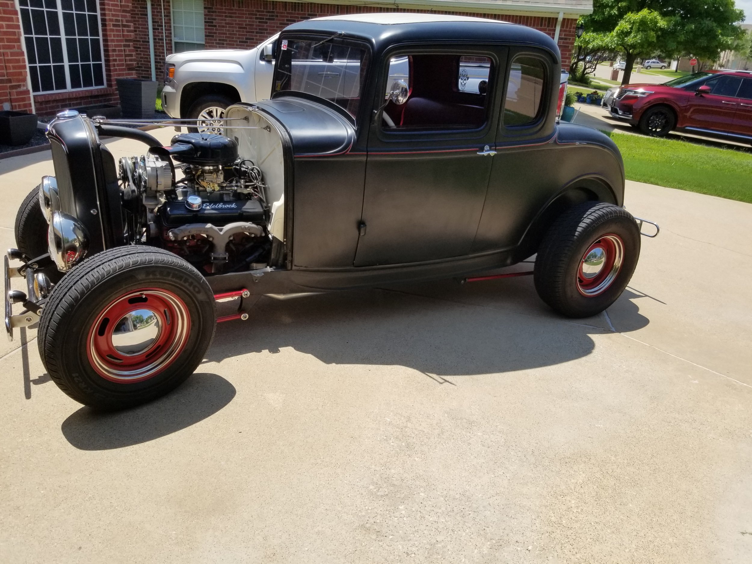

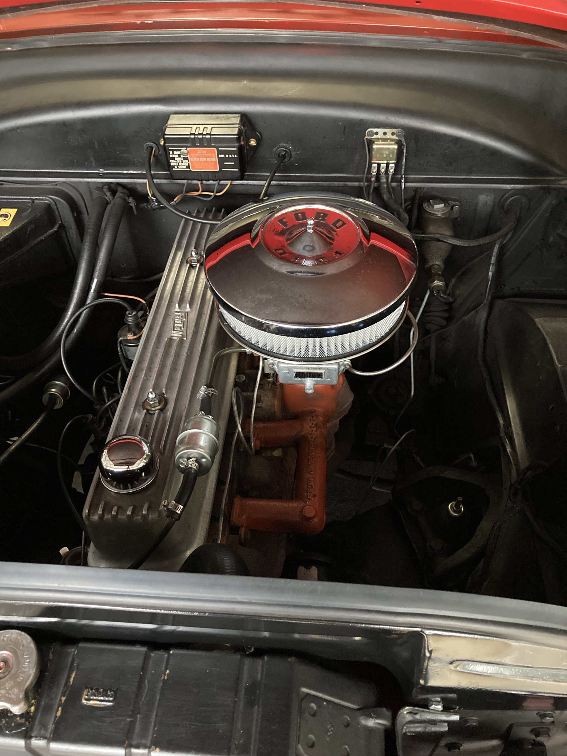

  3. Not sure what you're asking but here's what I'm running on my 53 IMG_2023-08-11-17-13-16-120.jpg

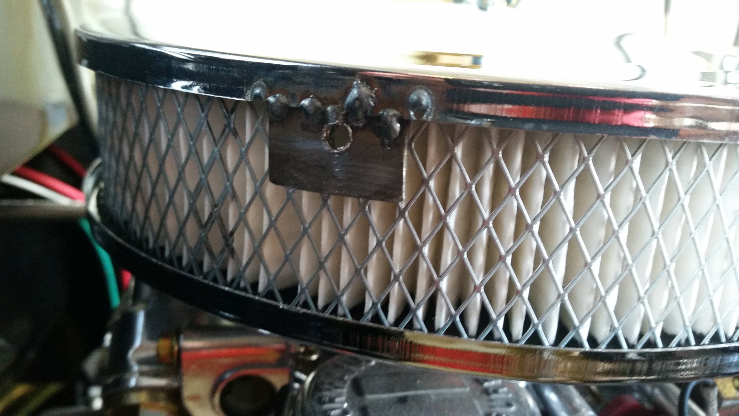

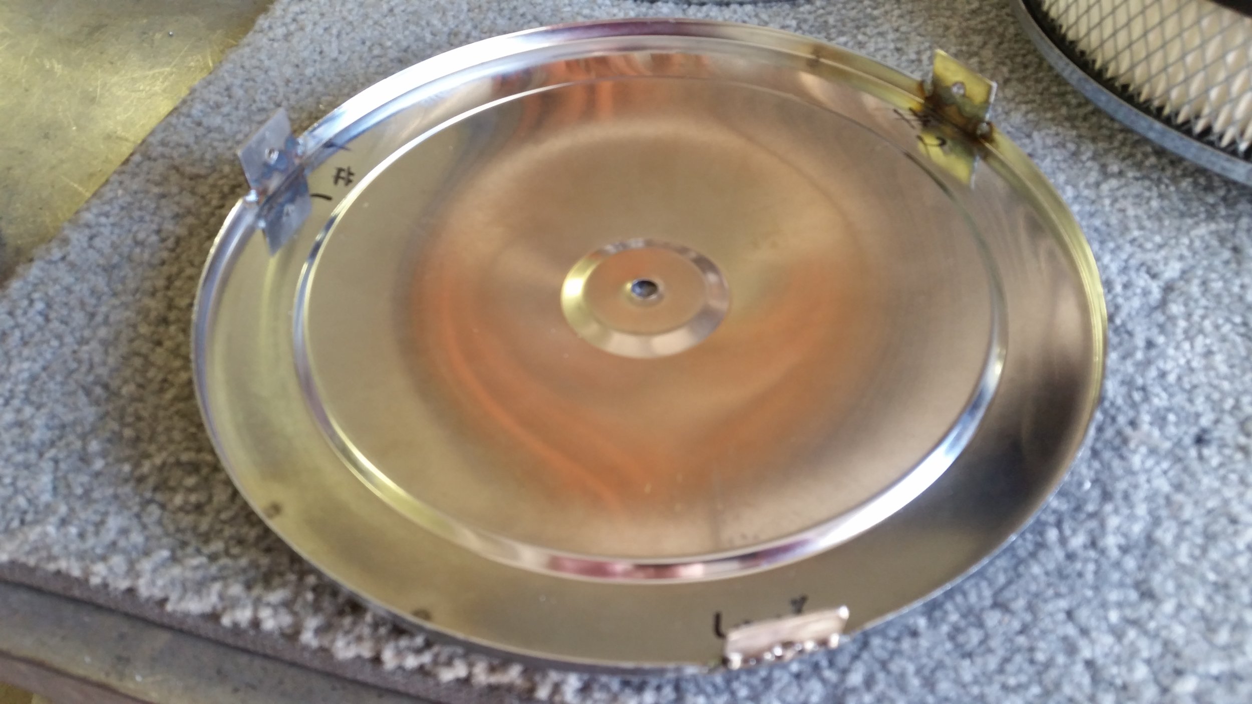

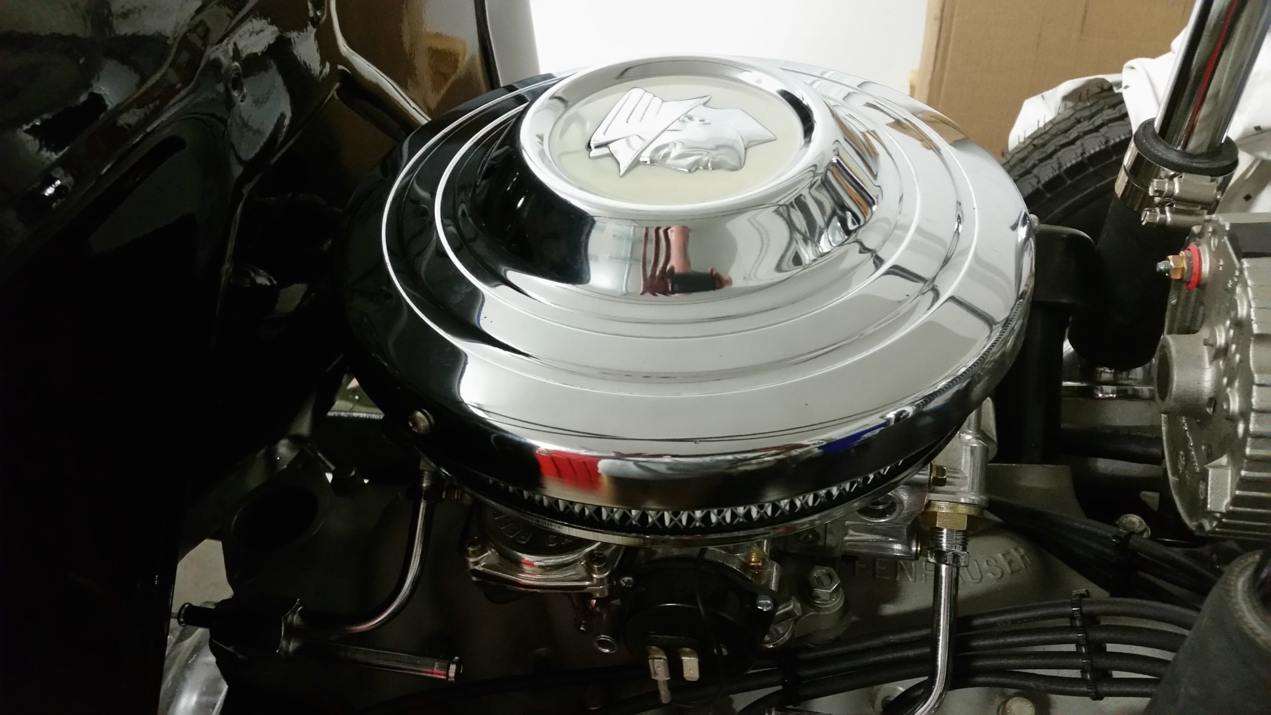

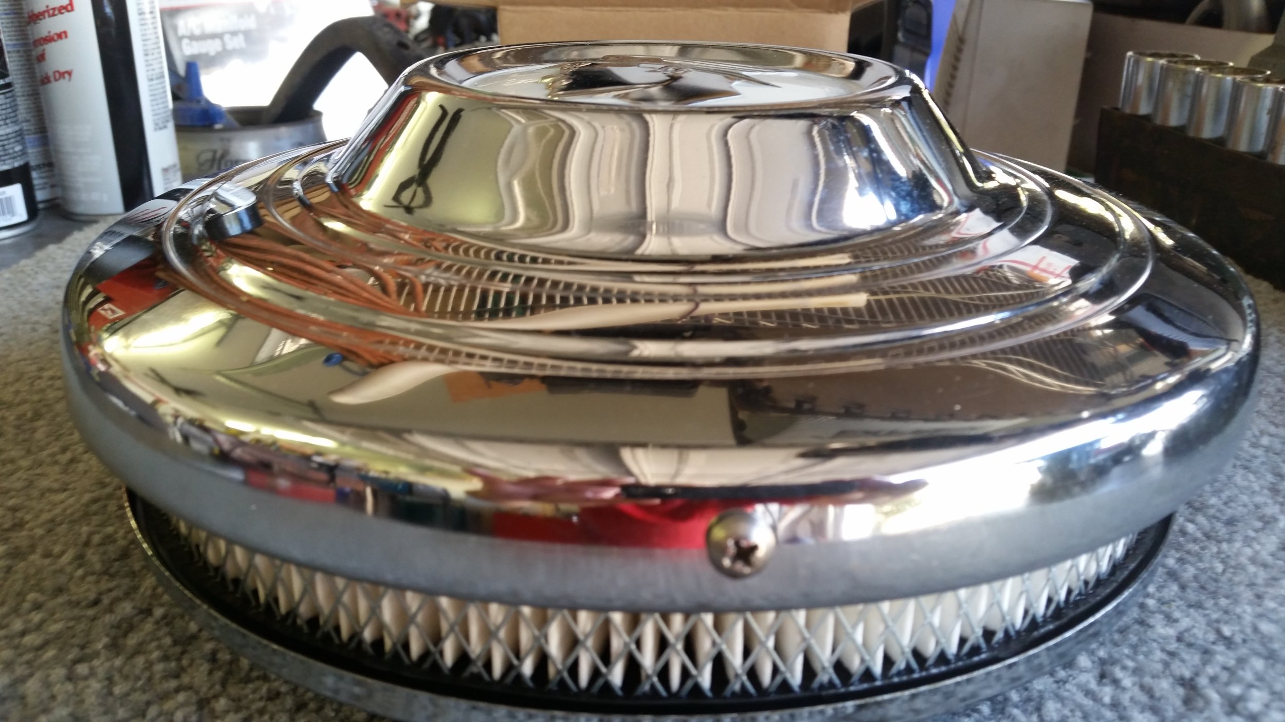

    I dug around a little and found some pics of it. . I forgot I actually used the top that came with it. Just welded some tabs on the original cover and drilled and tapped some holes in the tabs and then screwed the Merc cover to it. This might not fit your situation but might give you some ideas 20170224_114113.jpg 20170223_215105.jpg

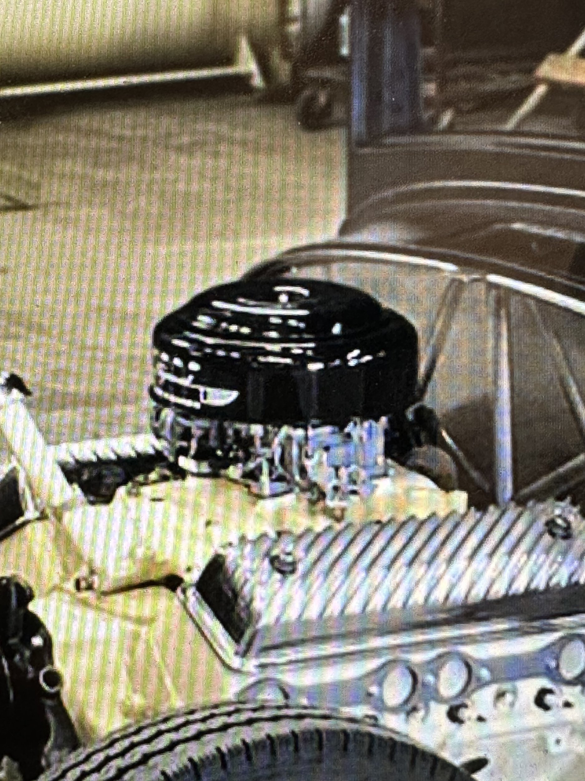

    Thanks for the photos, getting there….I like the indentation on the sides of the top of air cleaner. Personal preference. This photo is what started my idea, not a flathead tho. IMG_8769.jpeg

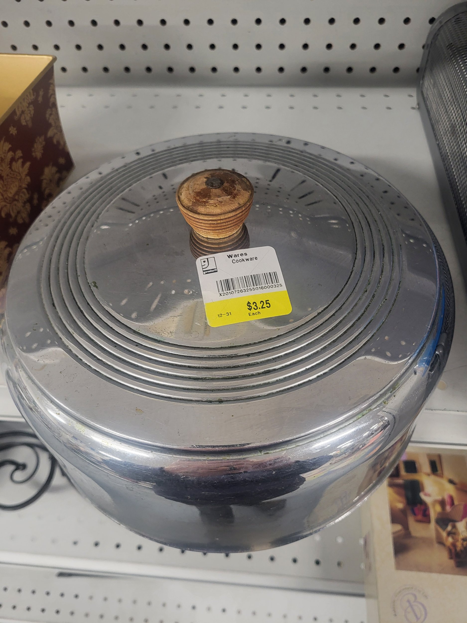

  7. I don't have any pictures, but I made one out of an old stainless cake cover. They pop up from time to time at yard sales and Goodwill stores. Some have nice designs. I had to stack a couple of filter elements to make it fit. Gene.

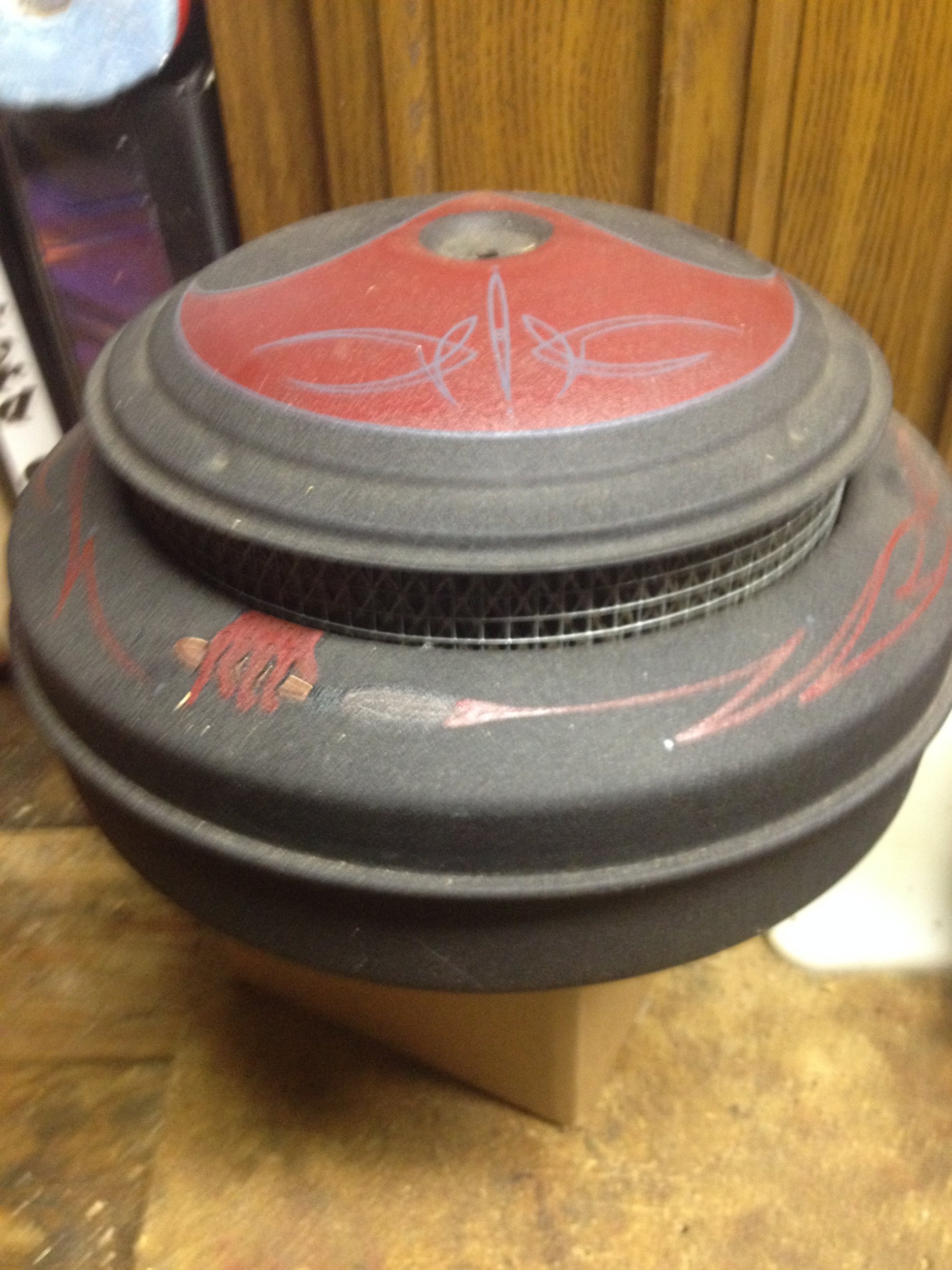

    Here’s a few I’ve built, striping by others.
    Would consider selling. Both for 4bbl paper elements in each

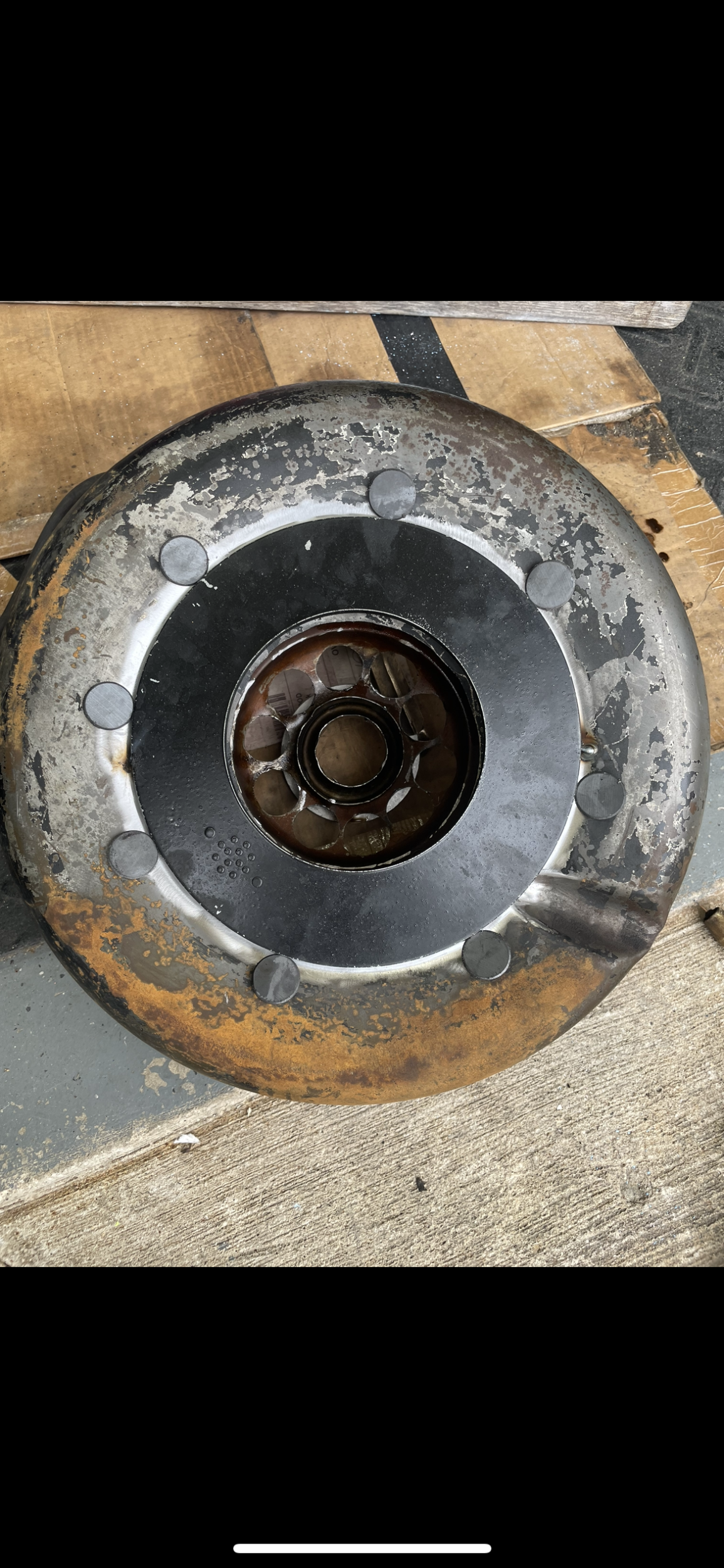

    I cut the bottom out of my 2 barrel 55 Buick oil bath and welded a cheap 4 barrel air filter base to it. Still functions as an oil bath as I have it but could be further modified to fit a paper element Works good enough for what I needed and it helps to slightly hide the modern edelbrock carb. IMG_9873.png IMG_9875.png

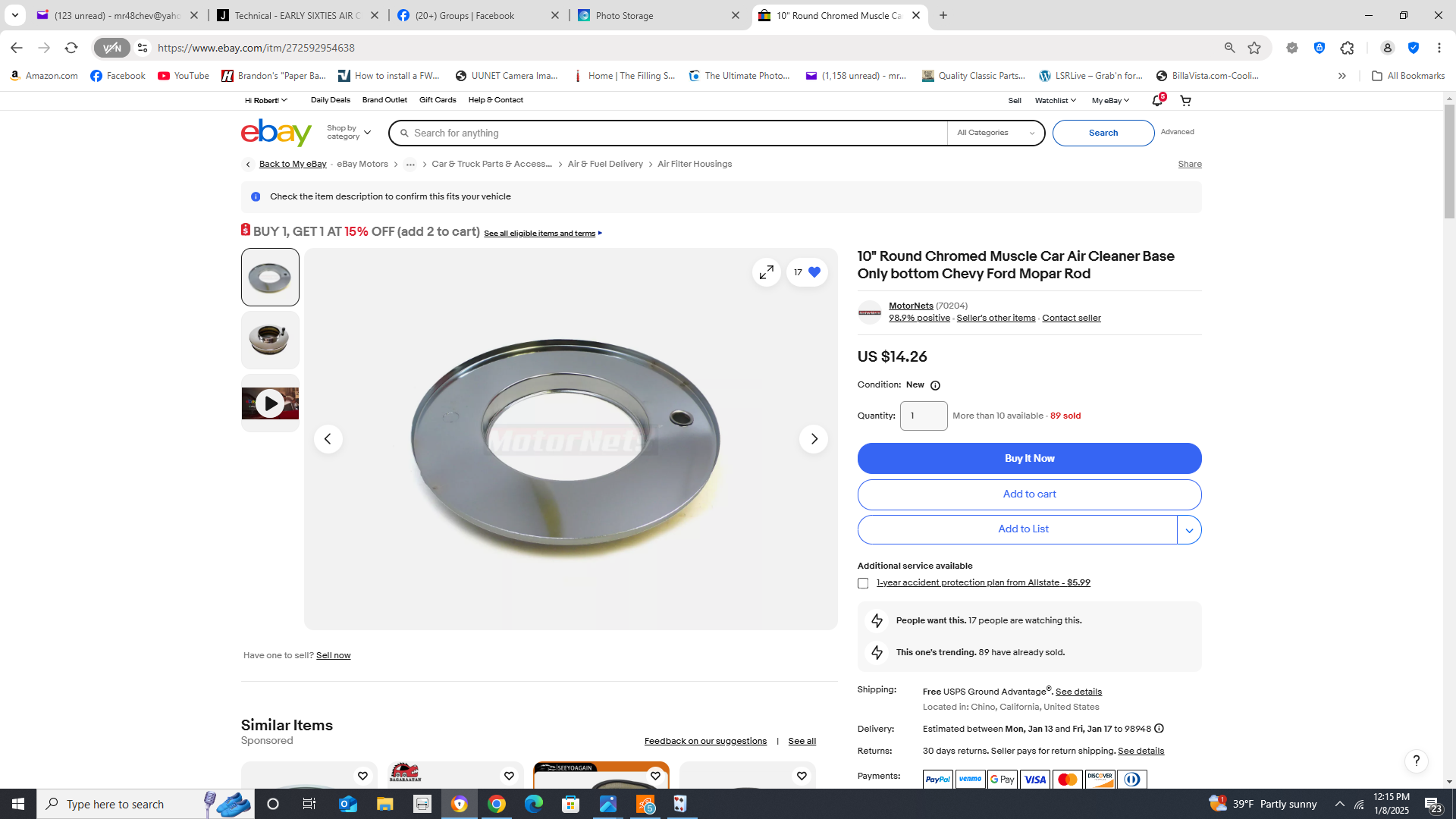

    I keep this 10 inch air cleaner base on my Ebay watch list to fit either the Cad air cleaner or something else that I might want to convert. Screenshot (1874).png

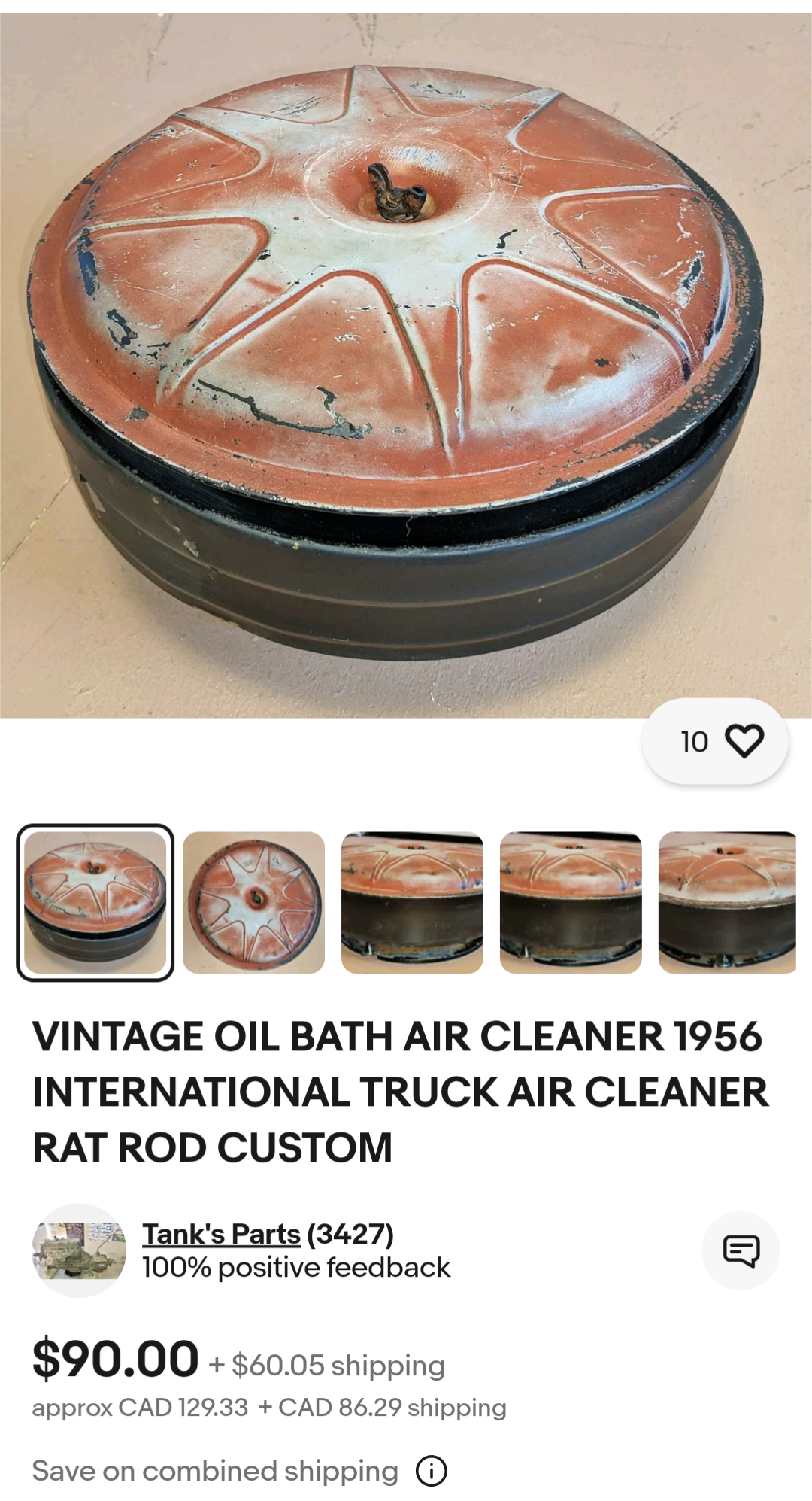

    I thought this one was cool. Currently on eBay.

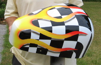

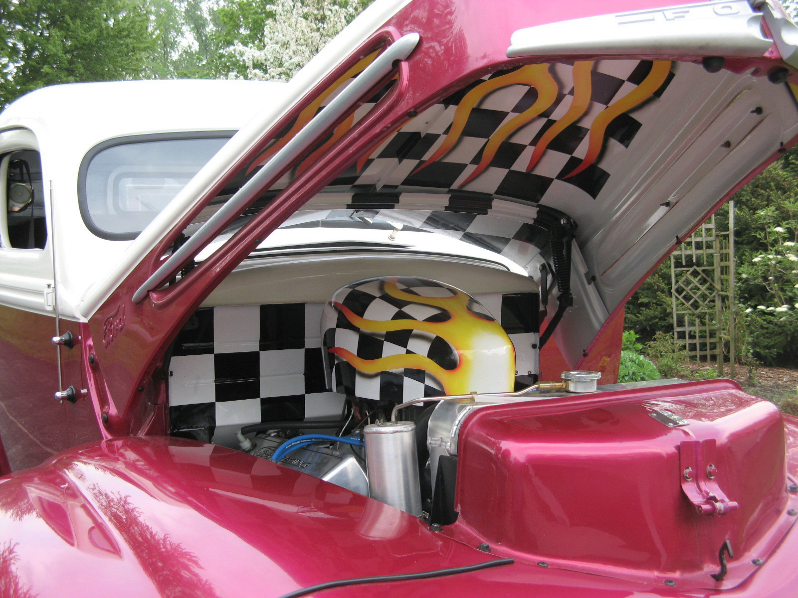

    A motorcycle gas tank? Outside the box...

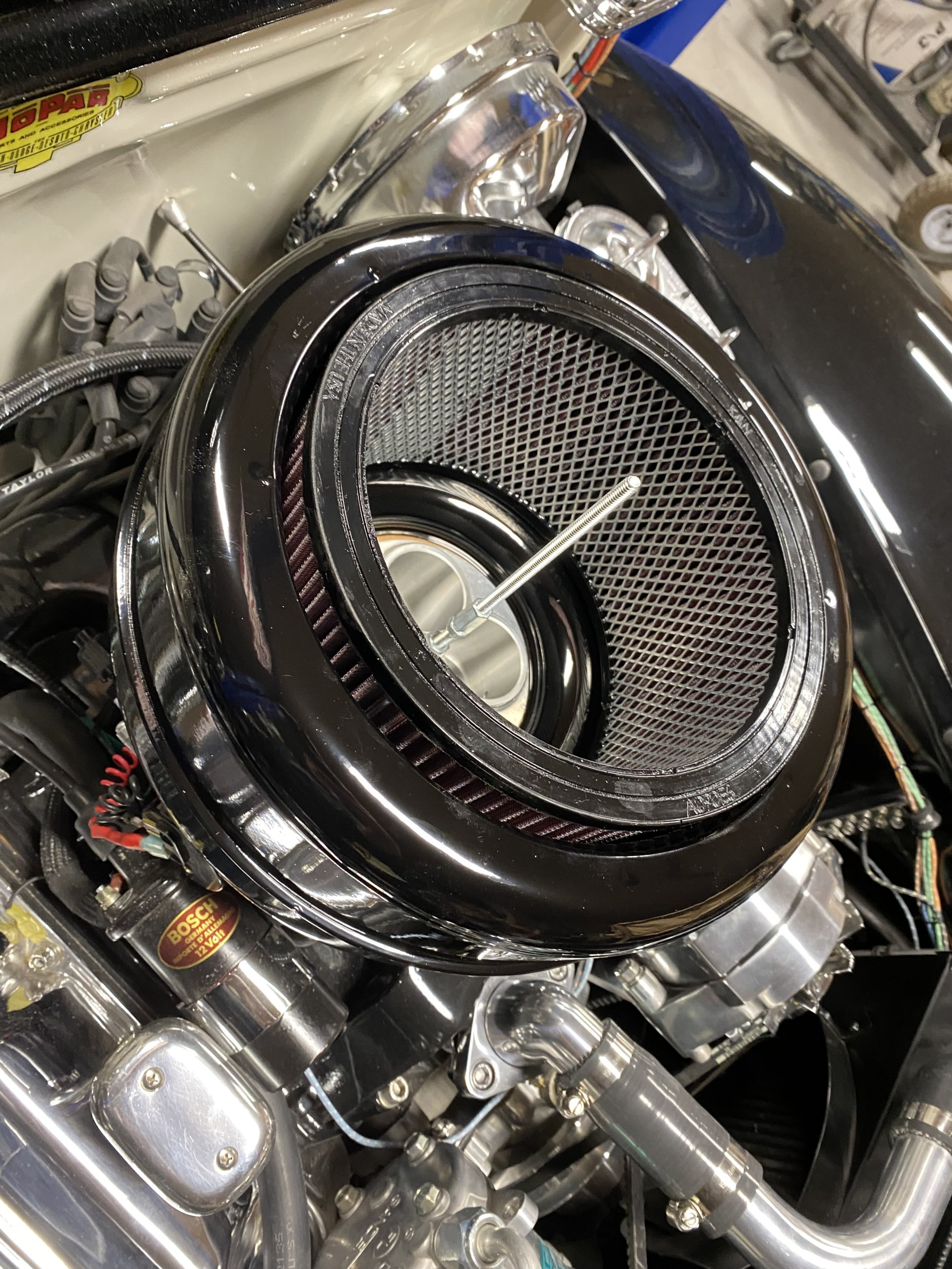

    IMG_2987.jpeg I don’t think most people would know it’s not an air cleaner, I think it could be very cool.

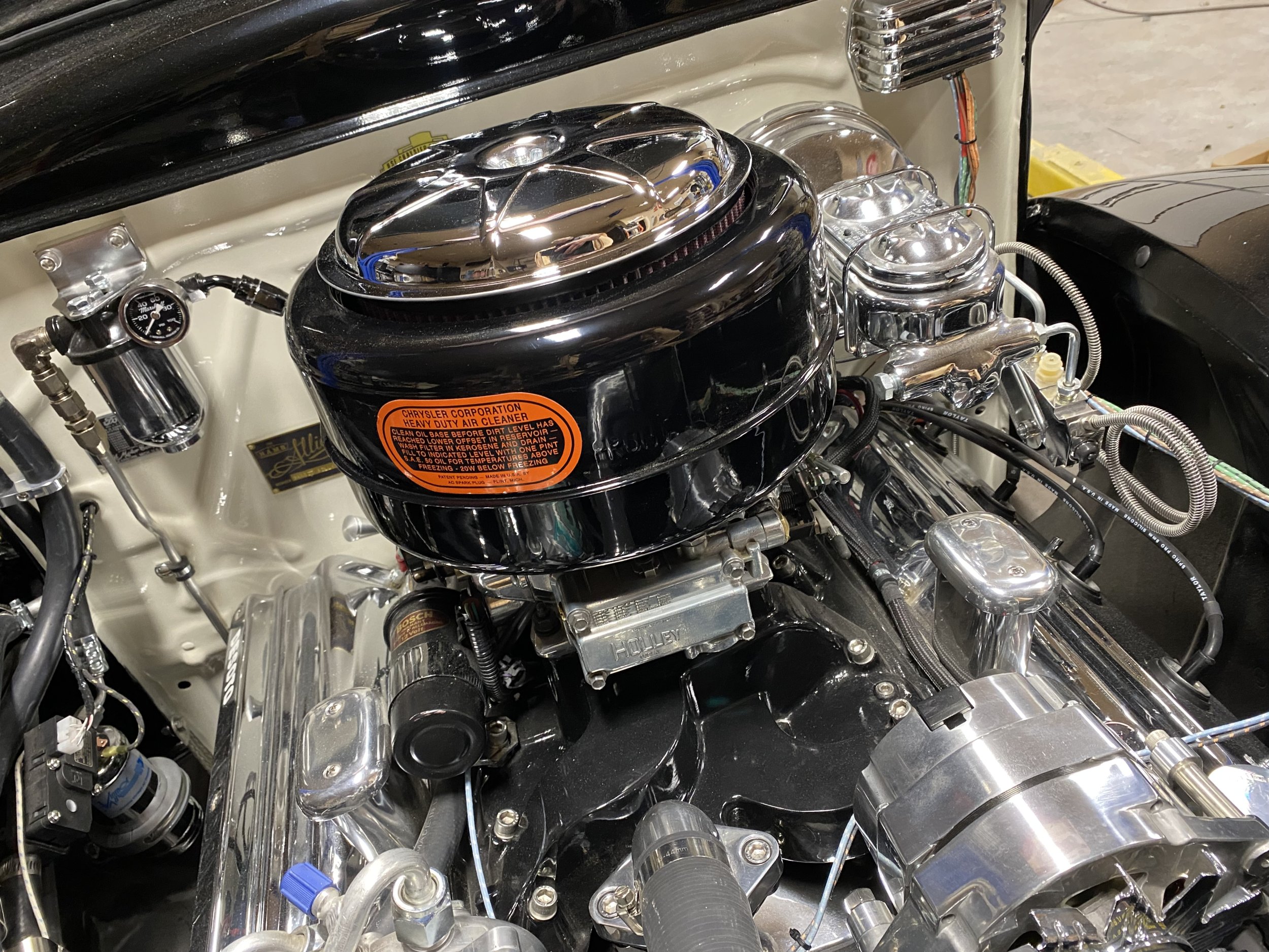

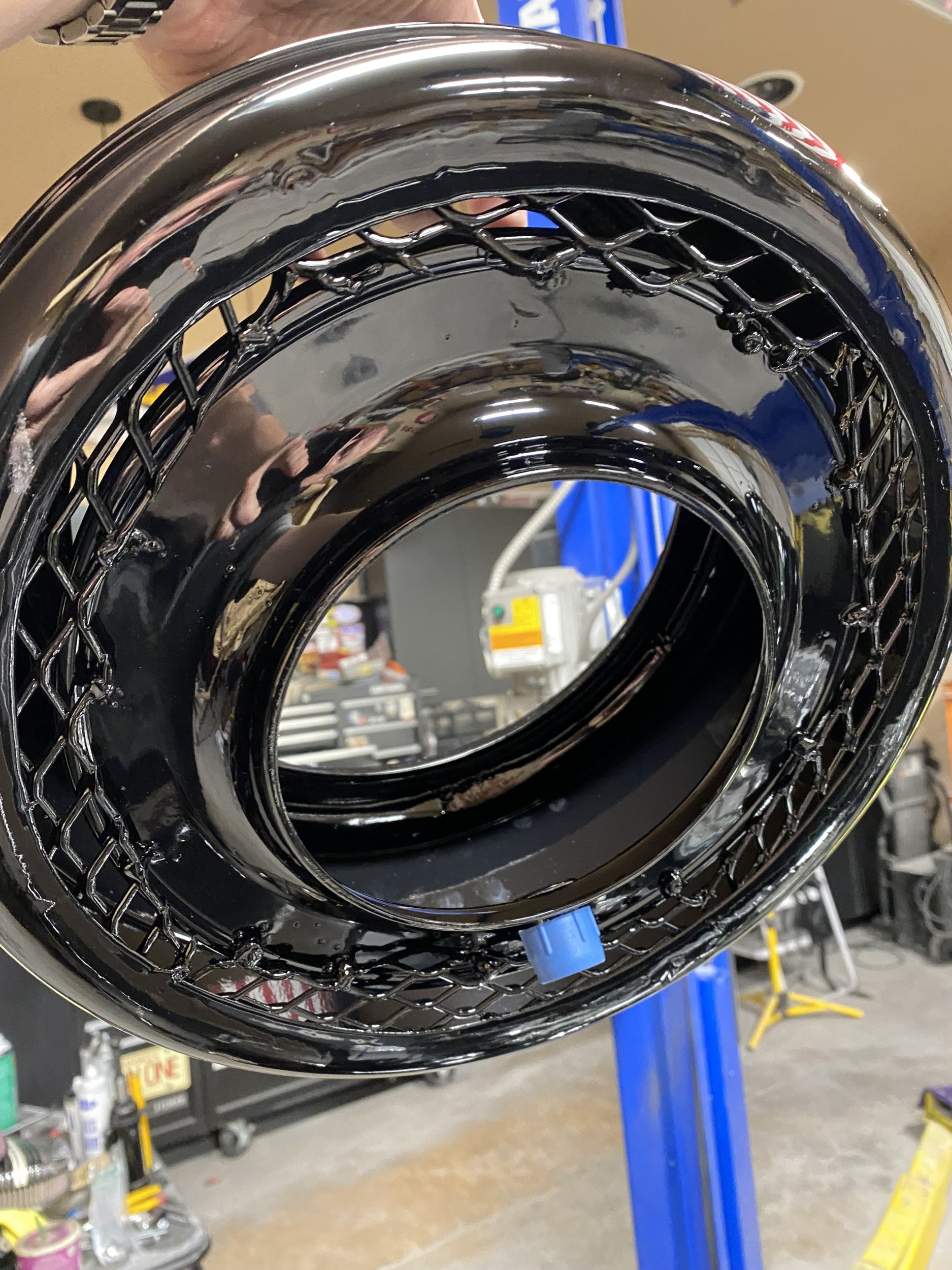

    I bought an oil bath off a Desoto to match my engine. Bought a air cleaner from summit with a 4bbl base that came with a washable element the height I required, welded them together using metal mesh on the bottom for more air flow, powder coated the body, chrome the lid (that I freed from the oil bath), put a sticker on it and done.
