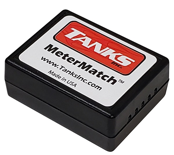

    I picked up the little GEM from fleetside66 and with some checking around I'm told it's 125ohm empty and 10 ohm full rated gauge. Does anyone have any info on the SW gauge? Looking high and low for a sender that's compatible. The closest I have found is Toyota FJ40 from the 70s with 135ohm empty and 10-17 ohm full. Been reading about the "TANKS" meter match device for mis matched gauges/senders. thumbnail - 2023-02-07T211710.270.jpg thumbnail - 2023-02-07T211715.122.jpg

    I went to the Dolphin website, and they do not show the fuel sender converter... that raises a red flag to me as why there is only one company I can find online sells the Dolphin converter. Both Ebay and Amazon are the same seller.

    "Tanks" has a converter called meter match that I'm serious about trying.

  14. Yes, it had a S/W stage 3 fuel gauge in it and now has an NOS Ford gauge. It has a function to set it up if you know the ohm readings for both the sender and gauge. Main reason I went with the Autometer one over the Tanks one is "Configurable option with linear adjustments at 5 points (F, ¾, ½, ¼, & E)". You can dial it in to hit the marks on your gauge, it will go through after you set the ohm readings for both (gauge and sender).
