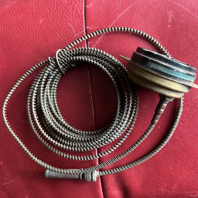

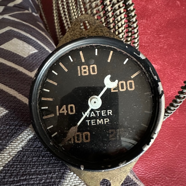

    I stumbled upon this one recently, which came from France. It's a 2-3/8" & appears N.O.S., as it has the wires crimped around the line (which was probably never unwound). The seller had a lot of WWII stuff, so I'm sure it was some military spare. It also has the gold paint on the needle, etc. I always ***umed that stuff has some low light reflectivity or something of that nature, perhaps in the period the blackout lights were utilized? It does not seem to glow in the dark at all. Does anyone know? You see a lot of war & post war Stewart-Warner gauges like that.

    Greg it’s radium, it was used for glow in the dark paint. I’m pretty sure the radioactivity is gone by now, but then again maybe that’s what’s wrong with me I’ve worked on a lot of them. o_O:rolleyes::eek::confused:

    Thanks, Rusty. I think the real danger is for those that originally painted it on, day after day on the job. I've never seen one that actually glowed, including the above mentioned temp, which is why I wasn't sure what the gold paint was.

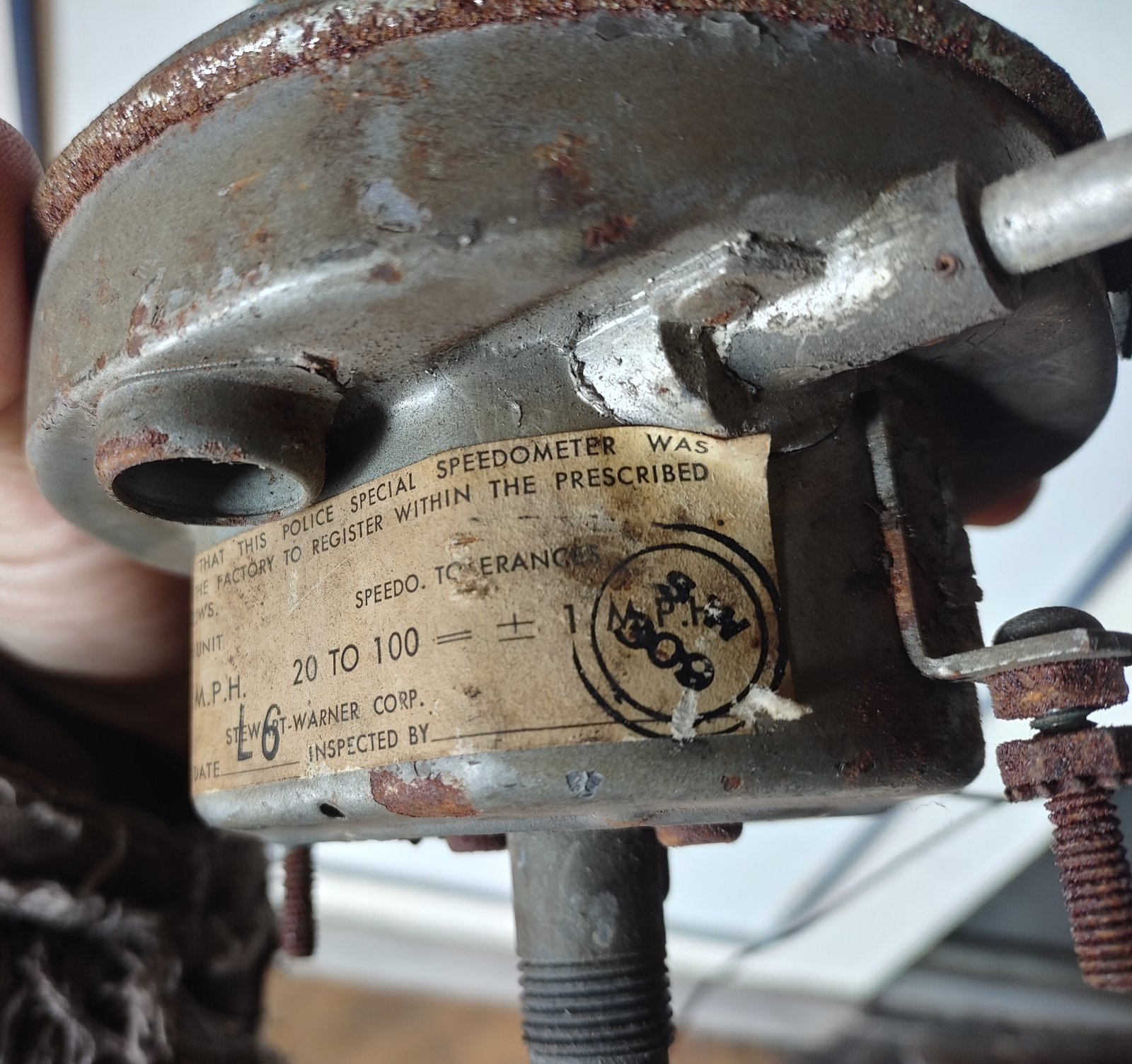

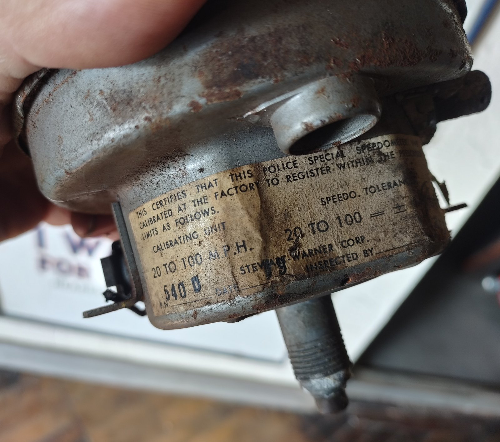

    I kind of inherited these SW Police speedos this week and was wondering what era they're from and can we confirm that these are from a car and not a motorcycle? I saw some extremely similar ones that said Harley Davidson on them but these came from a guy who wouldn't have had anything to do with motorcycles so I have to believe they're from squad cars. Back side looks like it takes a regular speedo cable, I can take a pic if need be.
    Okie Pete, stillrunners and Just Gary like this.
  21. alchemy
    Joined: Sep 27, 2002
    Posts: 22,777
    alchemy
    Is there a ratio tag or stamp on the back?

    Squablow
    There is (I don't know why I didn't take pics of these to start with) there's one on the one with the bracket too but it's kind of obliterated.

    I think those look motorcycle-ish. What is the OD of the bezel?

    The 540D speedometer is listed as Police trade for general use with a speed unit listed highlighted in yellow 435705 which matches the same speed unit used on Harley Davidson.
    Which is different from the speedometer speed unit used on the 540T Ford Police speedometer which is 435703 (1:1 1000 cable revolutions per mile) so to me it would indicate it’s for a motorcycle. Your results may very ;). There were some motor cycle speedometers that were 1:1 but not many, but you can see Harley speedometers that matched the Ford speed unit those would be 1:1. Ok so now I see that it has a marching speed unit to the Chevrolet, which just blows my theory out of the water. So it does seem to be 1:1. Sorry I just made this more confusing.

    The cable connection is not a female thread like the automotive kind were, so I also say they are motorcycle.

    Overall diameter is 4 3/4 but they look like they were made to fit in a 4 3/8" hole. If they are 1-1 ratio, could a cable be made to use these in cars, or would that be futile? They belonged to a good friend of mine who died, would be cool to use one but I don't do motorcycles so if they can't be used in a car they're just going to be shelf-fillers.
