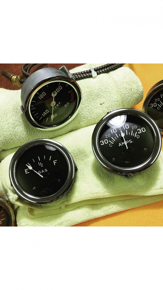

    Hey guys, I forget about this place sometimes.
    Here's some pictures of my bezels people have bought and installed. Also I'll post a price list.

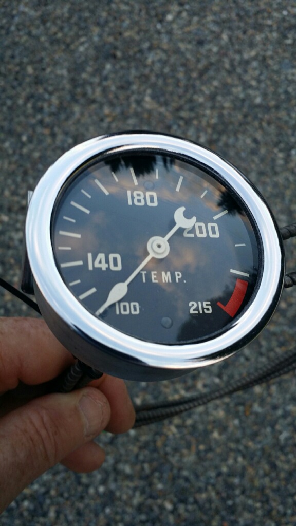

    I bought this original 1940's Stewart Warner 2 5/8" Temp Gauge last year. (smooth bezel, curved gl***, crescent needle, front mount) I recently sent the gauge in for a rebuild/repair. I arrived home from work with a pleasant surprise as it had been delivered.
    Work performed: New capillary tube/gas, calibration, oiled the needle, reset the needle stop and re-meshed the pinion gears. Cleaned the face of the gauge and inside gl***. Now that its rebuilt and calibrated/accurate I couldn't be more pleased!
    I also have a 1940's New Old Stock Stewart Warner light kit for it, too!

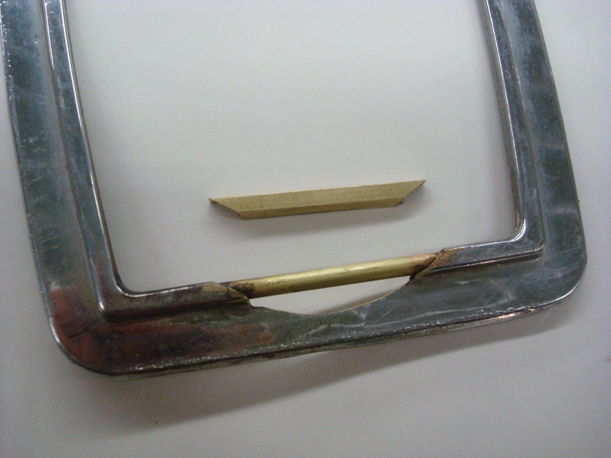

    thumbnail (1).jpg Here is a panel I restored after buying it from ***us... thumbnail (96).jpg DSC09835.JPG DSC09840.JPG thumbnail (94).jpg

    Greg, that work on that broken panel is amazing. That framework is pretty complex & delicate & to pull that off the way you did is a real fete. I recently did a similar reclamation project on a similar panel where I had a good framework & insert, but no matching backer plate. I had one CNC'ed & re-established all of the gauge & panel mounting studs. Another one saved!
