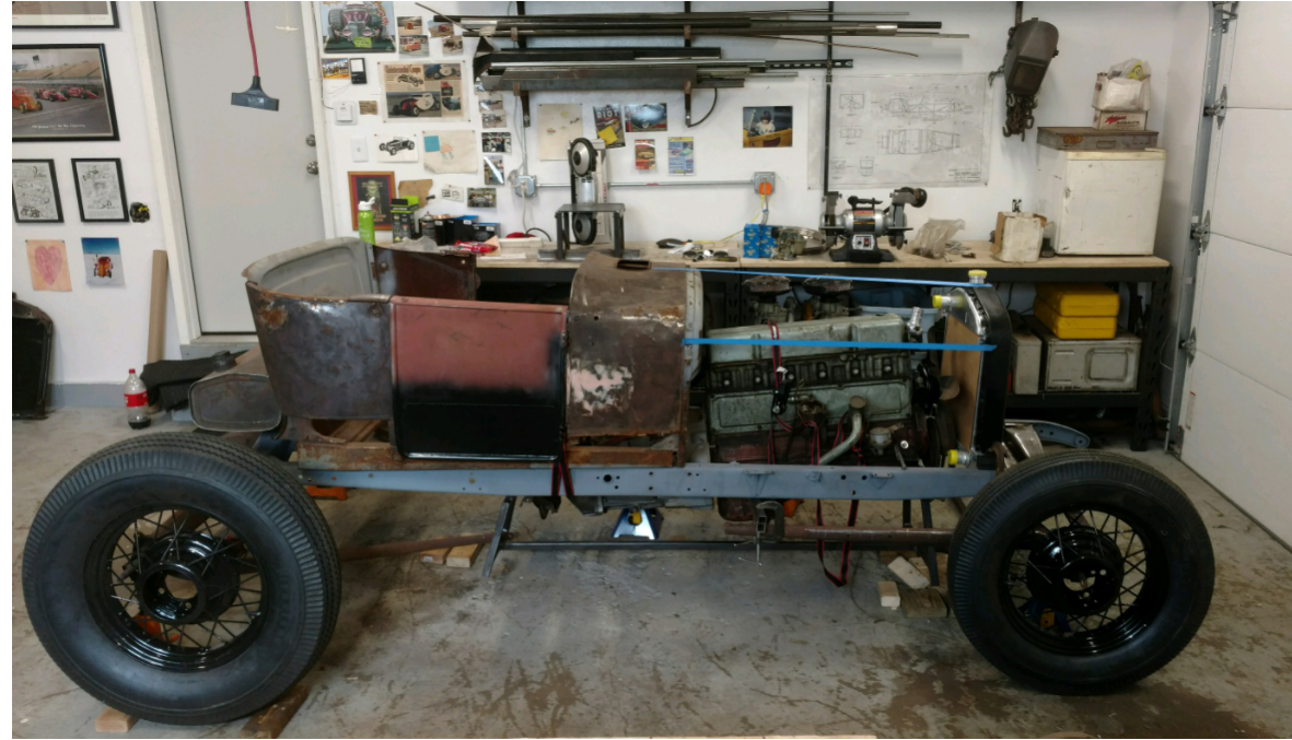

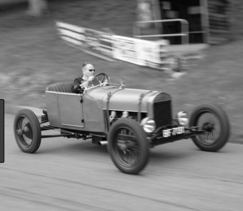

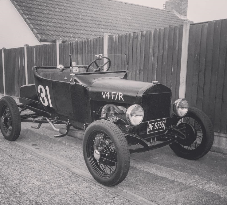

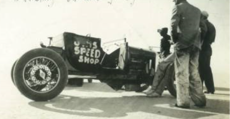

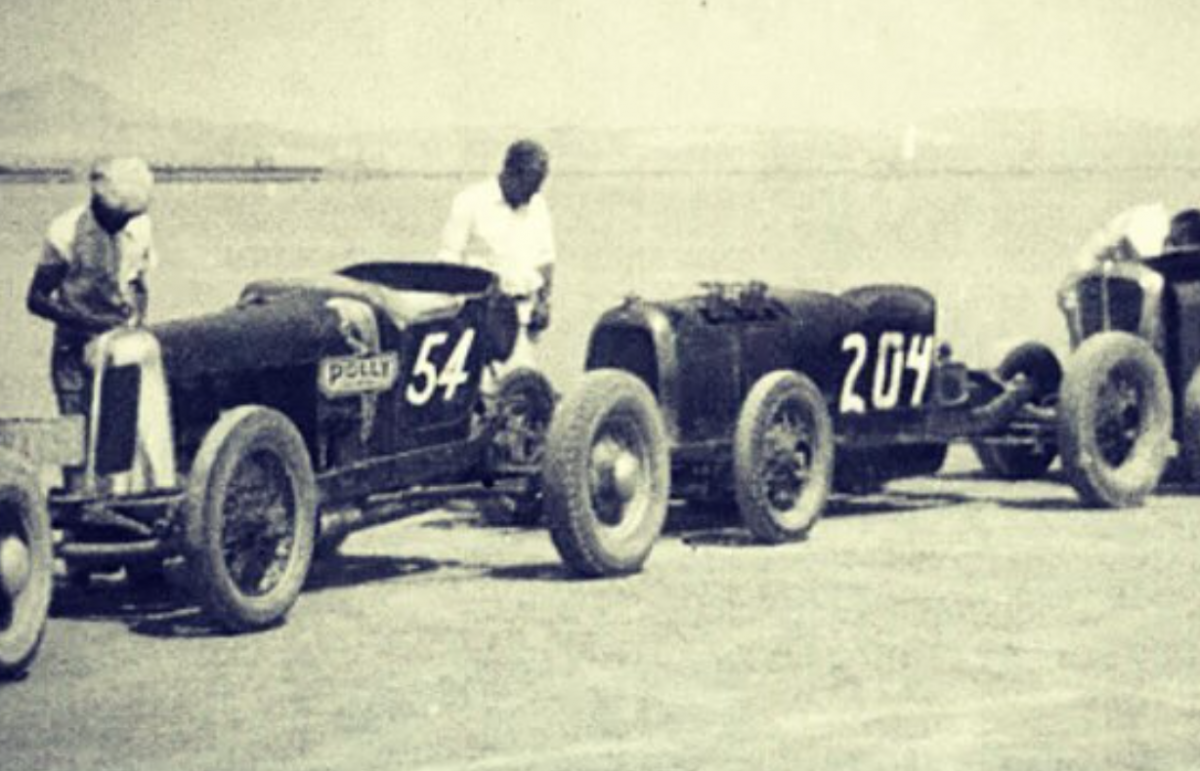

    So, I suppose this will become a build thread. This week I've just mocked it up. Its sitting with the weight on the springs, so its established the ride height. I've tack welded the '35 front crossmember in, split the front wishbone and bent the spring perches. I'm running the rear spring in front of the axle, so mocked it up by turning the banjo round. No smart-**** comments about it pointing the wrong way! I like the rear axle tucked up against the back of the tub, so the frame will need to shortened to allow that. The back wheel is where it will end up.

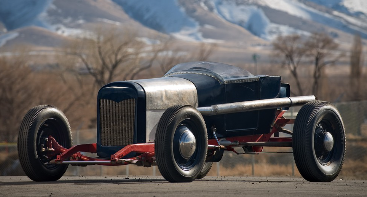

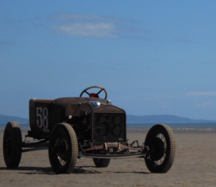

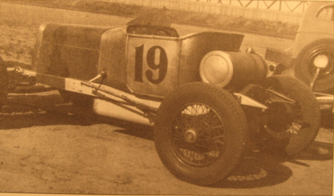

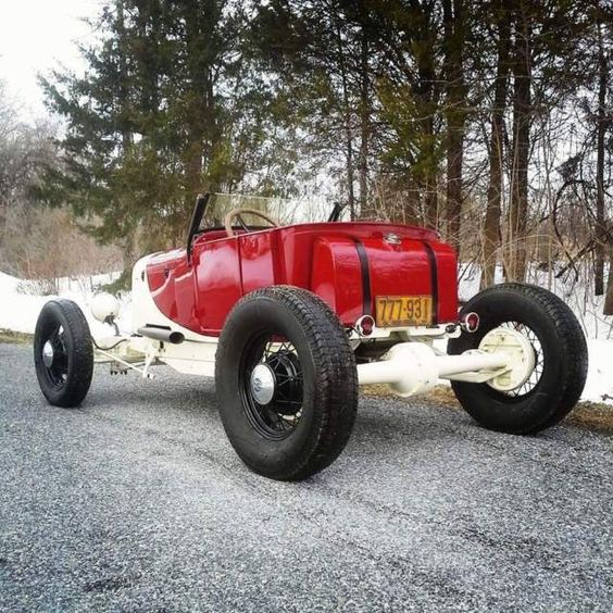

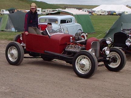

    I toyed with the idea of narrowing the body to make a true one man modified, but settled on a stock width body so Lisa can ride along with. bfhdmxhdfratq.PNG ytjsnsvcbsgdywt.PNG whfkcmvnlpadsr.PNG hgkldopemckdienvu.PNG ouilsnvhryrie.PNG qwerfdsaqwer.PNG mnbvcxzxcvbnm.PNG olkiolkio.PNG poiuyghjkl.PNG gtrfderfd.PNG 661628-Cardy.jpg ce739b1c43c8118c12bb94aa343ef6b8.jpg
    So some pictures. One of mine mocked up, and others of cars I used for inspiration.

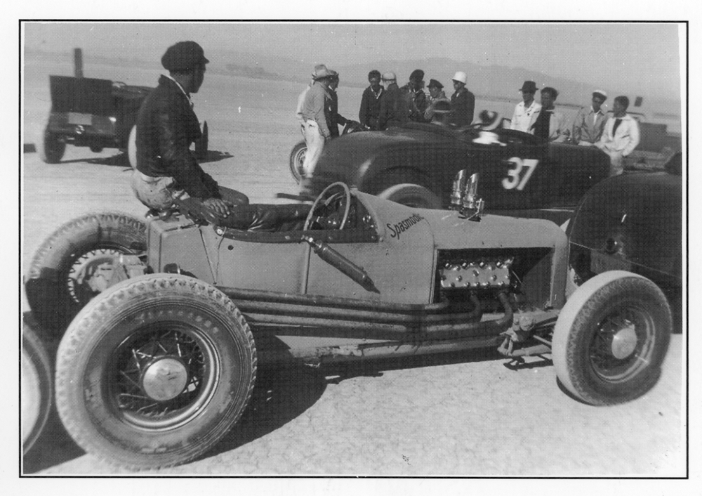

    53253925_10216699431831146_4689704850978504704_n.jpg Nice project! I'm adding this photo that was on the Photos From The Past thread a few days ago. The finish on the kickups on the #19 you posted look great, may copy the look on my Bobtail project. Bob

    The rear frame horns on the #19 car, are so graceful, a bit out of line with most modifieds of the era, which were more about all out speed than looking pretty.

    Chappy444, Yes I have pictures of that car too. I thought Clark and his crew built that though.

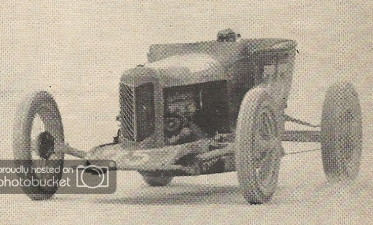

    Sure looks the same. Even the wishbone brackets.

    You are correct, Clark did build that car, and he is a member here. @Clark
    He probably won't respond to this post as I suspect he is thrashing on a car for Jaloparama.

    I decided I wanted to use a "35 front suspension. Its a bit lower than a '28-'34, but keeps the narrower perch pin distance. This becomes a factor when the 'bones are split and moved out to the frame, as the tyres can rub on the 'bones with the later axles.
    The problem with using the '35 suspension is the front spring is wider, so the front crossmember needs modifying. I chose to cut down and narrow a"35 front crossmember. Whilst doing that, I narrowed the frame rail width to match the T grille shell better. The crossmember is set at 6 degrees from level with all the weight on the springs.
    Next came engine mounts. I wanted the mounts simple and clean. I like rounded corners so used a piece of box cut down to make the upright. This upright spans the open side of the frame rail as I'm not boxing the rails. Can't make my mind up if I'm going to put lightening holes in them yet. thumbnail_IMG_20190305_103043893.jpg thumbnail_IMG_20190307_094619041.jpg thumbnail_IMG_20190307_100623814.jpg
    On to the engine side mounts next.

    I started at the front replacing the Model A crossmember with one from a '35. This moved the front axle back 4 1/2". I then moved the grille/radiator back 5" behind the axle line. Then I pushed the engine up to the radiator. The body then got pushed to the back of the engine. I'm turning the rear axle bells around, which is a '42, so the spring is in front. I'm using an A rear spring. I like the rear axle pushed up to the back of the tub, so basically I moved the rear wheel up to where I liked it. I will need to cut 6" out of the frame rails at the back. I'll have to make some support arms to hold the '28 Chevy gas tank out back.

    For me it was replicating the look of early modifieds and placing some of my own aesthetic choices. I like grille shells behind the front axle line. I also like the rear axle right up against the back of the tub, with the tyres covering the side of the body a little. This leaves everything set back from the axle lines and compact within the wheelbase. I was aiming for about 100" wheelbase, and it just worked at that. I'm well pleased.
