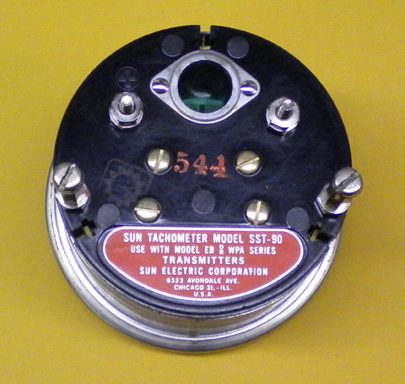

    Here's the back of a 2 piece

    so, if I test mine out according to the markings on the back of yours. I hook up the left pole to power, the right pole to the pos. side of the coil?? obviously the upper right goes to ground...

    The "dist." post should be wired to the negative side of the coil on a non-transmitter (1 piece) tach.

    thanks. if it's a 6v tach would hooking it to 12v hurt it?
  7. phat rat
    Joined: Mar 18, 2001
    Posts: 5,087
    phat rat
    yes
