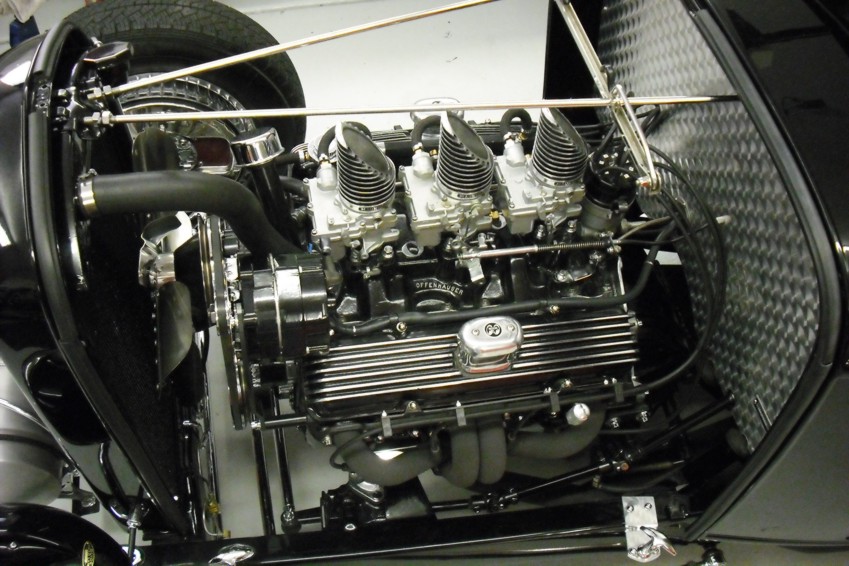

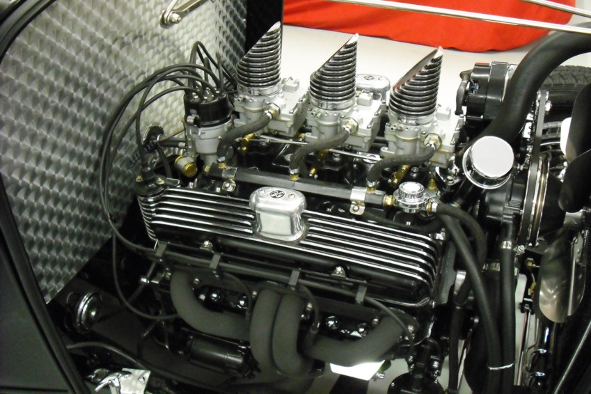

    I did mine with the Eastwood silver, comes out a nice matte silver color, has held up well for the last 5 years.
    Mick
  7. big duece
    Joined: Jul 28, 2008
    Posts: 7,044
    big duece
    from kansas
    Mick, your engine detail is "tight". Nice work.

    Wow that engine detail is done well. Thanks for the answers , I wanted that dull silver. Now I can order it
