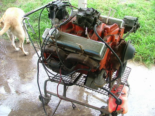

  15. 97
    Joined: May 18, 2005
    Posts: 1,983
    97
    Shopping trolley
