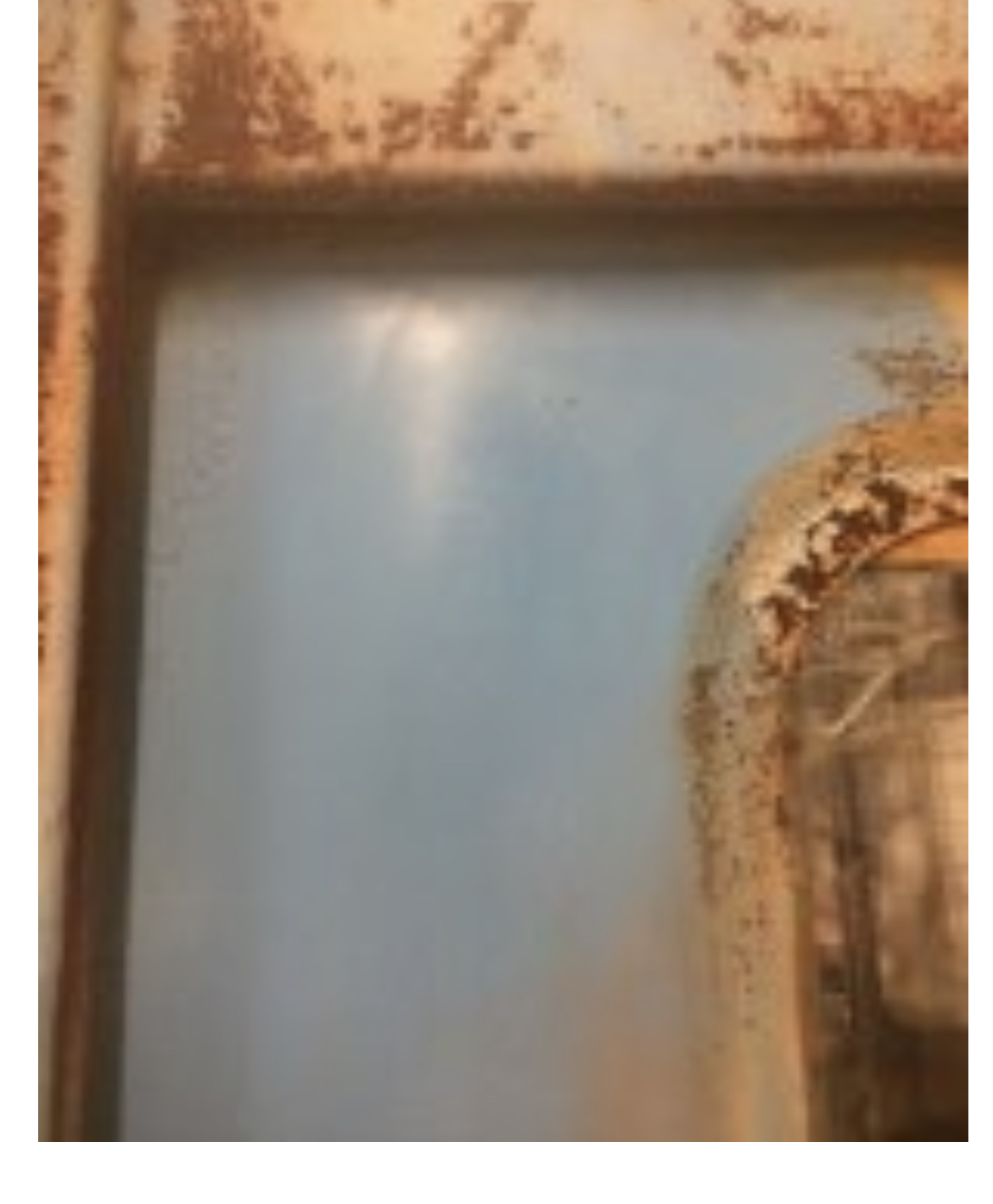

  14. CLR, 2000 grit and polishing
    Most of the ugly was rust stains the CLR removed
    The blue was hiding underneath

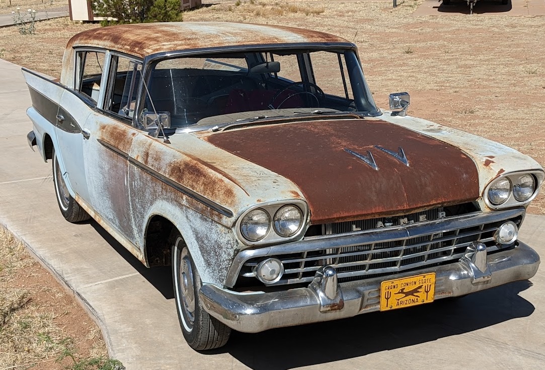

    This is great for a car that has intact paint still, over most of it. But for something with areas missing paint, with real surface rust, polishing doesn't work, and making rust shiny by polishing, using oil, clear coat, or whatever, looks very strange and unnatural.
    My Rambler has decent paint on one quarter panel that had been repaired, but the rest of the car is in bad shape, the paint is heavily cracked, and the top surface mostly has just rust remaining. There's not a smooth surface to polish. So, I just leave it alone. I clean the windows, but the rest is gonna stay dirty and ugly while I have it. If the paint were in better condition, I'd consider cleaning it up.
    It really depends on the condition of the surface. But either way, anything beyond cleaning and polishing, just looks weird. And if you're concerned about "preserving" it, just park it inside, that will stop the deterioration.

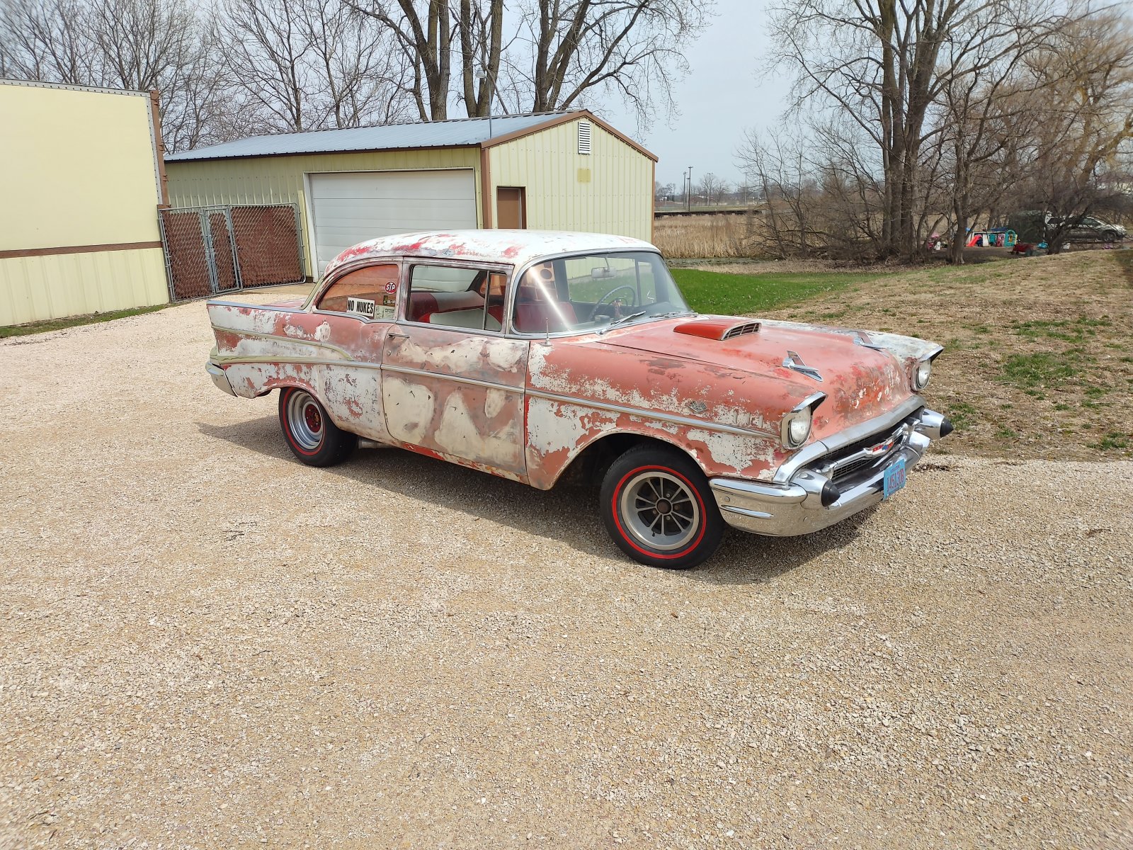

    I agree with those that say clean the surfaces however you can (buffing is great on paint, rougher areas are going to need to be scrubbed with SOS or something) and then a couple coats of wax. Leave it alone beyond that. Putting clear coat over the top looks ****y to me and isn't really keeping it from getting rustier (think about painting over rusty body panels, that doesn't stop the rust, why would clearcoat?)
    If it's so rusty that buffing and wax are pointless, then I feel like it's beyond "preserving".
    The paint on my '57 Chevy is about as ugly as they come, but the purpose of this car was low budget everyday use so it stayed. I scrubbed all the dirt and stains off, buffed whatever paint was on it, and I put wax on it every year. There's no exposed steel or rust on it really, just a lot of old paint, peeled off in some spots and sticking in other spots, and a lot of old repairs. The areas I welded or that had any bare metal got touched up to kinda/sorta match. Good enough. To add clearcoat to it would spoil the whole point of not repainting it in the first place, and a coating of sticky linseed oil isn't going to help it any more than wax will, either.

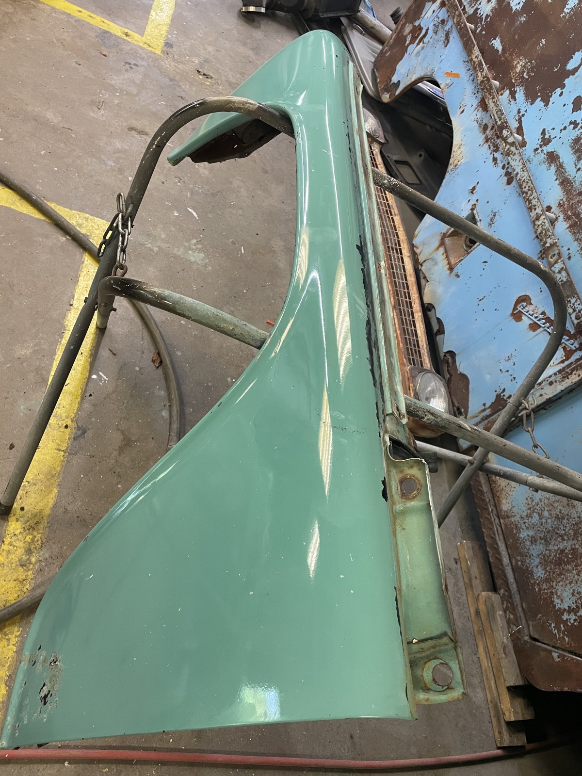

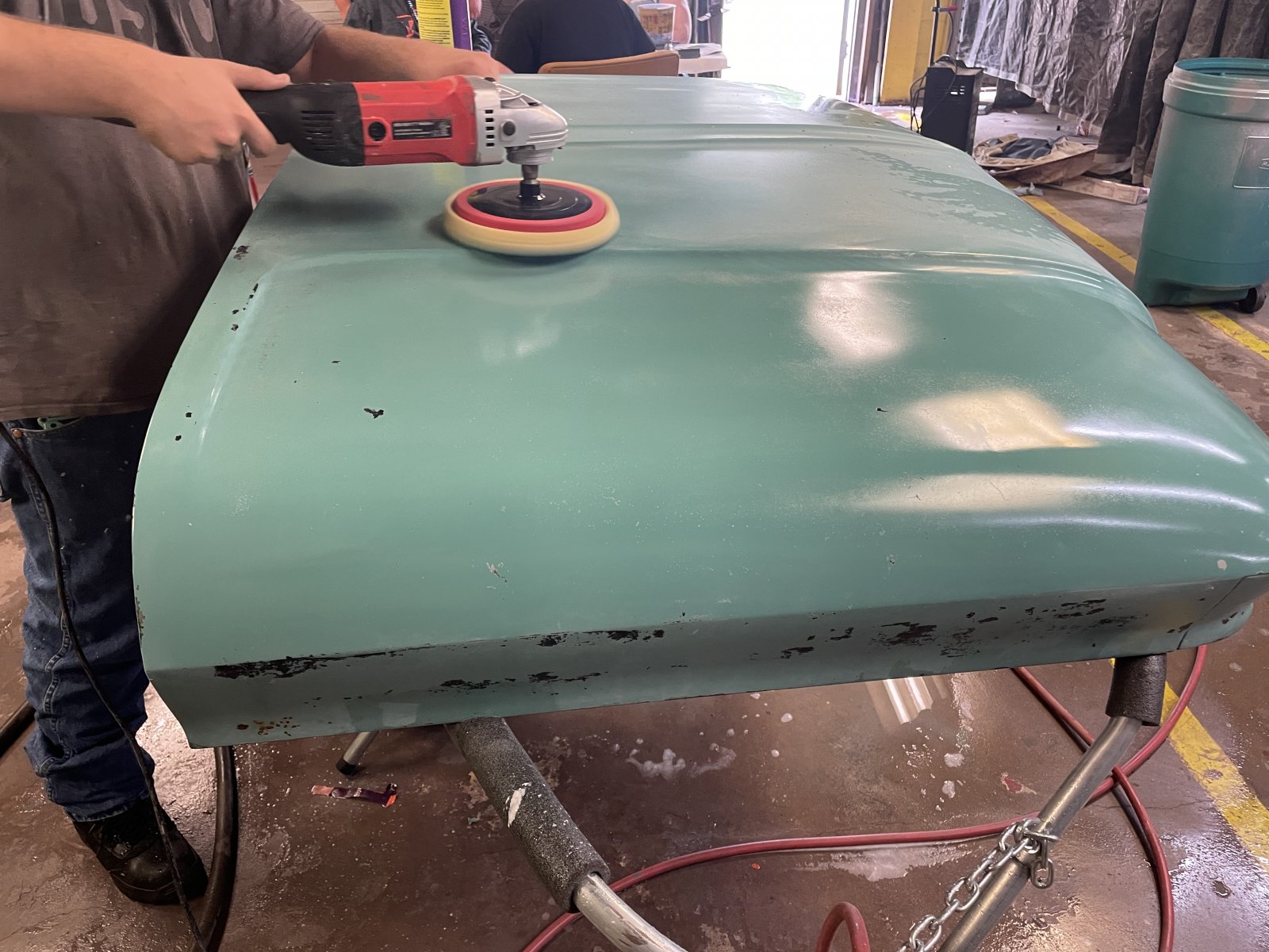

  26. Cleaned, 2000 grit, hand rubbed and back on the road
    (And we did clean the WS as well since this pic:))
    Customer (my son) was happy with the results.
