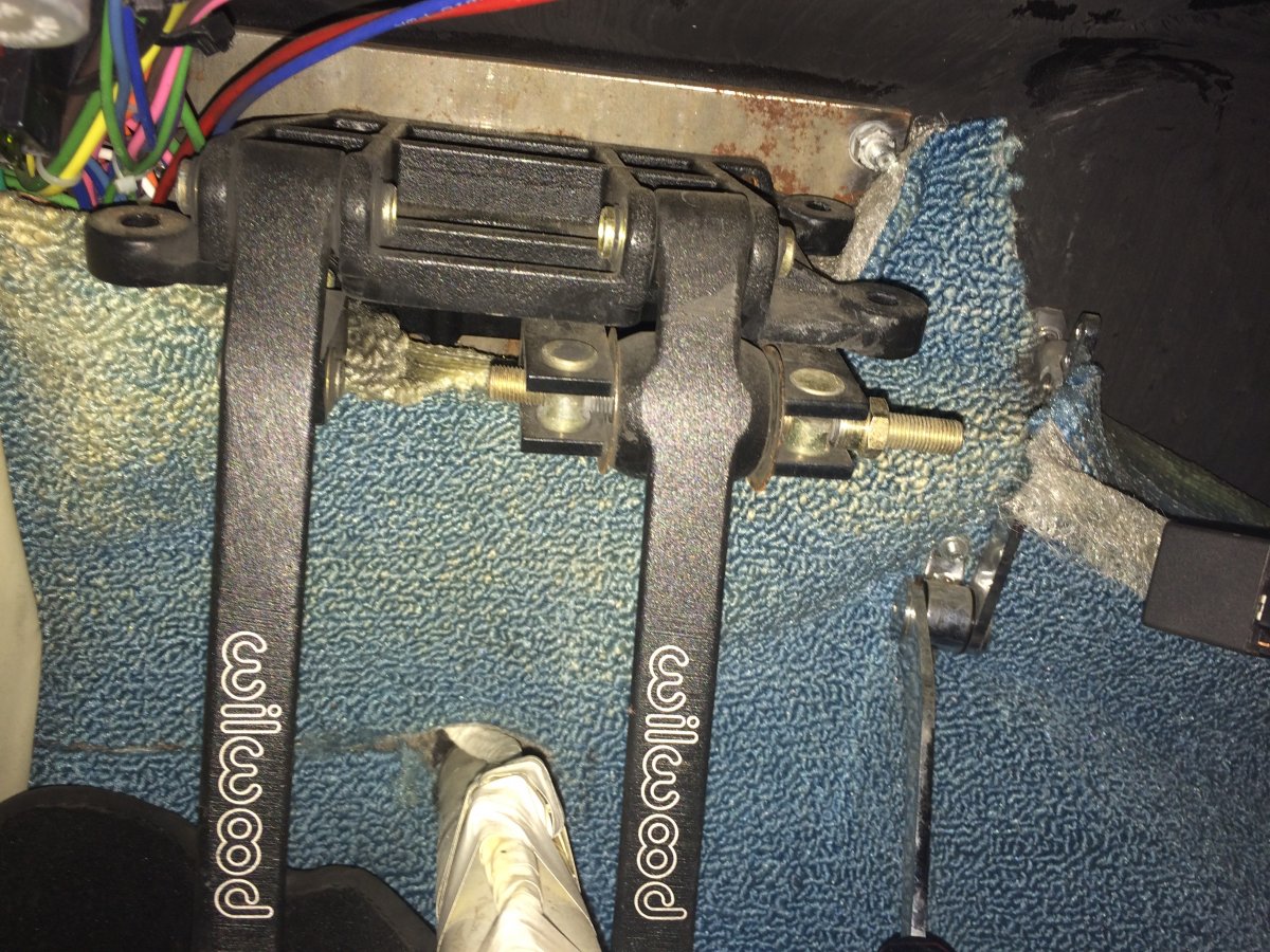

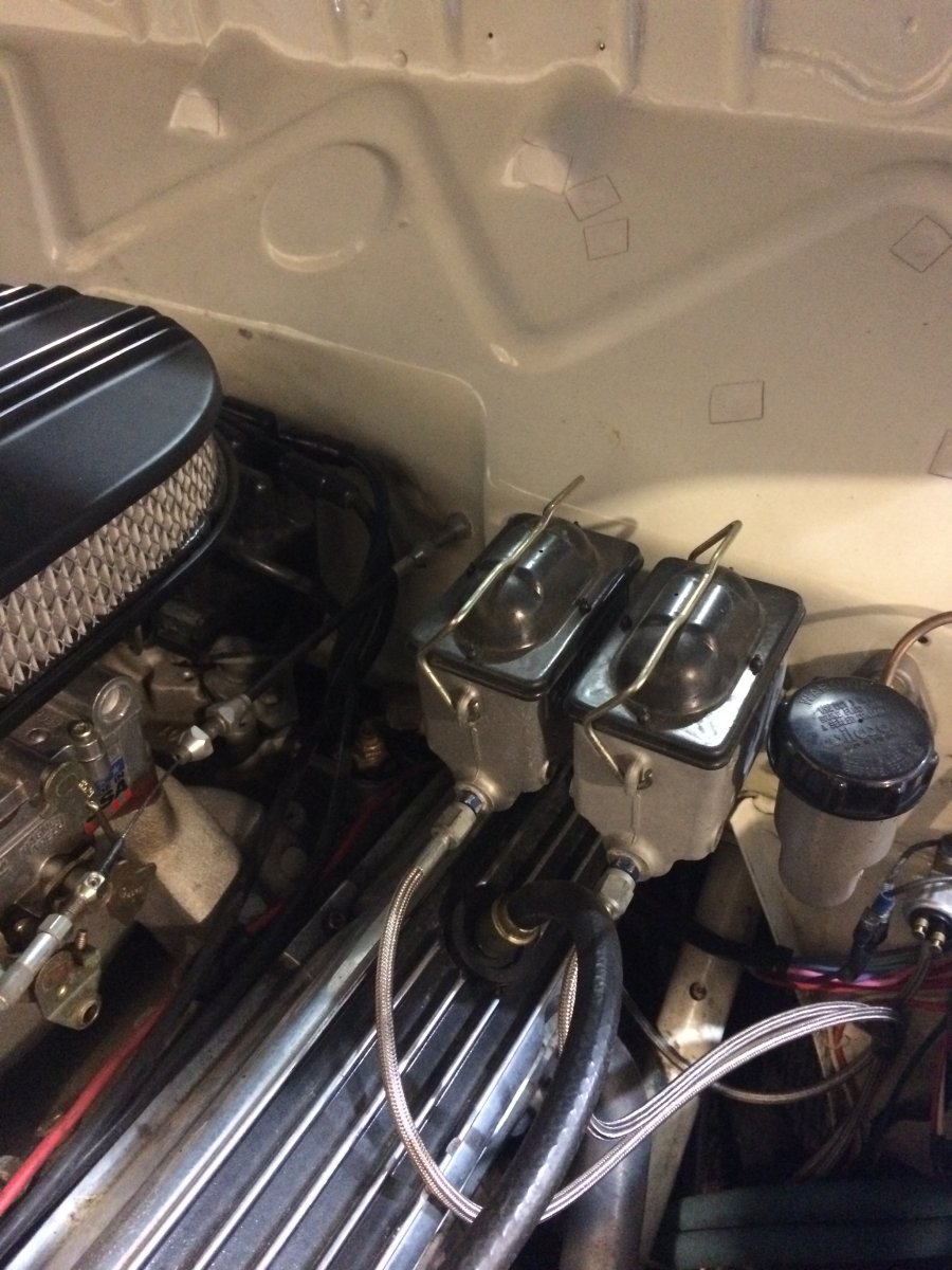

    I have a Wilwood dual master set up on my 40 Coupe. I am an old dirt track racer so I was familiar with them and used the firewall mounted, master forward hanging pedal set up. It works great but it actually requires a good bit of pedal effort. I have the 6.25 ratio pedals, they have 7 to 1 ratio also. I have 3/4 masters on both you should be able to tailor the pedal effort with the ratios and bore sizes to an extent but they have several brake clutch pedal set ups with tandem masters available in several different bore sizes.
