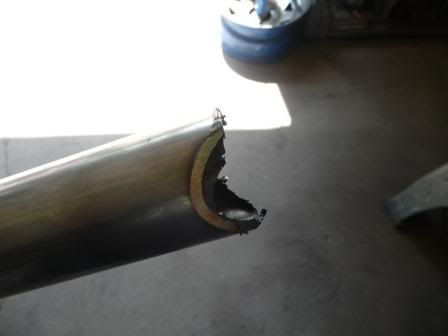

    The first is the chop saw method, and it requires no notcher at all. It does require a little practice, and it is the method that is most like art. What you do is set the chop saw vise at a 45 degree angle, and cut the corner of the tube off, flip it 180 degrees, and cut the other corner off. You end up with two notches that require a little m***aging with a file or disc sander to be a perfect notch.
    With the chop saw vise set at 45 degrees, the piece of tube is set in the vise and clamped in place:
    The corner of the tube is cut off and you now have one half of a notch:
    The tube is now flipped 180 degrees. If you are making a straight 90 degree notch, you will position the tube exactly like the first cut, if it is an angle cut, you will set the tube in a little further in the vise so you are cutting off more of the tube. This is where the art part of it comes in as it takes a while before you know how much to cut off for angle cuts:
    Here is the tube before deburring:
    And here is the tube after deburring with a disc sander:
    Just in case you think you cannot make accurate notches with this method, here is the notch and a piece of tube that it will weld to showing no gap at all. This is the method I use the most including chrome moly TIG welded cages:

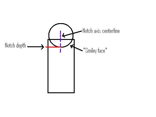

  11. When doing angled miter joints, one thing that REALLY helps is to cut the desired angle on the end of the tube FIRST. That way both notches are the same depth. If you are using a hole saw, this isn't AS important, but when laying notches out by hand, it is much easier to visualize the cut needed.
    I teach (and do) it in 3 steps:
    First, determine the axis of the joint (fancy way of saying which direction the notch needs to run on the tube) and cut the desired angle. A simple way to figure the angle is to lay the tube in place with a square cut end and measure how much "gap" is on the long side of the joint. (See drawing). Just make sure to leave enough extra tube on your initial (square) cut for angle and notch.
    Second, mark depth of notch. This varies depending on what size tube you are notching ON TO. For equal size tubes, I use 1/2 diameter - 1/8". This will leave a little material at the tips of the notch so it won't vaporize when you weld around it. If you REALLY want to know how to calculate the notch depth for any combination of tube sizes, Google "arc sagitta" and learn the geometry. Once you've figured out how deep the notch needs to be, mark that depth on the tube along the center line of the notch axis.
    Third, draw the notch profile right on the tube. Keep in mind that we need a ROUND shape, so if what you drew looks like this: \_/ .... wipe it off and try again. What you should have is a "smiley face" (see second drawing). Once you have the shape correct as you are looking at it, turn the tube 90 degrees and you will see the straight line you need to cut to get the notch shape. This method works no matter what the miter angle is.

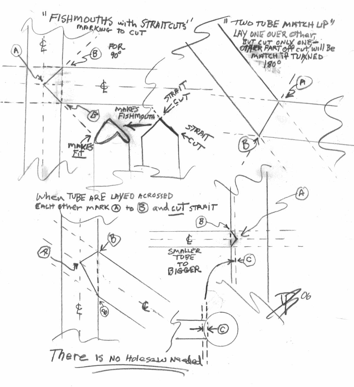

    Hole saws burn out much to fast and punchs are not really the way to go.I did this drawing a few years back to make it simple.:cool:
    This my KISS sheet for you all.
