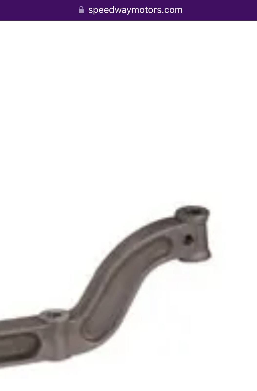

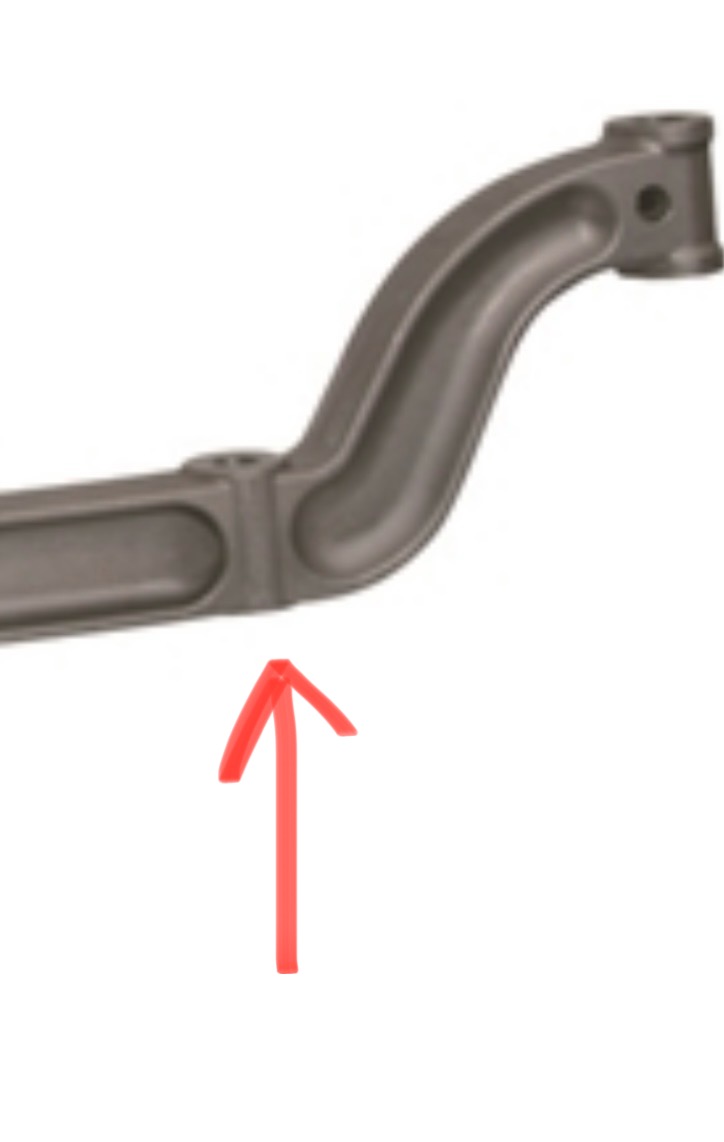

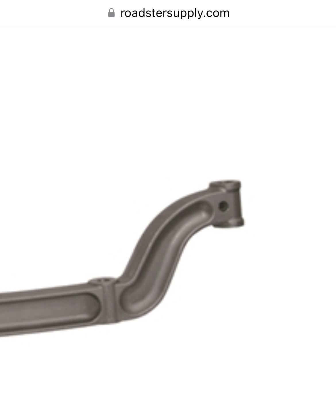

    In looking around at forged axles from three different suppliers I see a common thread, look at these photos and the businesses named at the top. The last photo is marked to show their common feature, they all came from the same forge shop. No idea where the shop might be located but that design feature strongly resembles the Hoffman cast dropped axles that were ****.
    Three different hot rod parts sellers appear to market the same axle yet many buyers may believe they are getting a particular name brand axle. How many times have we heard Speedway stuff is Chinesium, buy from Joe Blow, or whoever. Comments?

    I can believe that without a doubt, it just that the old Speedway cliche tells us their stuff is Chinesium yet if you buy from Roadster Supply it’s going to be superior.
    Would I use the Hoffman cast axle? Of course not, but my su****ion is their casting may have been used to reverse engineer (if that’s the right use of the term) the forging dies for the axles I showed above. There has to be a reason for the commonality of the available axles. So do they manufacture their own or purchase from the same company?

    Speedway Motors does have a 70,000 sq. ft. CNC machine shop with 20+ machines. As to what they are fabricating is anyone’s guess. I’ve seen it mentioned online that So Cal buys axle forgings and machines them in house but can’t verify that info. I understand that all sellers have suppliers, but I think my point was missed, those axles look exactly the same so how can some suggest an axle from Nebraska is inferior to one from California? We see the Speedway Chinesium comment all the time, well if everyone has suppliers why do some here only rag on Speedway?

    Fordors, it’s pretty obvious to me that the Speedway axle in your pics is similar, but not the same as the Roadster Supply and SoCal axles. You can’t see the difference?

    @alchemy , yes, after another look I see that you are correct, I see at least four different areas. I should have paid more attention last night when I posted.
