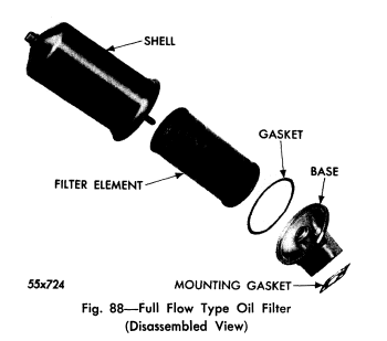

    54 was a wierd year, with crossover parts used (long bell housing for example) The shop manual shows a 53 style filter housing, and my 54 had one like the 55... The O rings were for the 53 style, with no adaptor plate. The 55 style on my 54 had the plate, and paper gaskets between the mating surfaces. Don't use the O rings, even though there are provisions in the block and use the paper gaskets.

    This is what the 54 shop manual shows. This isn't what was on my 54 haha. Note O-rings. 55 style didn't use them.
    2nd pic is from the 55 manual, and what I have on my 54. ( my car is a late 54, I know from the color code, sea-breeze blue was a spring 54 exclusive color)

    Mine was off the road since '64, so likely original.... It had no o-rings, (but has the grooves in the block). Paper gasket between the block and plate, paper gasket between plate and filter housing. I haven't run it since putting it back together, but did spin up the oil pump, and don't have any leaks by doing it the way I found it. My universal engine gasket kit from Hotheads had O rings and 2 paper gaskets in the set.
