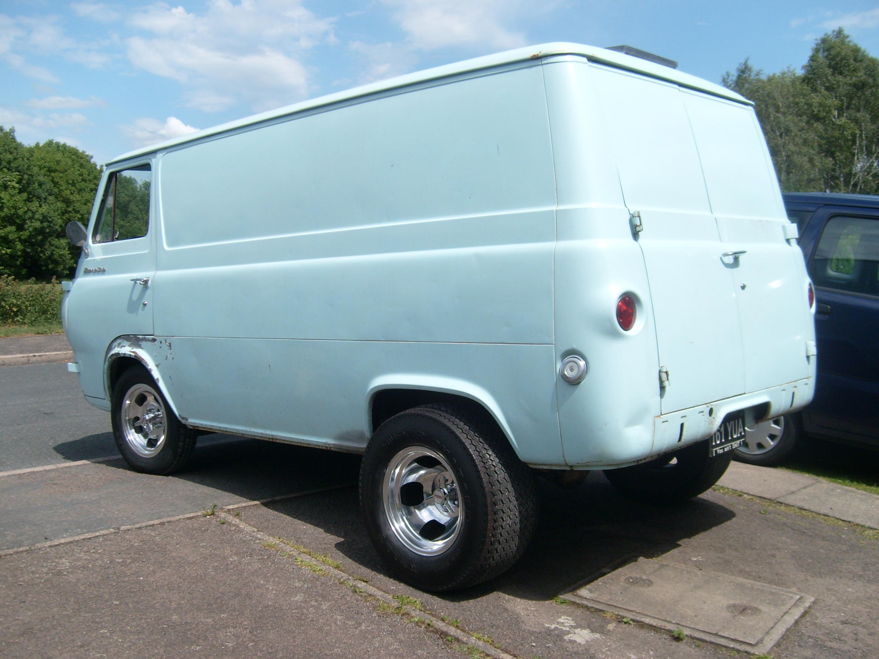

    Nice! What size are the tires in the rear? I'm trying to figure out the widest 15" rim & tire I can fit in the rear wheel well. I think the answer is 8". Not sure about the tire yet
  14. Radical Dave
    Joined: Aug 25, 2008
    Posts: 47
    Radical Dave
    Thanks mate I think your about right there, mine are 10x15 slots on the back and y'wouldn't get them under stock fenders without raisin' it up as I have :eek::):D :cool:.
    Dave.
