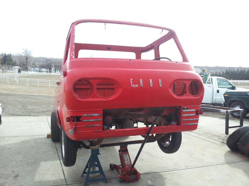

    Photo02191119222222222222222222222222222.jpg getting work done on mine hope to test it out by may.

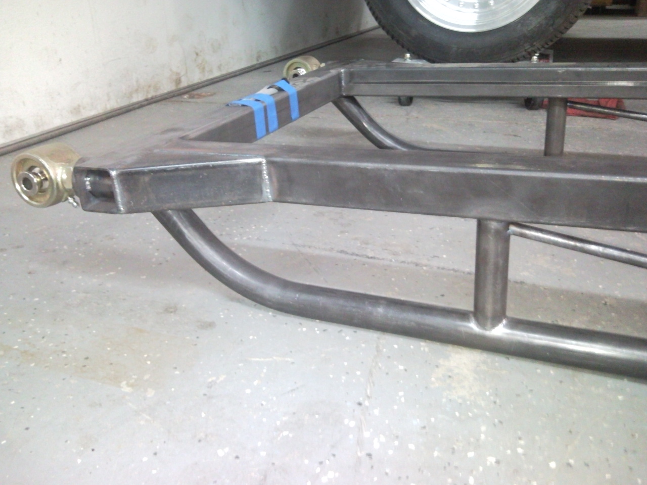

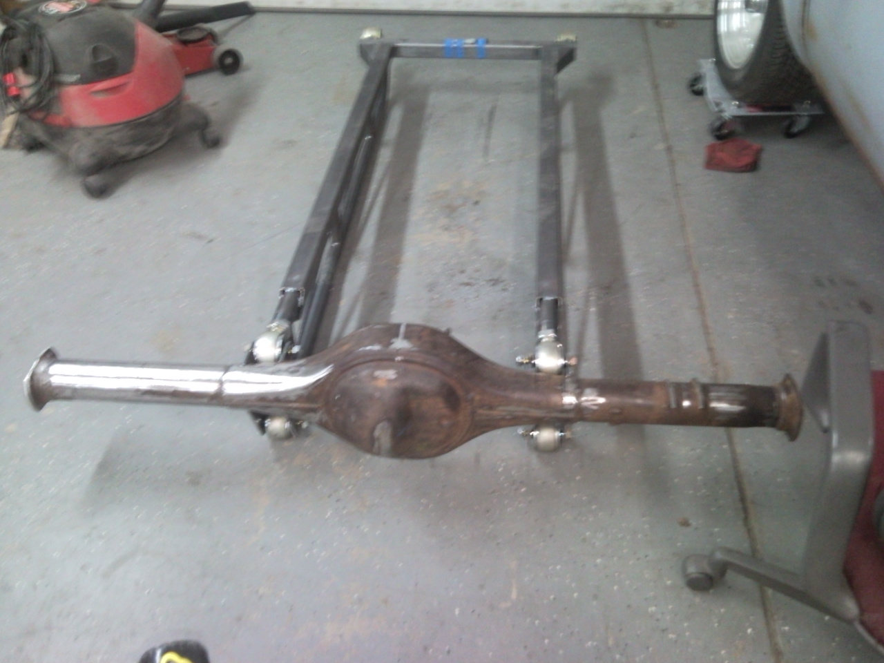

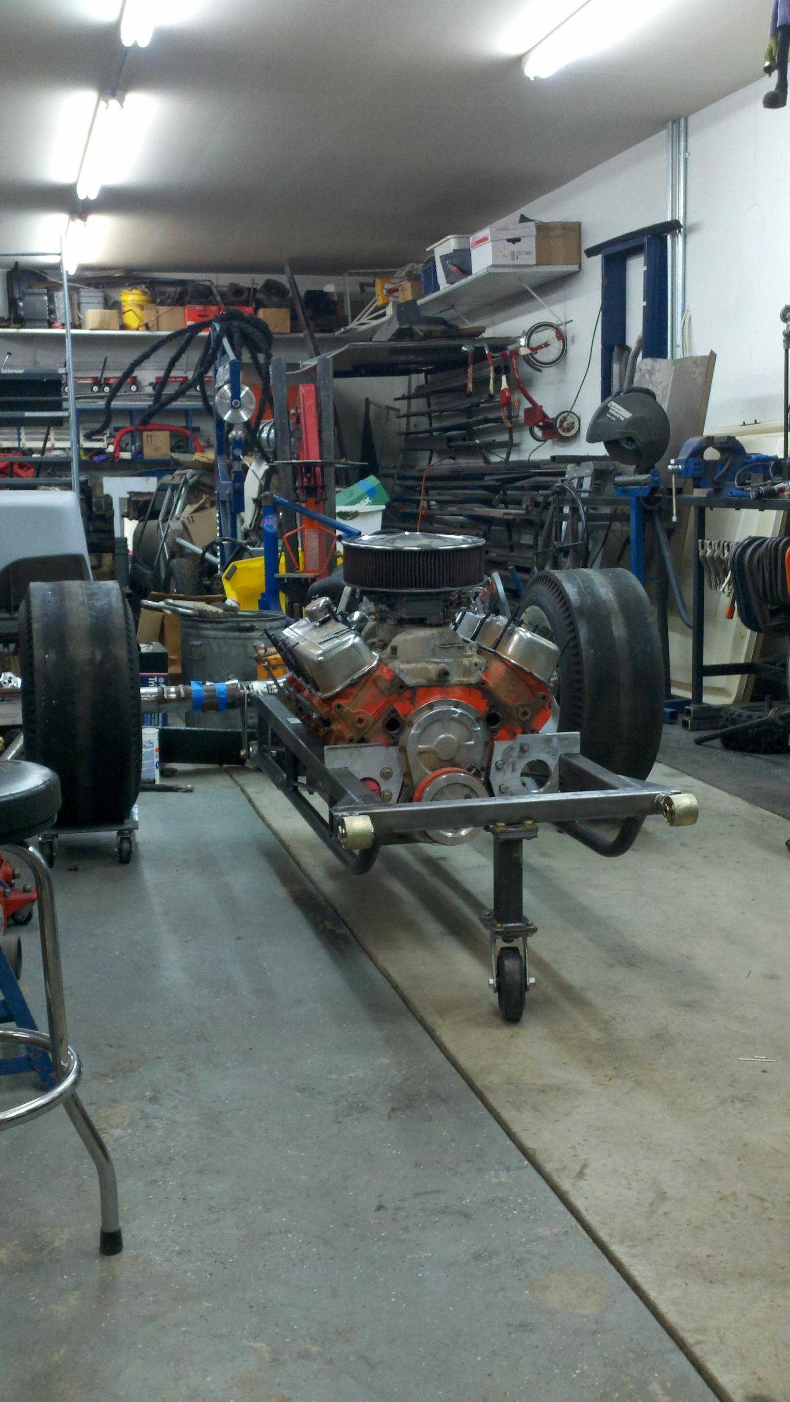

    From what it looks like your entire drive train will be independent of the truck frame, is that correct?
  8. radical flyer
    Joined: Jan 9, 2011
    Posts: 25
    radical flyer
    kinda. it still uses the rear leaf springs to support the weight and the shocks are attached to the axle and the frame but the axle is held in place with inverted axle floaters off the rear springs and heims in the front.its a big swing arm.
