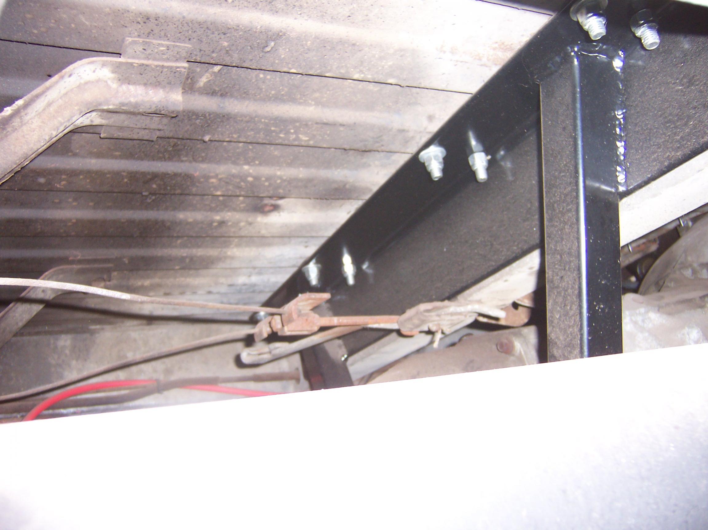

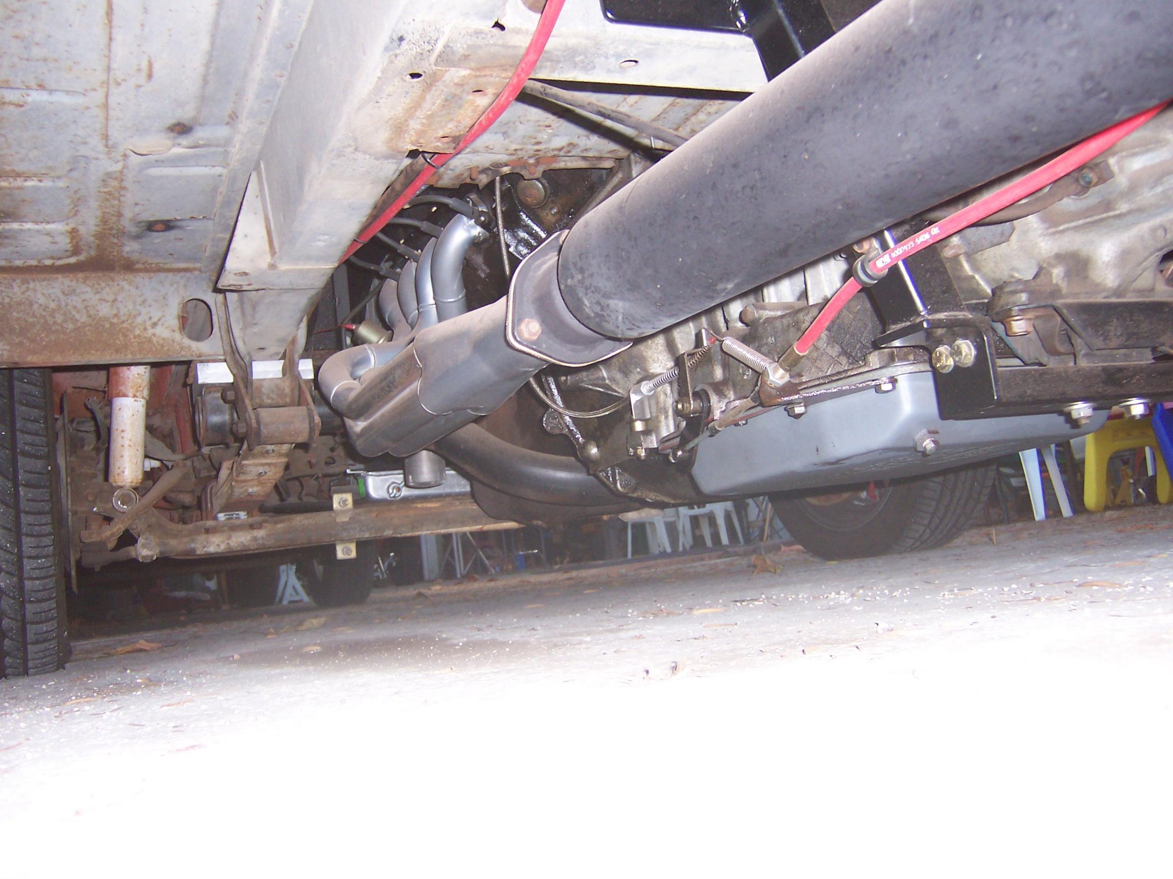

  15. go-twichy
    Joined: Jul 22, 2010
    Posts: 1,648
    go-twichy
    okay, it's not pretty, but here's my aod trans mount i made. this is a van that gets driven every week, so the underside is dirty!

    Is the AOD pan the lowest point on the truck? Looks lower than the straight axle?
  17. go-twichy
    Posts: 1,648
    go-twichy
    it's about the same as the axle. i had installed a trans drain plug when i put in the aod, and bent it over and lost some fluid. so i re-mounted it on the angeled rear face of the pan where it is in the pics.

    ok looks like a pretty simple design. but how well does the floor hold up to the torq of the v8? should i maybe extend mine to the subframe rails and possiably bolt to the corss support instead?

    thats a 3"x4" angel 5/16" thick with 8-7/16" bolts going through the floor on the low ribs! there's no movement. the old ford mount was as you probably know, was a single 1/2" bolt through a rubber doughnut. you could tie it in to the sides if you want, but i cant see it adding much because the unibody frame is pretty light gauge. you would need to weld tubes through with plates on the ends so you could put bolts through without crushing the frame.( if you can call it that!) the shock mounts can give you an idea of how you might go about doing it. the aod does weigh more that the stocker. kurt.
