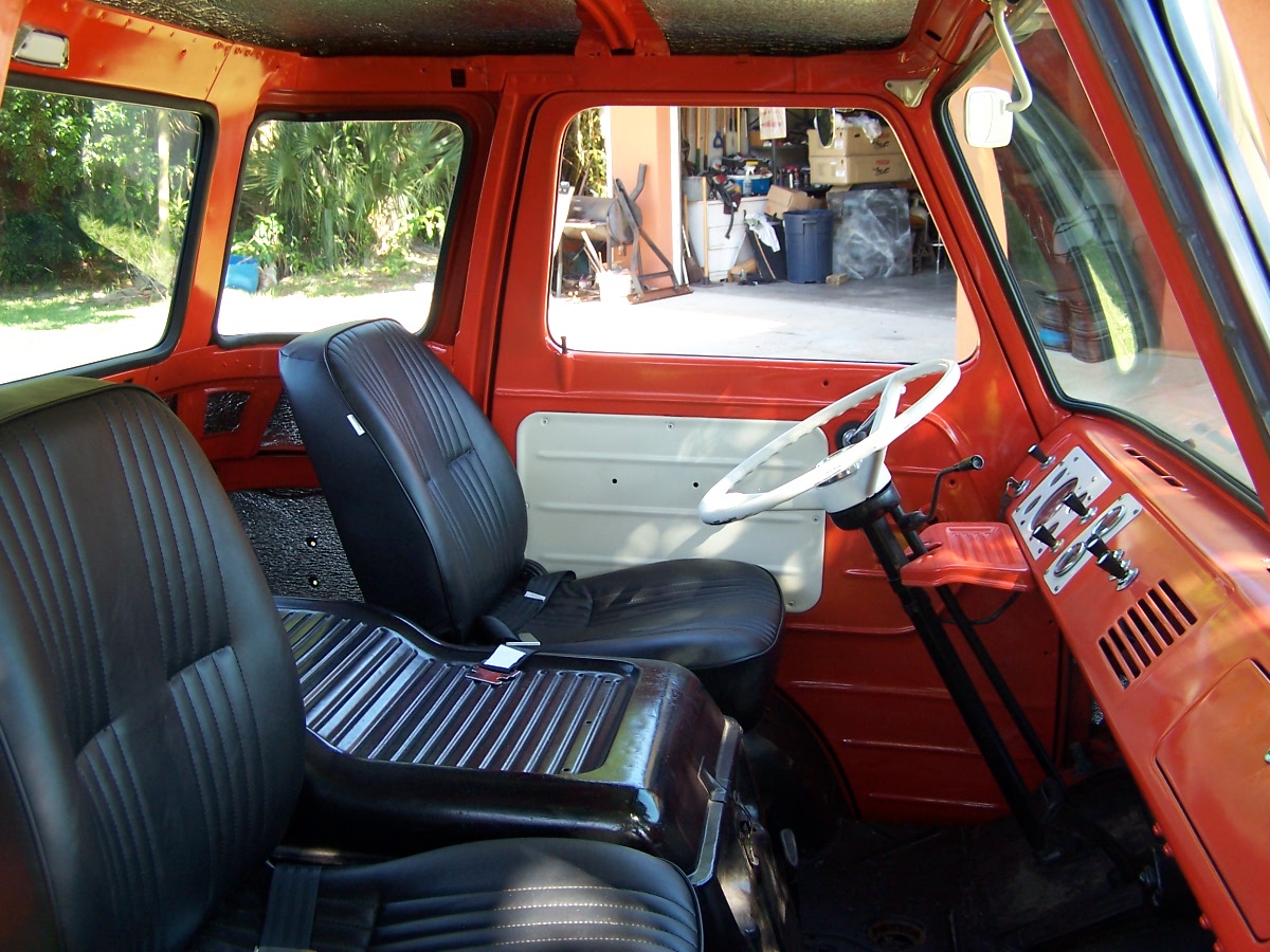

    Here's mine, a 65 Spring Special. Just put it back on the road after 10 long years. I'm in shake down mode for a while then paint and trim.

    Lookin good, that interior especially the seats look great!!

  11. 65EconoPU
    Joined: Jun 14, 2011
    Posts: 8
    65EconoPU
    Thanks, the seats came from JEG's. They were cheaper than rebuilding my old ones. Speedway has the same seats but shipping was more.

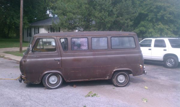

    Got new brakes and fuel pump on yesterday. Gotta flip the front axle back over and then the new kidmobile will be active.

    If your going to use that radiator the brackets are on wrong .

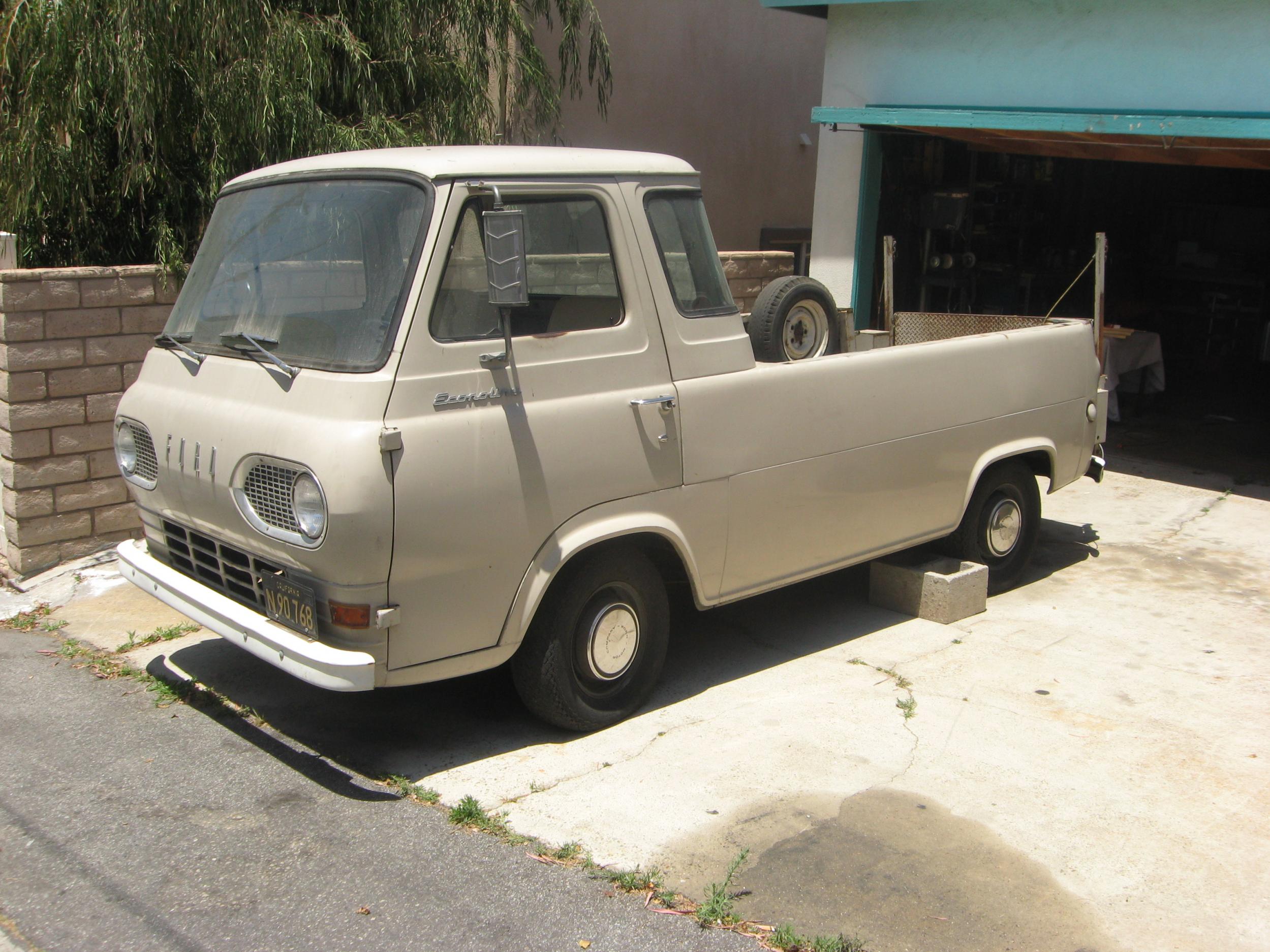

    Hi Everyone, I got real lucky and was contacted by the owner and asked if I wanted to buy an all original 1964 E100. The truck has been stored in a garage its entire life. 90,000 miles. I will need a tai gate this has a lift gate on it. The truck was used by a Japanese Gardener and not driven in the rain. it really is clean and rust free. Really rust free
