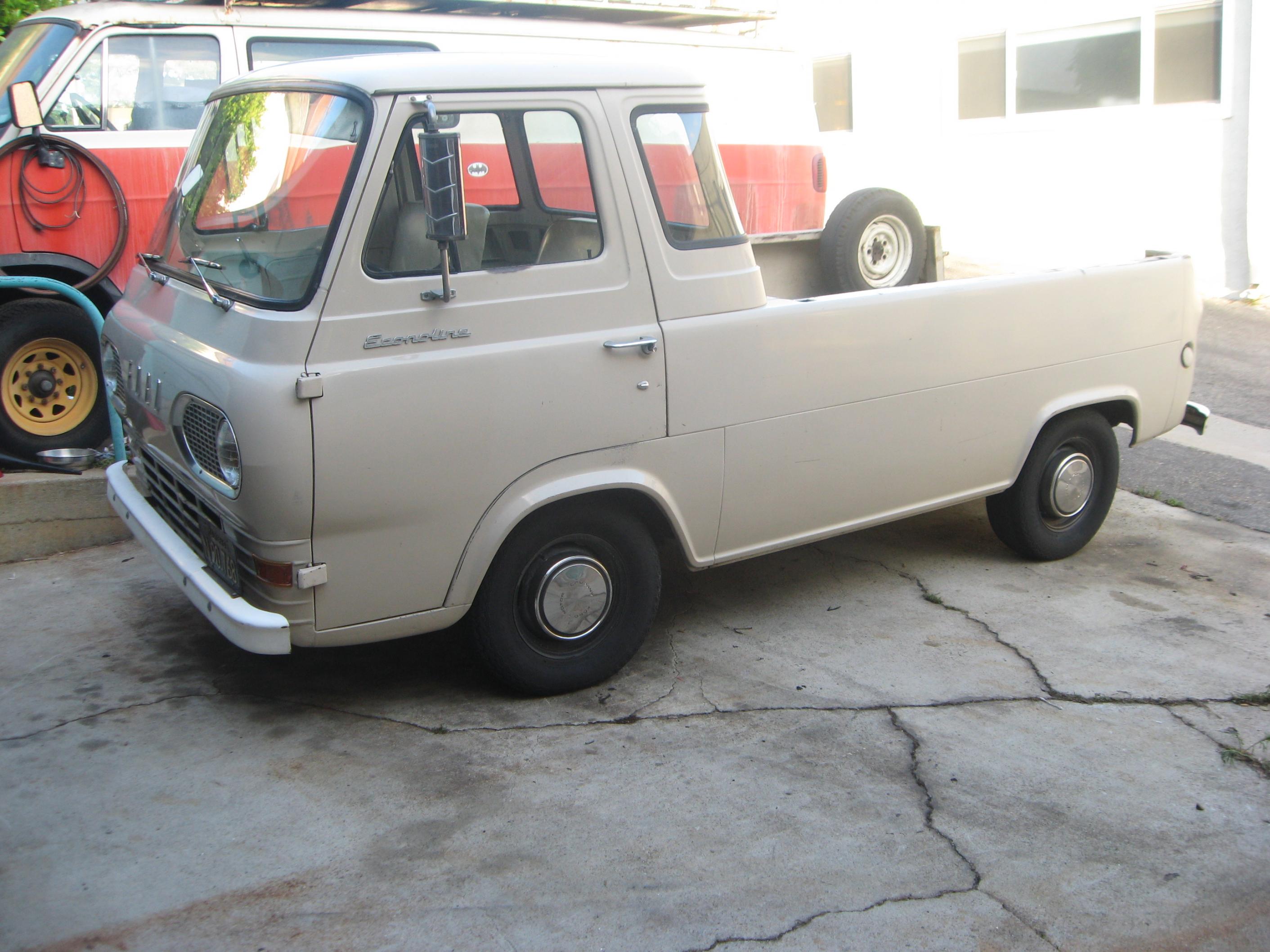

  23. johnnybentwrench
    Joined: Mar 24, 2011
    Posts: 73
    johnnybentwrench
    I finally got to wash it and remove the lift gate

    from the peg
    johnnybentwrench, what do you mean by lift gate ?......got a pic ?.......if it has some weight to it you might find it helps to balance things out..........these are quite nose heavy as there was a steel plate installed from factory above the gas tank to ***ist as rear ballast.......looks good too.........
  26. go-twichy
    Joined: Jul 22, 2010
    Posts: 1,648
    go-twichy
    shoot, don't give up on that one. that truck looks great.

  29. johnnybentwrench
    Posts: 73
    johnnybentwrench
    The original owner was a gardener who kept it in a garage every night. The truck is all intact minus a tail gate. Everything works , but the horn.
    What size tires are the stock equivalent. I am looking for a light truck tire. I will use it for finish carpentry. I know there are threads on econoline tire size, but there all running them slammed or with different rims, disk brakes. Thanks, John
