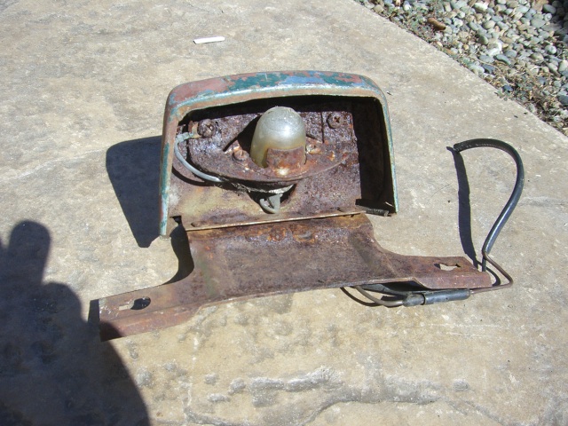

    is this what you are looking for? If so, PM me.
    It's a little crusty, but everything is there and it should clean up OK.

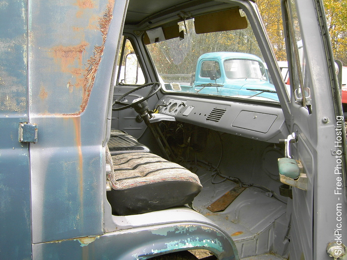

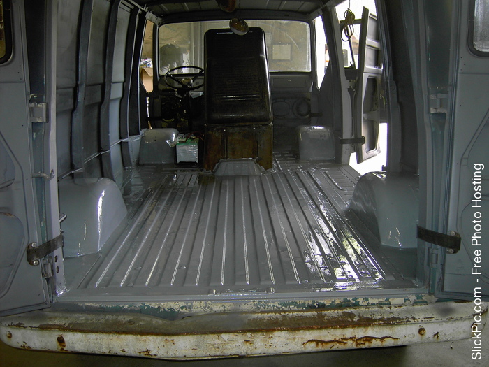

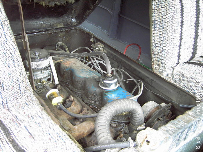

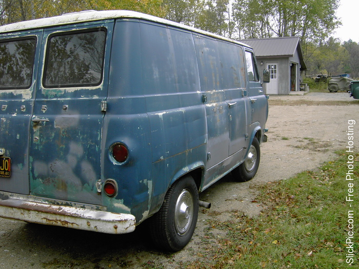

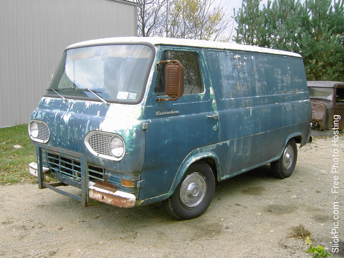

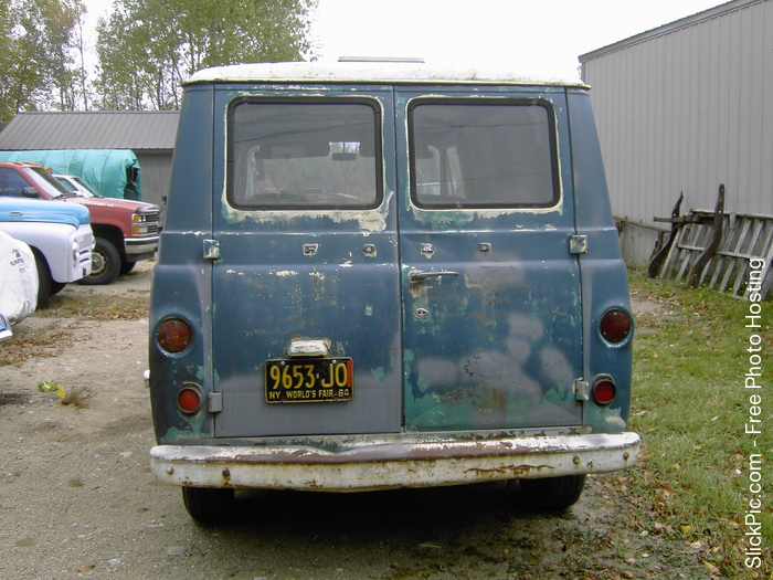

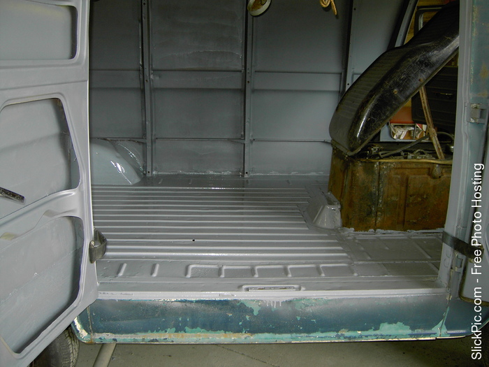

  29. here's mine......so far I've wire brushed the inside then epoxy primed it, replaced lower door skins and door bottoms,fixed rot in floor, replaced windshield rubber, new master cylinder,cleaned gas tank, replaced sending unit float,new horn relay, ****on and spring.2nd hand headlight switch,used thermostat housing, new thermostat,added a overflow tank,tune up, 4 new tires,..you get it the drift, the usual stuff. Most of the bugs are worked out with exception as to where the oil is leaking from.....
    oh yea ,she's a 1965 ford falcon econoline van....you can see the falcon name on the p***enger's door....

    Solid looking van!
    What kinda carburetor is that?
