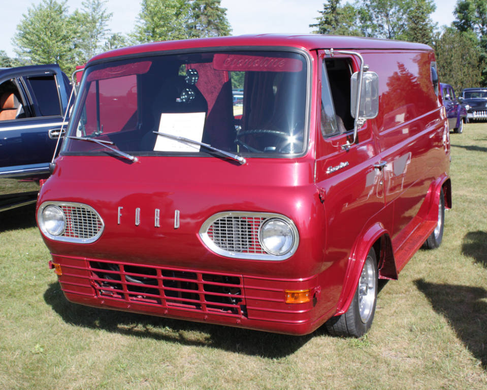

    so... just bought this
    and I need some help with two things.... first off, can I find gas tanks anymore?
    Second.... I need a new carb for the 200 six cyl and noticed on ebay, 1 bbls are going for 300-400.... should I be running a 1 bbl? Should be running a 2 bbl? Any brands recommended?
    Thanks and glad to find this forum.

    Duraspark II ignition, and a Weber 32/36, or a 38/38, on a Cl***ic Inlines adapter, will make a noticeable difference in power. If the DS II won't fit under the cover, then a just prior to DS conventional distributior, with a Pertronix Ignitor.

    I love that paint scheme!
    1. Are you sure it's a 200? If so, it was swapped in. There's a Ford Falcon 6 club with a forum online that has lots of great info on hopping up old Ford 6s. They might have some carb suggestions. In the meantime, can you just rebuild yours? ****ster here on the HAMB does nice carb work, too.
    2. No one makes gas tanks for Econolines. So, you can either boil out and seal yours, or for about the same amount of money, buy a new Mustang tank (about $100) and modify it. I've covered this in other posts, but buy a repopped 1965-67ish 15gallong Mustang tank (or 69-70 20 gal) and modify it so that it's a has a side fill instead of a top fill. When I did mine, I cut off the parts from the original tank and had them welded onto a new tank.
  19. Hellfish
    Joined: Jun 19, 2002
    Posts: 6,807
    Hellfish
    Get the Mustang sending unit while you're at it. It will work with your stock Econoline guage.

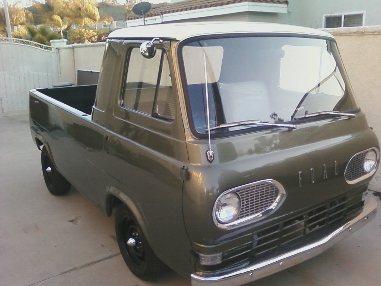

    [​IMG]never tried posting pix before, hopefully I get more than the dreaded red X. My 63 pickup, bought 4 months ago. Ex military vehicle, still has the nomenclature tag on the dash, future plans include a V8

    Have most of the major rust outs fixed, kinda shooting for a "g***er" "wheelstander" look.

    Will it actually be a g***er or wheelstander, or will it be a fake?
  27. Fords-R-Us
    Joined: Sep 29, 2011
    Posts: 58
    Fords-R-Us
    from NE Iowa
    The key word here is "LOOK" all kinds of fakes in this world, but it'll have the look or "vibe" or "fake" what ever you want to call it.
