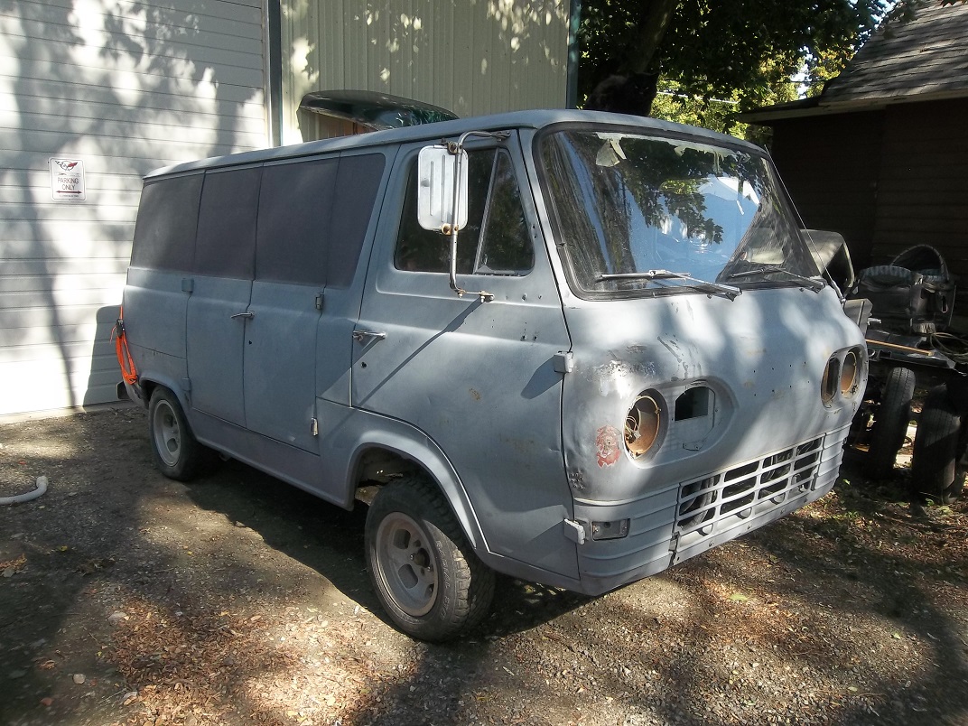

    Basket case?!? You west coasters are funny. I think that's in better shape than mine.

    that's what I was thinking. Looks like a great start for us in the mid-west.
  3. Nearly every part inside has been dis***embled. The body is the basket! But, yes it's not bad at all. The guy that took it apart bagged and marked everything pretty well. I'm very happy to find one in this good of condition. Very little rust. New motor and trans was dropped of yesterday! Not sure what I'll do with the 240 3 speed, but I'm sure something will come to me.

    That's not a basket case, that's just a really nice starting place for a project! :)
    What's wrong with the 240 3-speed? They work with just about every engine you'd want to drop in there... the big 6s (240, 300), and the small v8s (289, 302, 351). Bolt up and go! I got mine for free, so I can't say they're worth a lot, but they were only made for 3 years (65-67) and only available with one engine, so anyone wanting to do a v8 conversion wants one (unless you want a slushbox)
