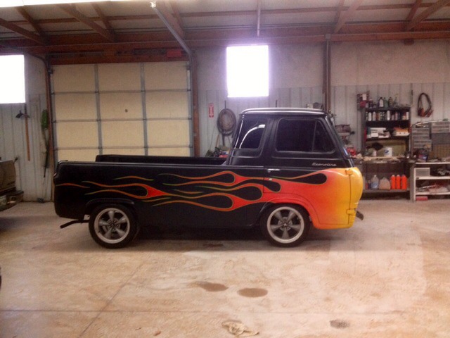

    I'm with chainsaw...looks good where it sits now, don't think you can go much lower without bagging it which done correctly would involve a lot of mods, but hey, if there's a will there's a way. BTW, did you flip the axles or remove some springs?

    Yeah, I know that I may not get much more out of it but I have to try. So far I have flipped the axles. Will take a fair amount of work to get a little more,but I think it will be worth it if it can be done. I am happy with where it sits now though, so it's a win win either way.

    dante... love the stance, do you have and pics of the axle flip? wondering what all is involved with flipping the front axle?

    No pictures of the suspension yet. It's just mocked up right now. Waiting on Todd at lowboy motorsports to go through it and finish it up. Will get some pics when we get it done. I did have to get a flexible lower radiator hose that I could do a 90 degree turn up with to accommodate the new axle position. Also we will have to notch the "frame" front and rear for axle travel.

    Hi Dente81 98 . Do you have the stock running gear in it . ?Be carefull , the trans hangs lower than the body and will drag on the ground before the body hits the ground .

    Yeah it has the stock running gear. And yes, it foes hang down. Even if I do get it any lower it still has more clearance than my past customs. Definitely something I am keeping an eye on.
