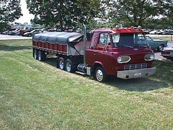

    That "big rig" Econo is kinda neat. That first photo may be Photoshopped, or they built a small scale trailer.

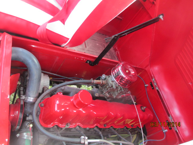

    Anyone have a doghouse hood prop like the one on the other page they want to sell
