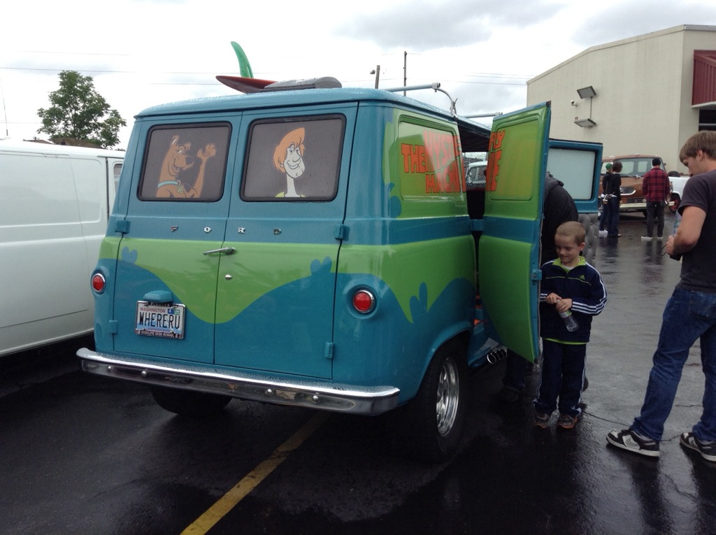

    ImageUploadedByH.A.M.B.1396925841.099518.jpg ImageUploadedByH.A.M.B.1396925863.719365.jpg ImageUploadedByH.A.M.B.1396925879.994926.jpg ImageUploadedByH.A.M.B.1396925899.487899.jpg ImageUploadedByH.A.M.B.1396925917.687642.jpg ImageUploadedByH.A.M.B.1396925939.305567.jpg ImageUploadedByH.A.M.B.1396925964.468489.jpg ImageUploadedByH.A.M.B.1396925987.971081.jpg ImageUploadedByH.A.M.B.1396926005.140271.jpg ImageUploadedByH.A.M.B.1396926021.150377.jpg ImageUploadedByH.A.M.B.1396926037.267552.jpg

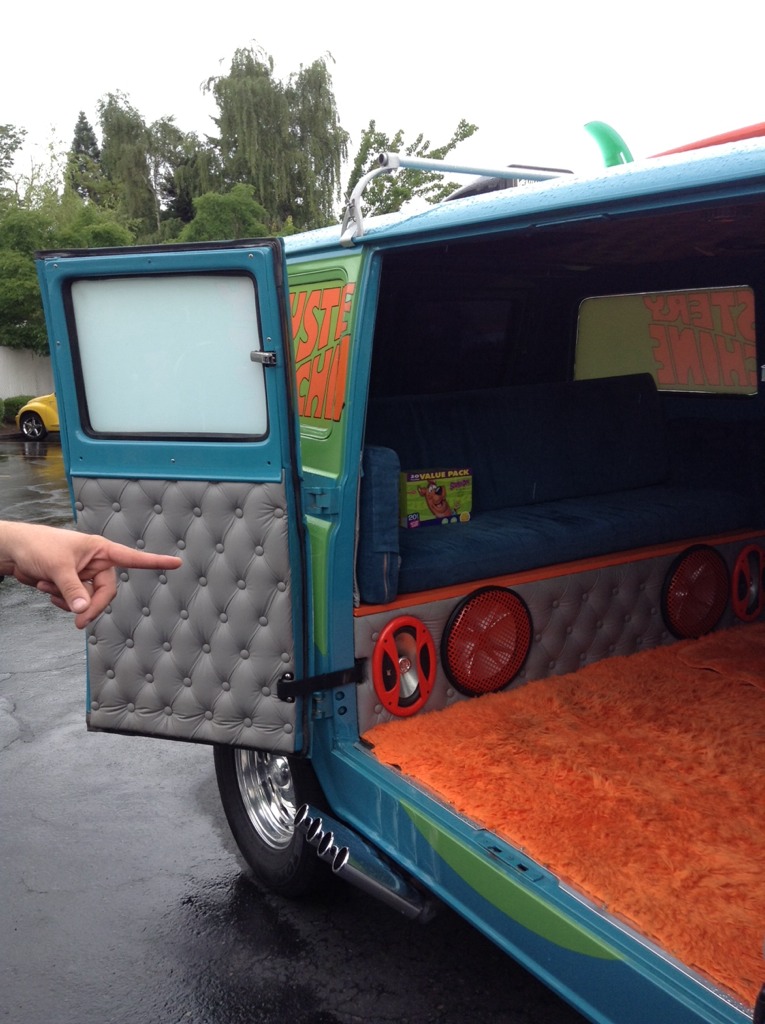

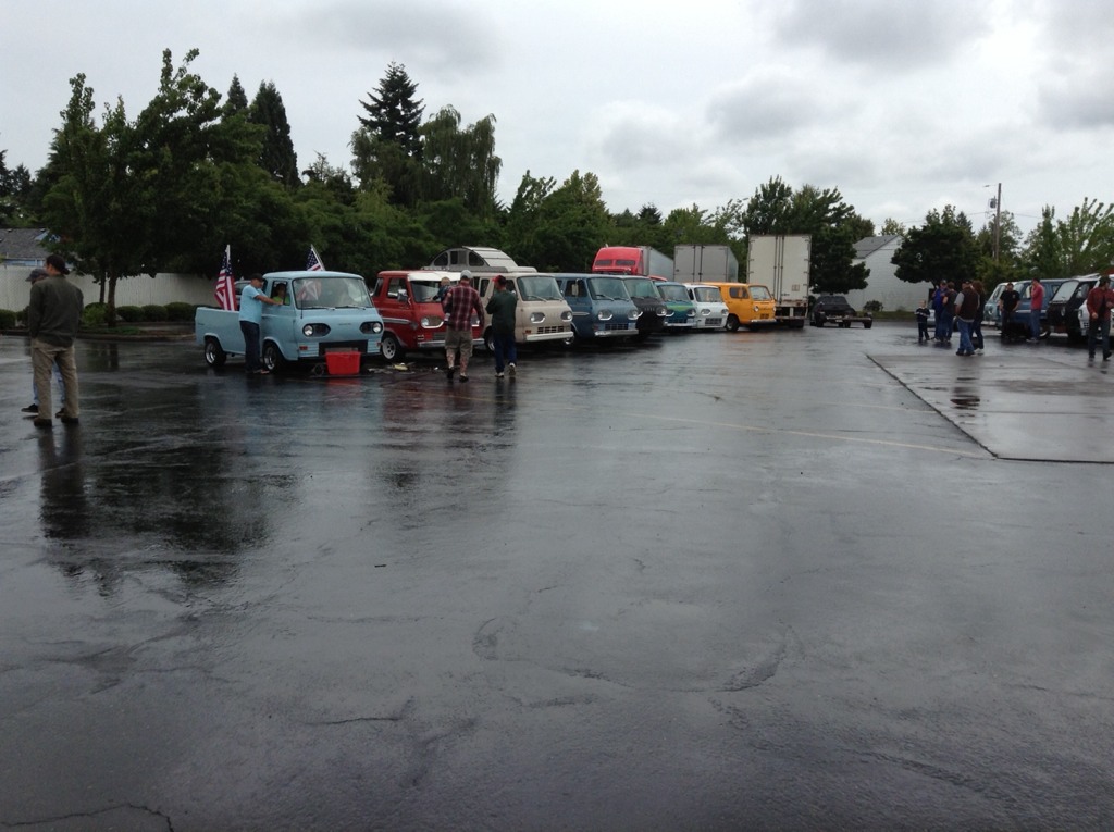

    Here's some pics from 2013 Econoline meet in Portland. Always a good turnout.

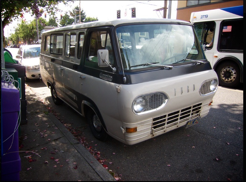

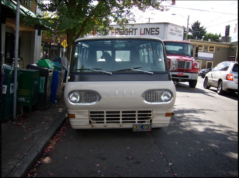

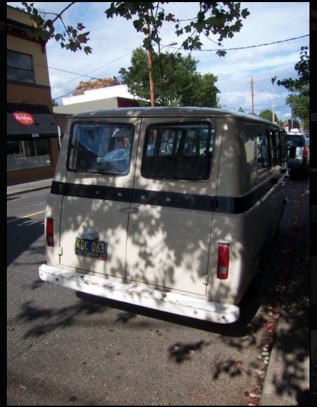

    ImageUploadedByH.A.M.B.1396927363.504604.jpg ImageUploadedByH.A.M.B.1396927371.259824.jpg ImageUploadedByH.A.M.B.1396927379.208080.jpg ImageUploadedByH.A.M.B.1396927387.353728.jpg

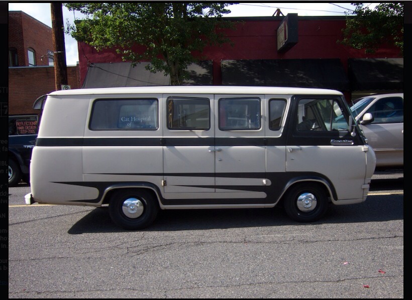

    Here's a few pics that appeared in Streetpeeps.com in the fall of 2011.

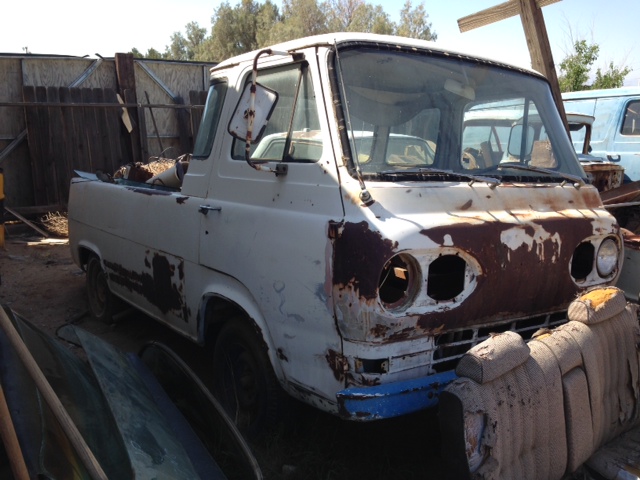

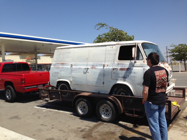

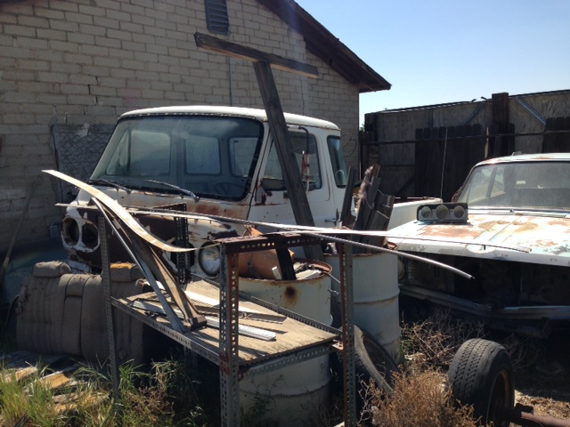

    So count me in. I have been working getting this van for 6 yrs... I finally picked up the 1964 Panel... and the rest 1965 5 window with a cherry gate, and a 1965 Panel project over the weekend from 41Dave.

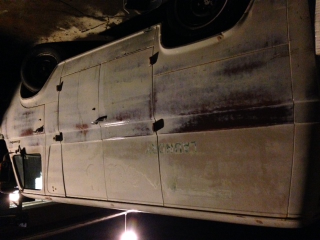

    My 64 is really clean and a retired Laundry/Cleaner van. Has white over the original emblems. Im going to try to color sand the white off and get the 'original' color back. It will be a chore but worth a try. Anyone had any experience on trying to save old patina?
    Im excited to dive into the 64. Its super clean with a few minor dents along the bottom. However though, It has been sitting a long time in the desert. I tried to turn it over this weekend but its stuck. :( The motor turned the fan 1 revolution then it stopped! :( The radiator hoses were rotted. I pulled the plugs (all they had on them was black carbon) and put some PB last in the cylinders to sit overnight. I might be in the market for a 170 or 200 to swap out the engine. Im anxious to get it running!
    I plan on lowering the 1964 and Gassing out the 65 Truck. I picked up a 302 with a C6 trans to stab into the truck. The truck had a 240 engine with a 9" The 240 had no head and the cylinders were rotted. I am looking for an engine mount since the one under the truck was taken out for some other project from previous owner.
    If anyone has 170 or 200 they pulled for a V8 swap in California...that runs good, I am starting to be on the lookout for one. Is it even worth rebuilding the engine? A master kit is like $390 on Ebay.
    Im looking for a few parts: Pop-out windows for rear doors, HD engine mount, Headlight grills
    Lets see how this plays out, I'm excited. BTW: This is my 6000 post! WooHoo!

    Save the 240 trans. It will work great for someone wanting to drop in a v8 but keep a manual trans. They're not worth much, but they're THE trans you want for a swap.
    I would think that you could find a good running 170 or 200 for the cost of that rebuild kit. I know a guy in Chicago selling a freshly rebuilt one for $400, I think.

    U probably will have better luck wiping the paint down with lacquer thinner than sanding it ( newer the paint better it will turn out)

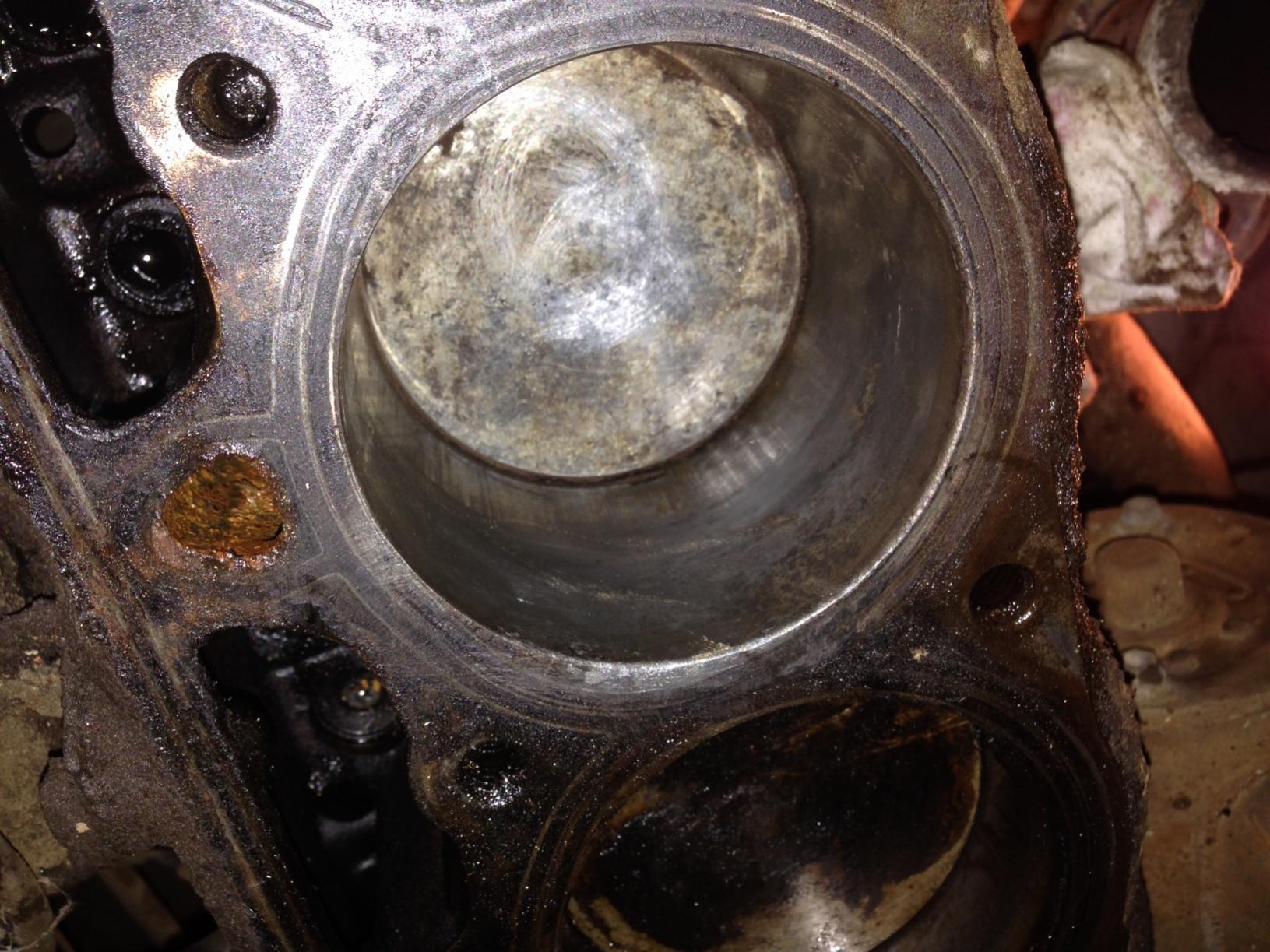

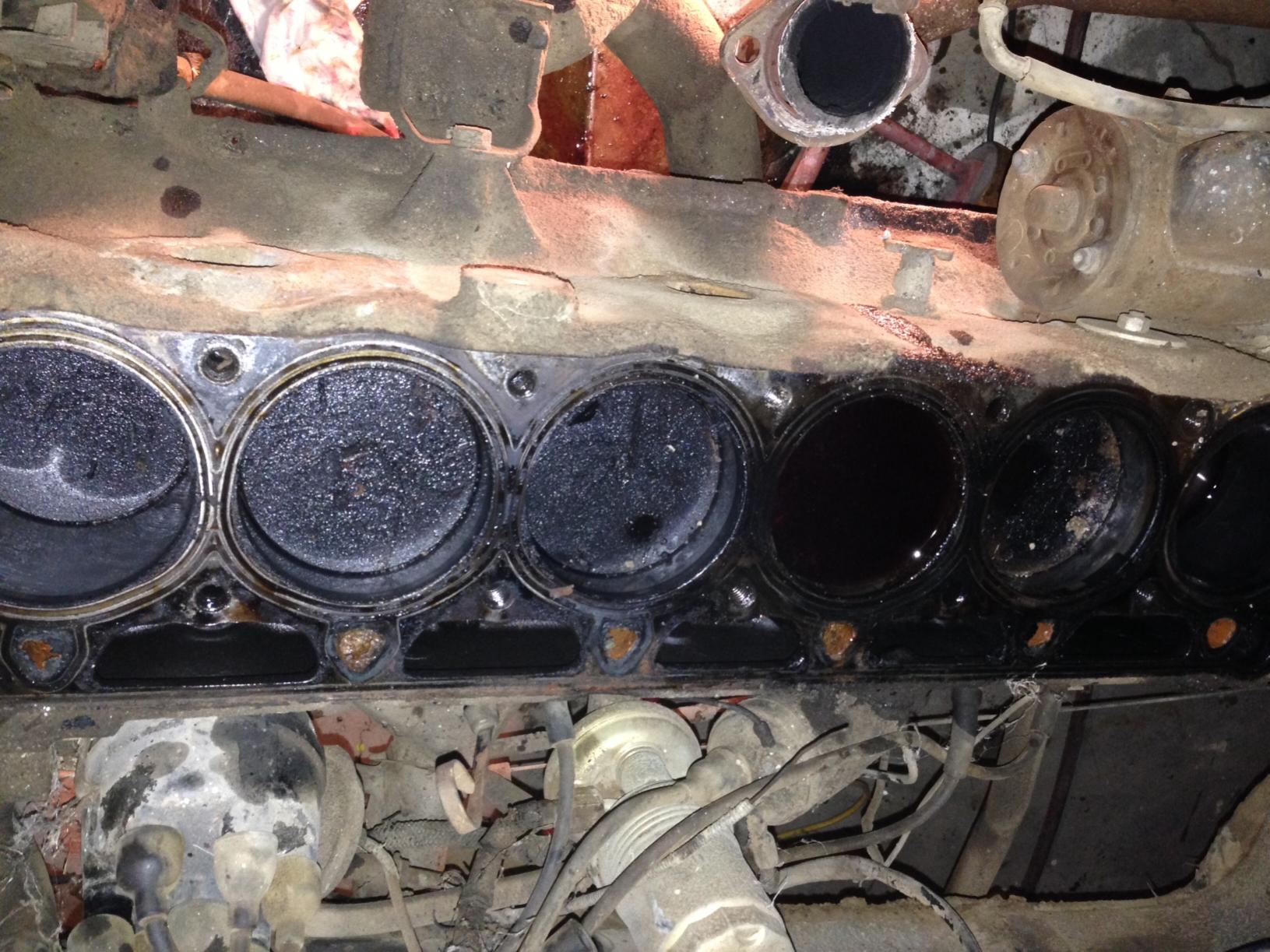

    I found the culprit on the engine. After ripping it all apart literally with the exception for the crank, rods and pistons... Cylinder 4 must have filled up with water or maybe a possible head gasket failure at some time. The piston was 'sealed' in the cylinder. You can see my Marvel/ATF mix that never drained to the oil pan. I cleaned it out and found a rusty like paste/glue stuck to the cylinder walls. I turned the crank and tapped the piston down with a hammer and piece of wood to see what was really going on. I cleaned out the cylinder with a wire wheel on my drill, ran a cylinder hone in it and wiped it down. there are a few small pitted spots on the cyl. wall, but for the time being until my 'good' motor shows, this will work. Im glad I found the issue, but bummed I had to tear this thing down just to find the problem. Time to put it all back together!
