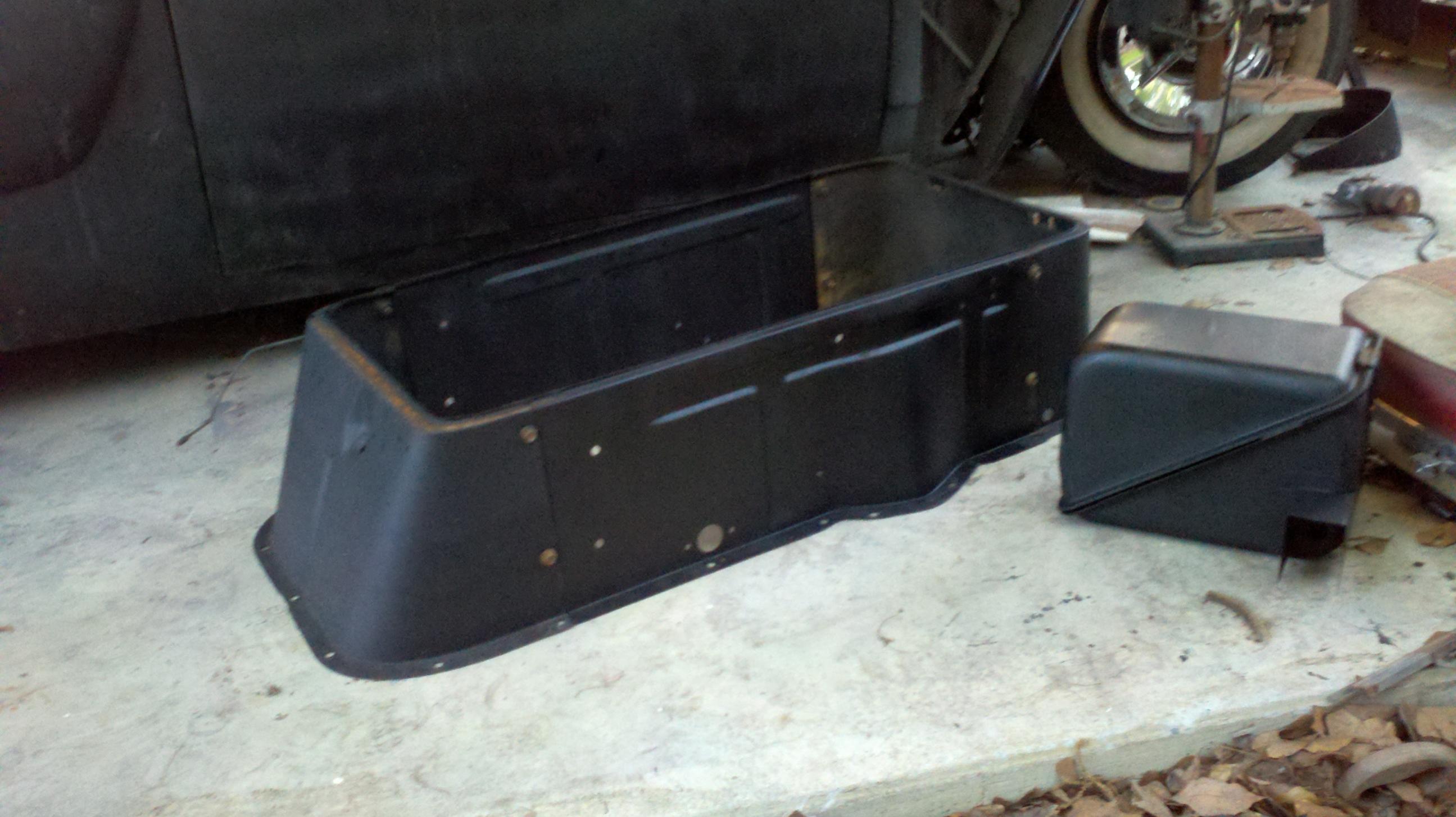

    Yesterday I removed the heater box, air vent boxes, and headlight bezels.
    I also removed the brake pedal and master cylinder. I plan on doing a disc brake conversion on the front and running new brake lines all around.

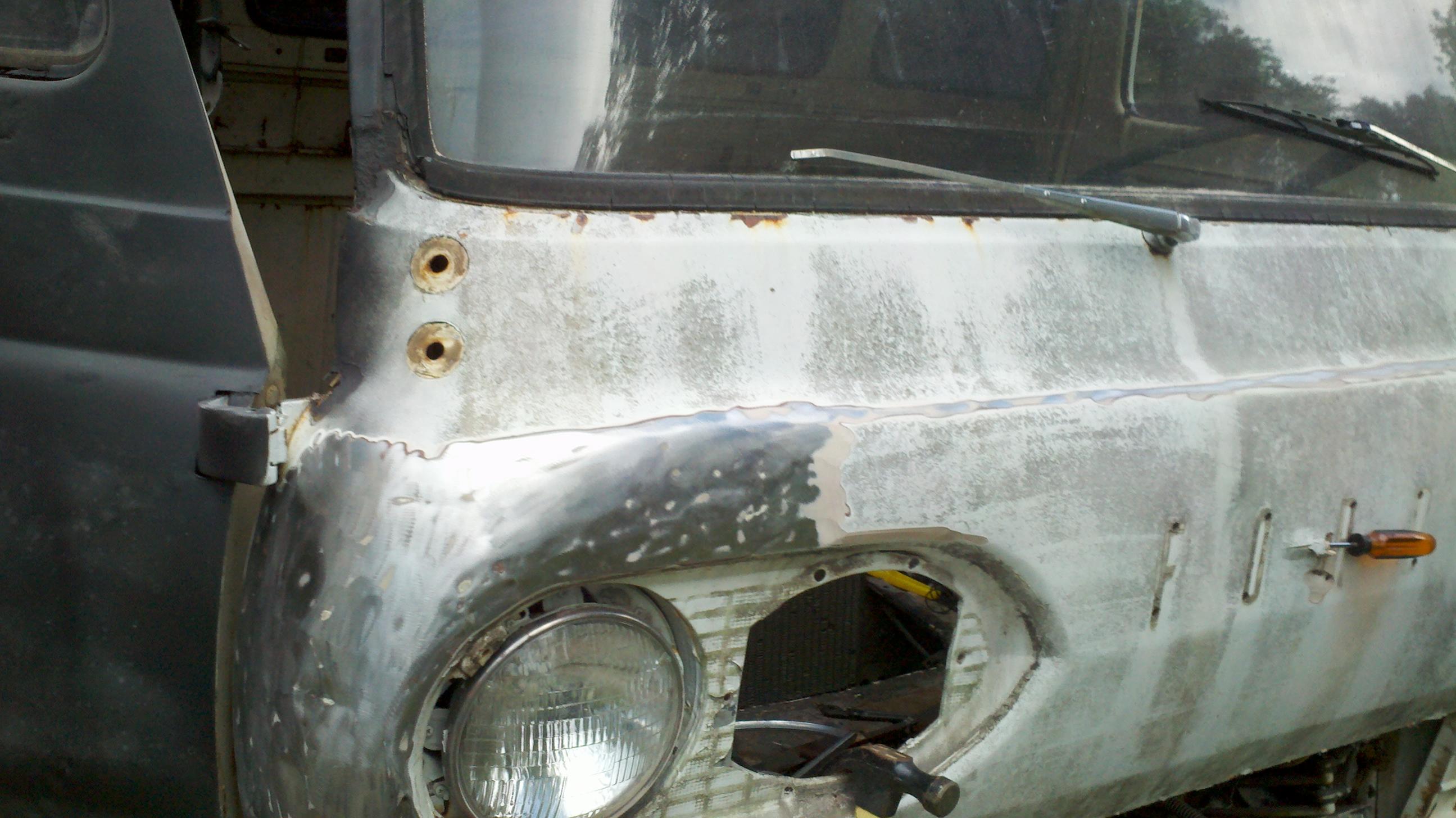

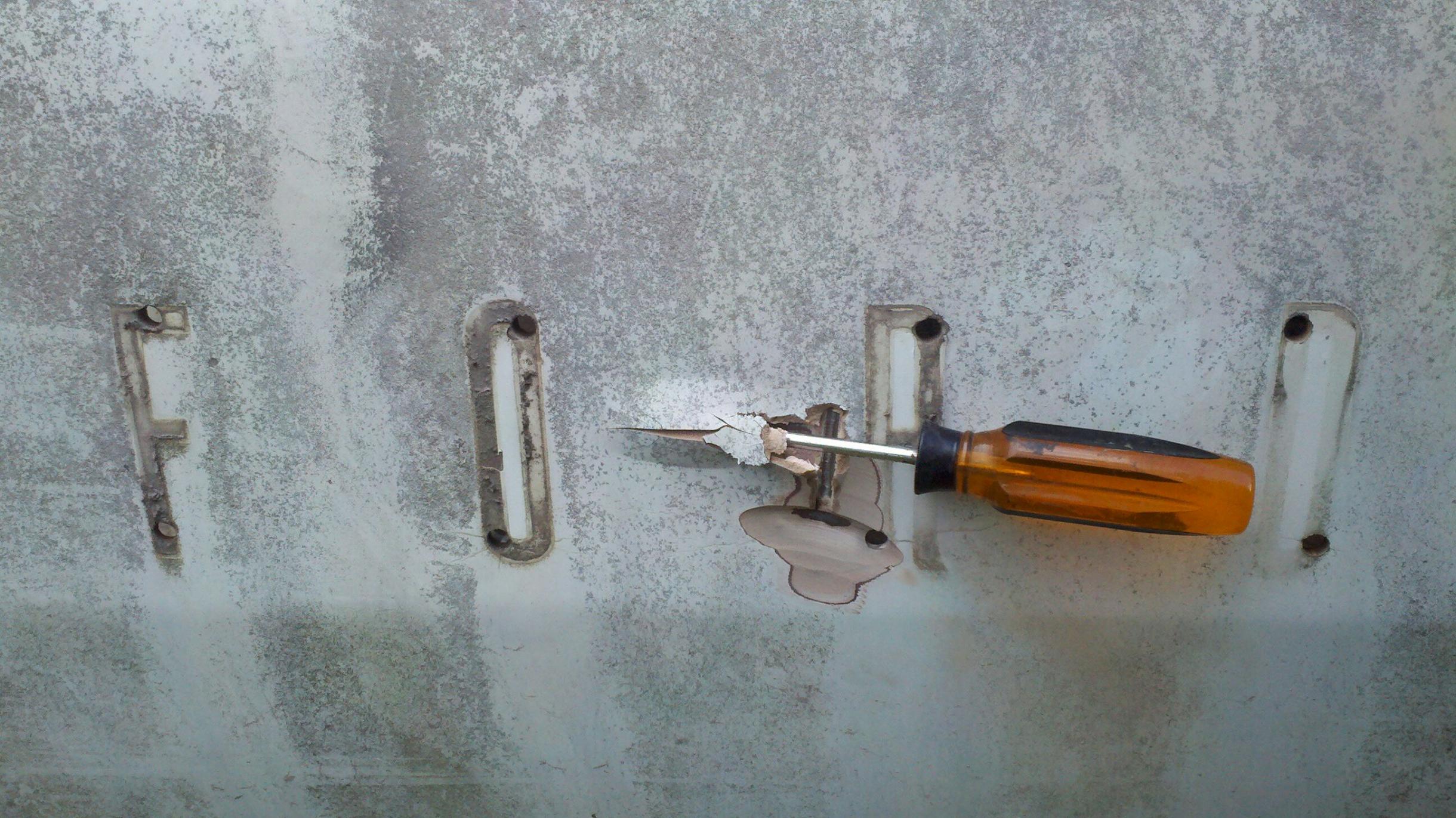

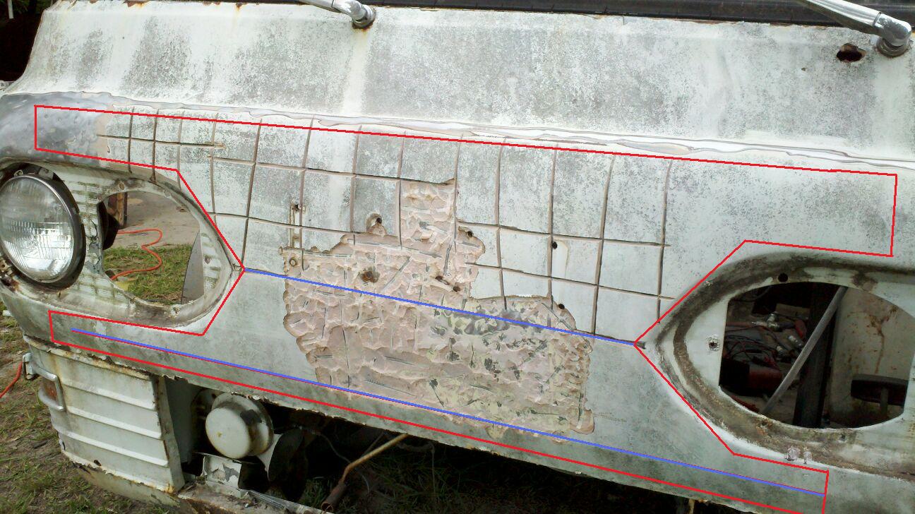

    I started stripping the front of the truck and guess what I found?...More Bondo. It was thick enough that the easiest way to remove it was using a hammer and screwdriver. Just like the other spots on the truck that have been covered in bondo, the damage underneath isn't that bad. Dont get me wrong..the nose is pretty beat up but not enough to warrant that much bondo.
    The pic below with the grid looking pattern is from where I used the edge of an old stripping disc and cut into the bondo just to see how much was on the front panel and how thick it was.
    I still haven't got the motor to fire up but part of the problem is that I think I have a bad fuel pump. I will be replacing that in the next few days.
    I am also thinking of rewiring the whole truck. If i do I will use a rebel wiring harness. I have used them in the past and it is my wiring harness of choice for any future projects.

    yeah I know what you mean. It would be so much easier to just weld in a new nose (and I'm going to look for one). But I am a certified body man and I know i can do most of the work. I am tempted to try and make a partial new nose for my truck...cut out all the bad area. use a metal brake to get the creases and then use an English wheel for the slight bow in the nose.
    If I try it I will do***ent everything
    The pic below is about the area I would try to replace

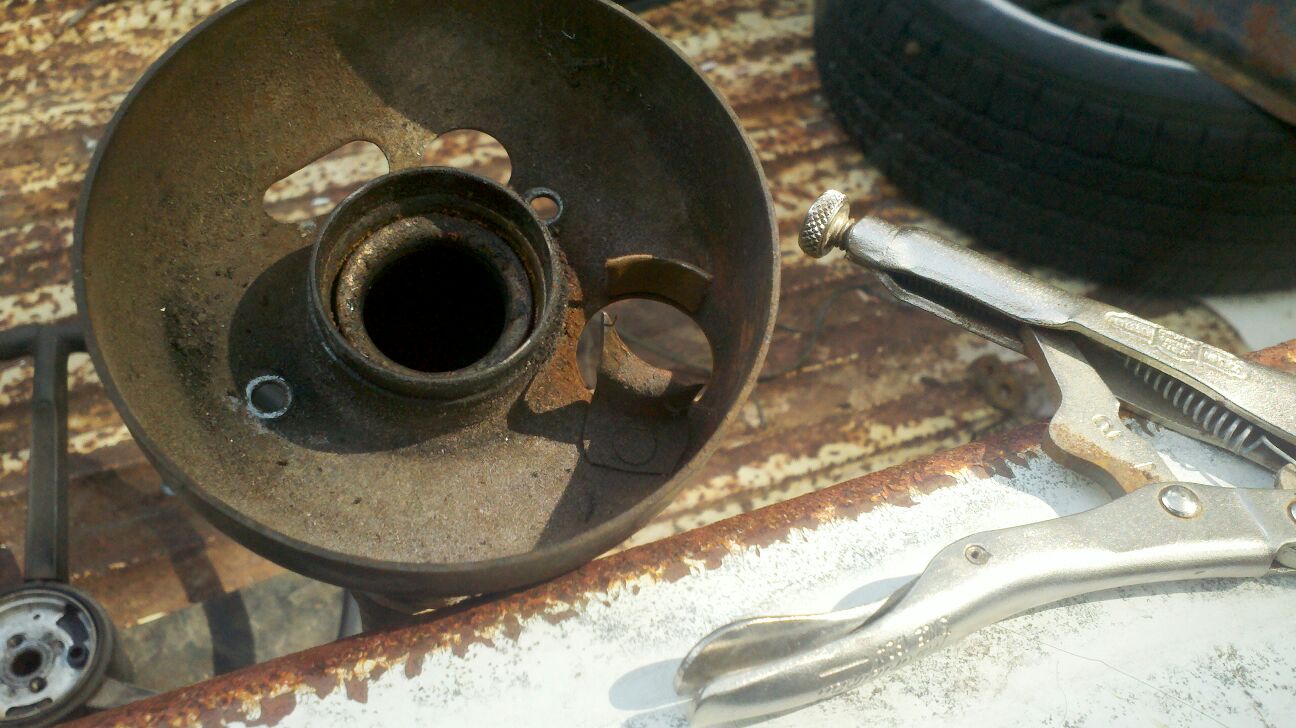

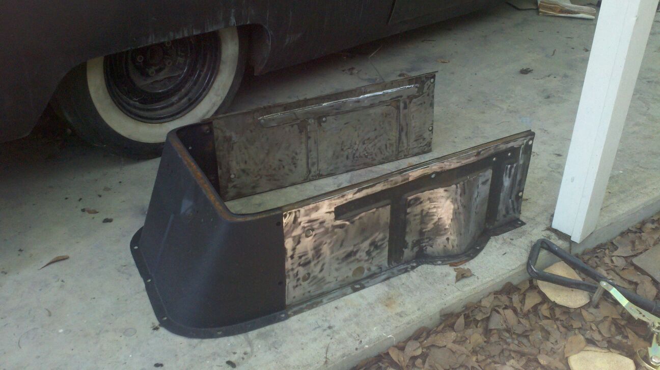

    This weekend I removed my steering column, steering box, and clutch pedal.
    I tore the steering gear box down, cleaned and rebuilt it. I also tore the column shift apart and cleaned it up. I am waiting for my new washer springs to come in for the column. I also need to repair the upper pivot mount on the column. the original broke.
    I also started stripping the rest of the dog house so I can get it primered and prepped for paint. I would have finished the dog house yesterday but some of my car club family showed up and drug me off to a BBQ. As hot as it was yesterday a little swimming, cold beer, hanging with my friends and good food sounded better than working on the truck.
    I cleaned out the cab of the truck to see what all I needed to fix on the inside. I have a few small patches to replace at the back of the cab and a crack in the front p***enger side.

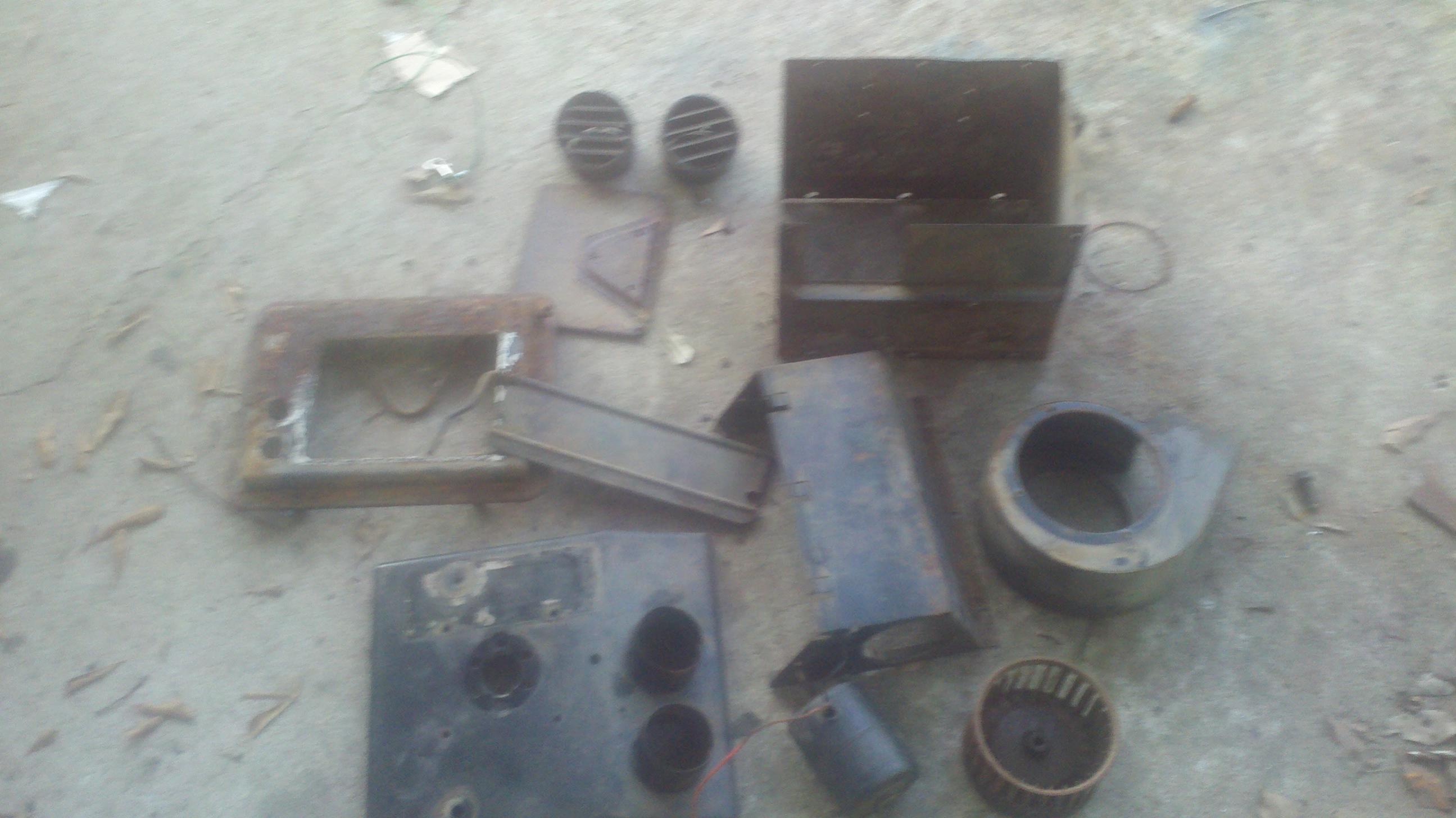

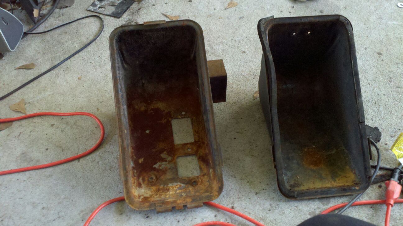

    Yesterday I tore the heater box down all the way. I will have to sandblast the base piece because of all the pitting. The rest of is should be ready for primer in the next day or so. And lucky me the fan motor is still good.
    I finished stripping the the dog house and got it primered..I still need to to do the lid to the doghouse. It is in good shape so I am thinking about just scuffing up the paint that is currently on it and just painting over it.
    I also did the battery box.
    The dog house, battery box, and heater box will all be getting painted here soon. the Battery box and heater box will go back black and the doghouse will be blue with white scallops to match the truck once it is painted.

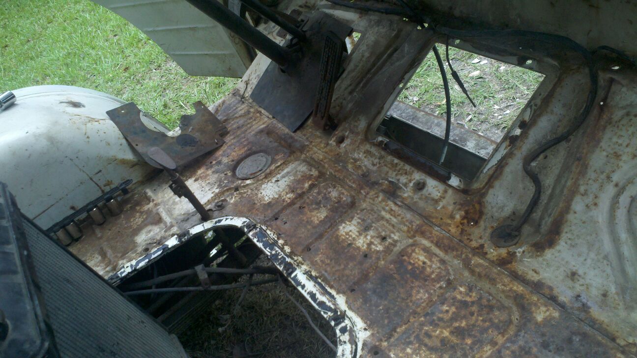

    Since I had the tank out I went ahead and dropped the rear weight that sits between the gas tank and the bed of the truck. pictured below is the 2.5" thick piece of cast iron thats under our truck for those who have never seen it.
    Since I had the tank and the weight out of the way I decided to go ahead and start cutting out the bed and getting it ready for the sheet of diamond plate. The sheet of diamond plate will be in next week. I think I might borrow my buddies plasma cutter to finish the job off...if not I am going to burn thru a lot of cutting discs.

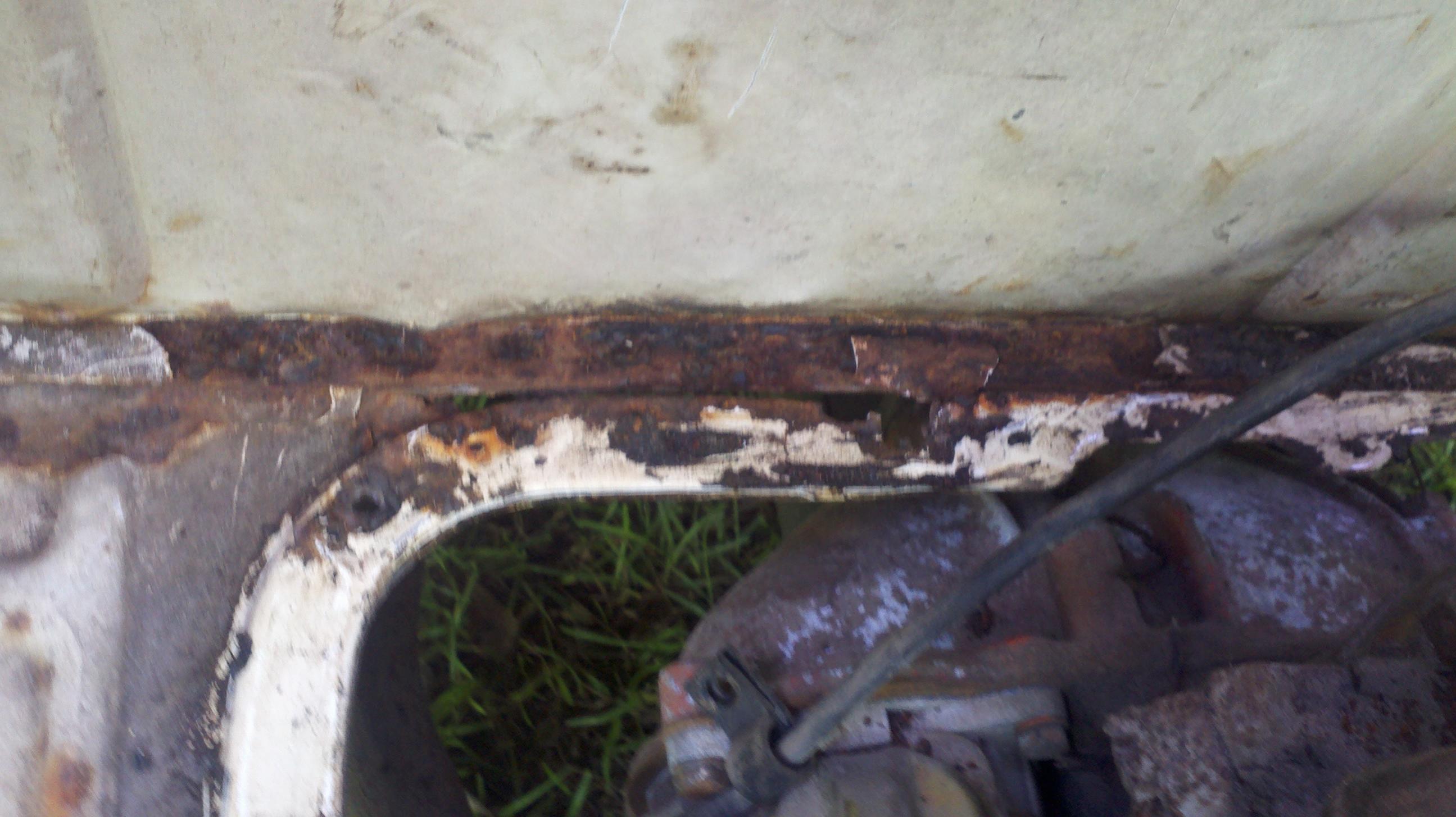

    ok...using the scaps of my supplies I managed to get the top of the bed on the drivers side stripped and a little more cut out of the bed.
    thanks to the Vintage-Van site I have found some people with parts I can use to patch up some of the badly rusted areas on the truck...like the front wheel well pictured below.
