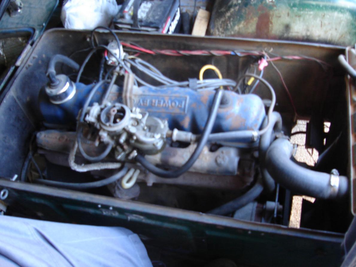

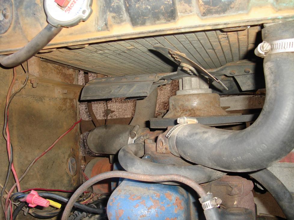

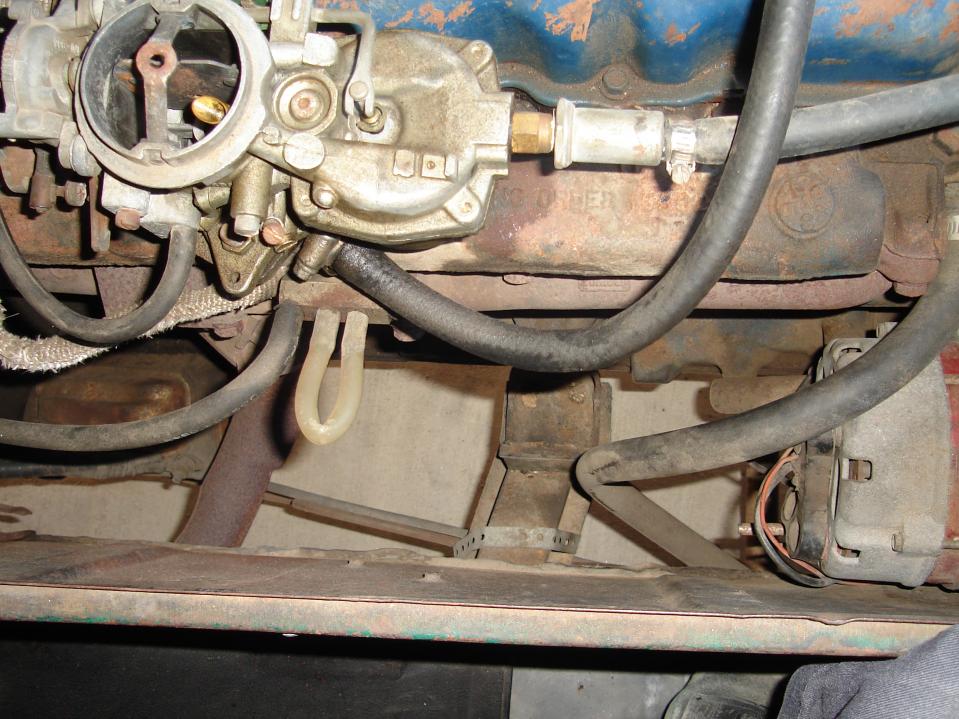

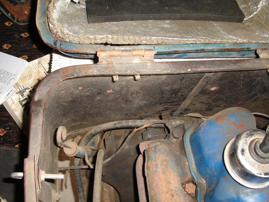

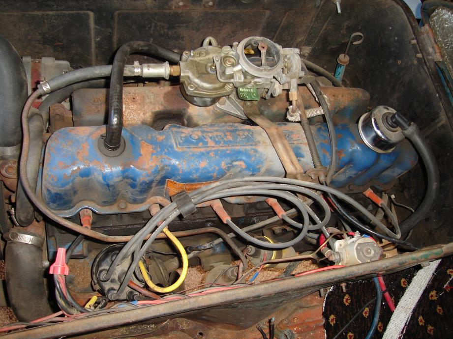

    Heres some pics i took today. Where is the battery supposed to be located? Has anyone found me seats yet!!!?!?!!:confused::D
    Sorry for the crappy pics. Its a tight fit; if you have an econoline, you know what i mean!! It looks like the motor mounts are factory. Hopefully this helps someone.

    The battery goes in a little box behind the driver's seat. There should be some holes in the floor that the cables run through

  10. You can tell it's a 250 small block six by the 4 bolt water pump. All others are 3 bolt. Your carb is a Carter RBS.
    The 250's are not a direct bolt in because they share the same bellhousing as Ford small block V8s 289/302 but use a zero balance flywheel. A '66 200 is a direct bolt in for an upgrade to the earlier Falcon 144/170 motors because they have the dual pattern blocks that accept any small block six tranny. Other than that any pre-80 200 will bolt in. The 200/250 has different distributor shaft that 144/170. The main difference in cylinder heads is combustion chamber size, valves sizes and carb throat; heads - they all bolt up 144/170/200/250.
    www.classicinlines.com is the place for parts. Clifford Performance just don't get it anymore. I ran a 250 in my '66 Ranchero with a T5 and tri-power. Cruised 80mph and got 26 mpg. Here's a pic in a Falcon post, page 9.

    depends on what you had to begin with. 65-67s could have a 170 or 240. All you need to do to swap in a 240 into a 65-67 is the 240 trans, 240 crossmember, 240 radiator, and 240 throttle linkage. BUT, if you have a 61-64, swapping in ANYTHING but a 144-170-200 is a huge pain in the butt.
    That 4 speed was a rare option, or a conversion from a second generation Econo. c4 trans were rare, too
