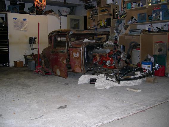

    Here's a couple of shots of checking for motor fit. Couple of things all going on at the same time here. I am t******* the firewall a little at a time getting the motor where I want it, and starting to figure out the ****** crossmember. I wanted to do a bolt in ****** mount. Since I don't see this 4 speed lasting long, I will probably be making a new crossmember to go with ****** 2.0.

    After getting the motor happy. I started the motor mounts. I bought generic sbc motor mounts and simply trimmed the mounting tabs to fit. I have these same mounts in my vette which is putting out close to 600 hp and they seem pretty stout. I like a rigid mount personally allows tollerances to be a little tighter on everything without worrying how much everything is going to shift under load.
