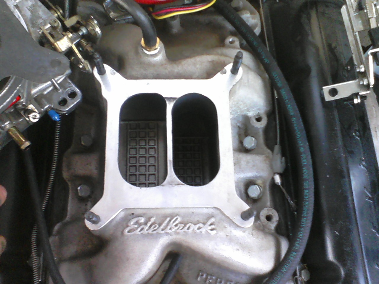

  8. do i need the adapter plate for this set-up??? edelbrock #1406 carb and performer rpm intake????
  9. hotroddon
    Joined: Sep 22, 2007
    Posts: 28,240
    hotroddon
    It depends on the part number of the Manifold - they make a Spread Bore and a Square Bore version - no on e can answer that question without the part number or seeing the manifold - end of story
  10. Very true hotroddon, i will check it out and keep you posted, thanks.....
  11. hope this helps in identifying the intake and whether i need the adapter plate......it says it is an edelbrock performer rpm and carb is 1406 edelbrock........
  12. robyyo
    Joined: Sep 8, 2005
    Posts: 248
    robyyo
    from Orange CA
    That's a square bore so you're good on that end. Someone said earlier you my want to make sure the choke is off and you may want to check the vacuum diaphragm on the distributor.
