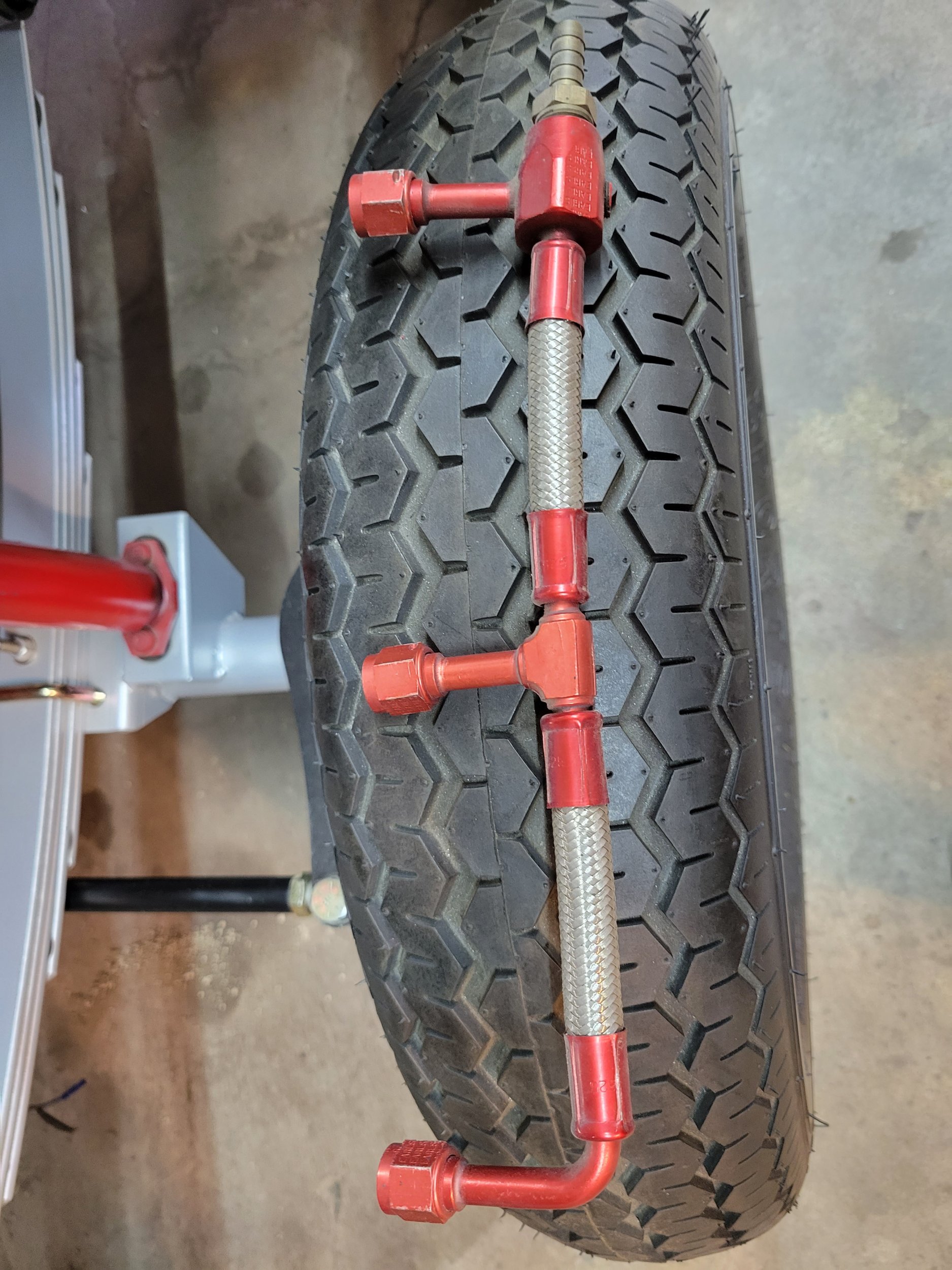

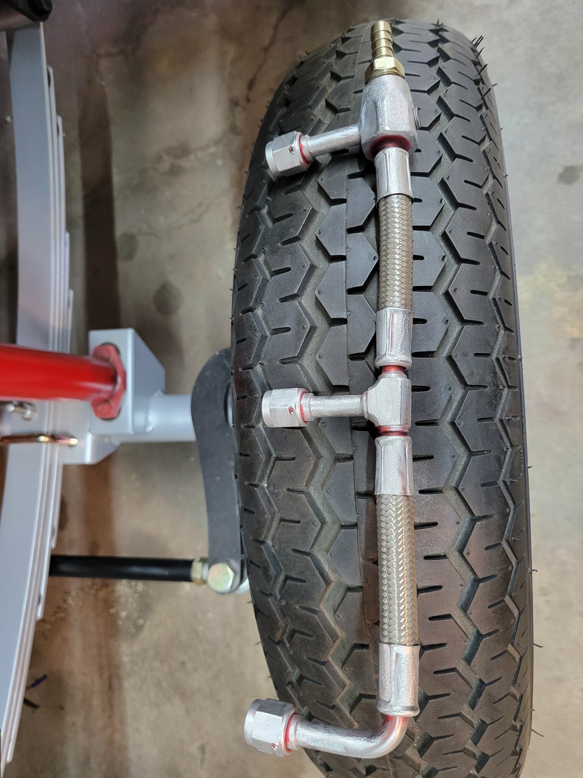

  4. If the AN fittings are red/blue wire wheel the anodizing off and cover up the braided line with heat shrink tube, electrical tape, hockey tape, spray on rubber coating.
    This is a line I knocked the color off of quickly one day but never finished the crevices with the Dremel.

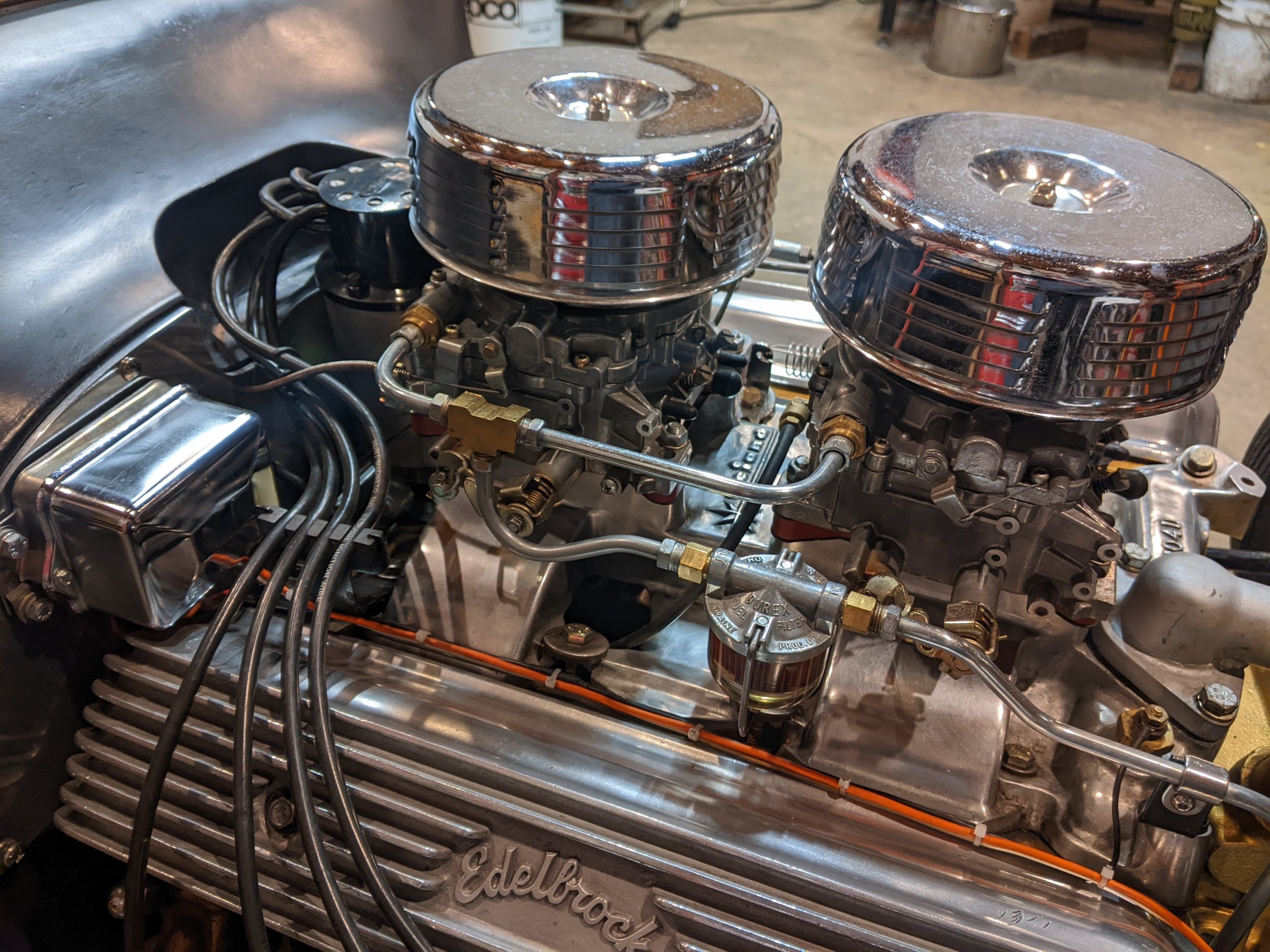

    yes the 8090 uses a sealing washer and accepts a 3/8" IF hard line.
    I didn't like the look of the fat 3/8" hard line and used Carter AFB fittings to run 5/16" line on my Edelbrock 1406s
  18. Looks fantastic Paul

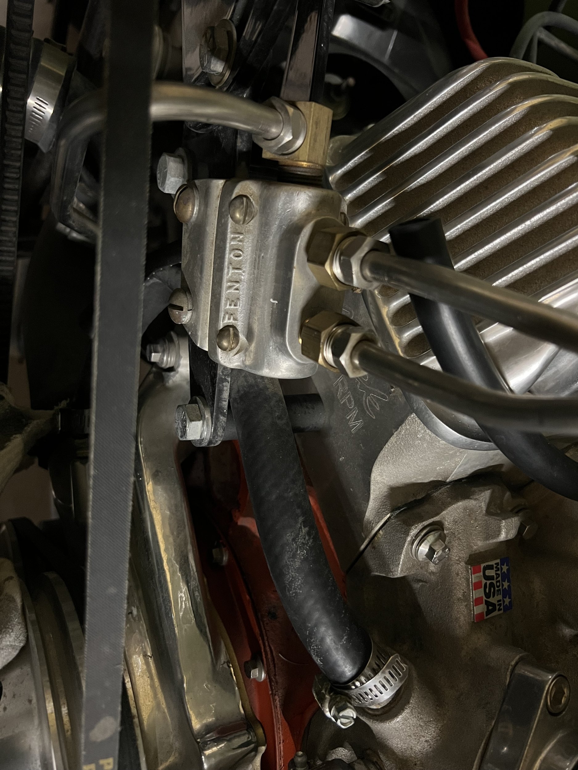

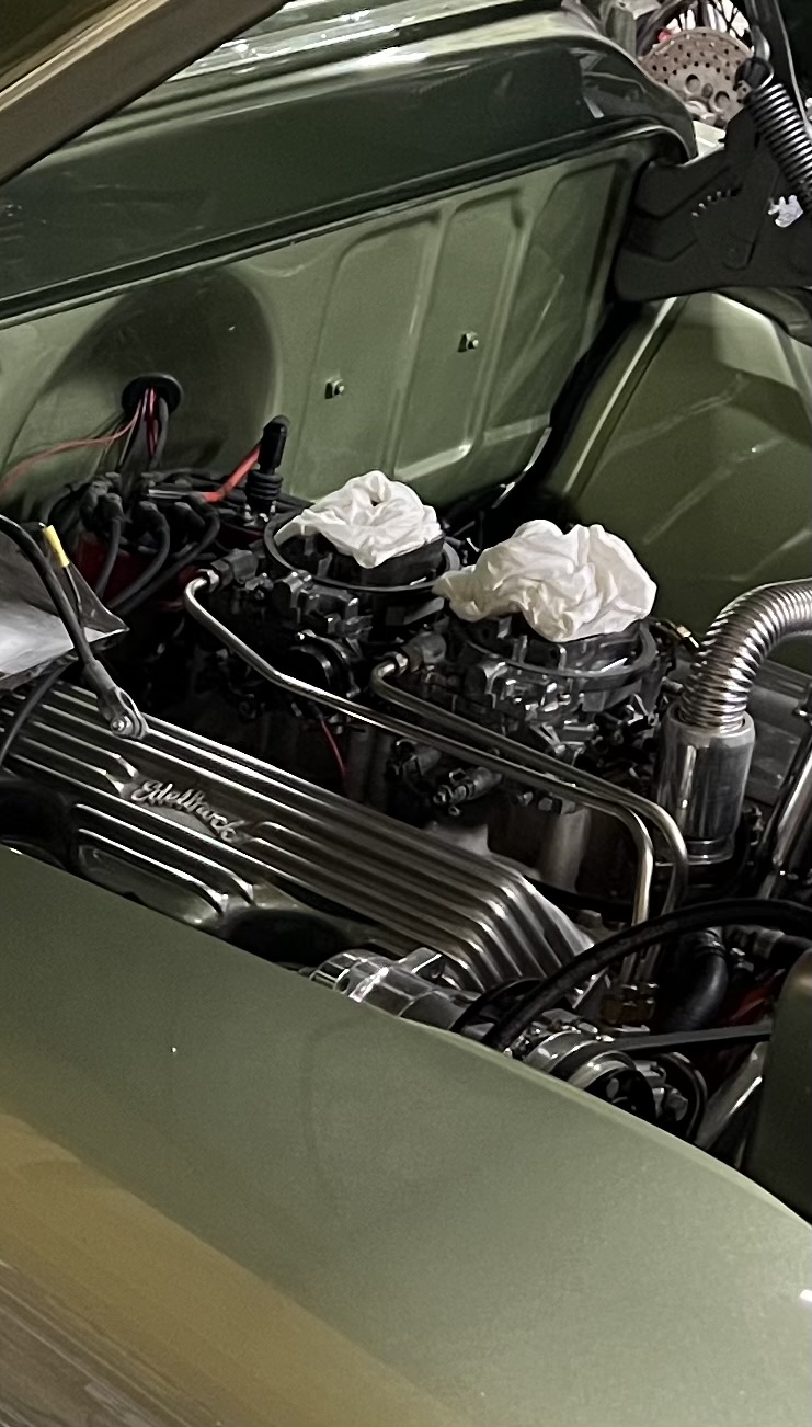

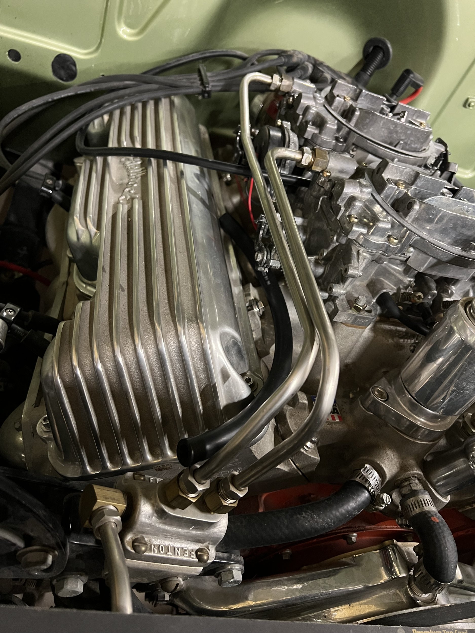

    Split mine a a distribution block but I used 2 of the edelbrock fittings to inverted flare. I can get a better picture tomorrow if it would help anyone.
  20. Thanks and more pics please. What did you use for the distribution block ?
