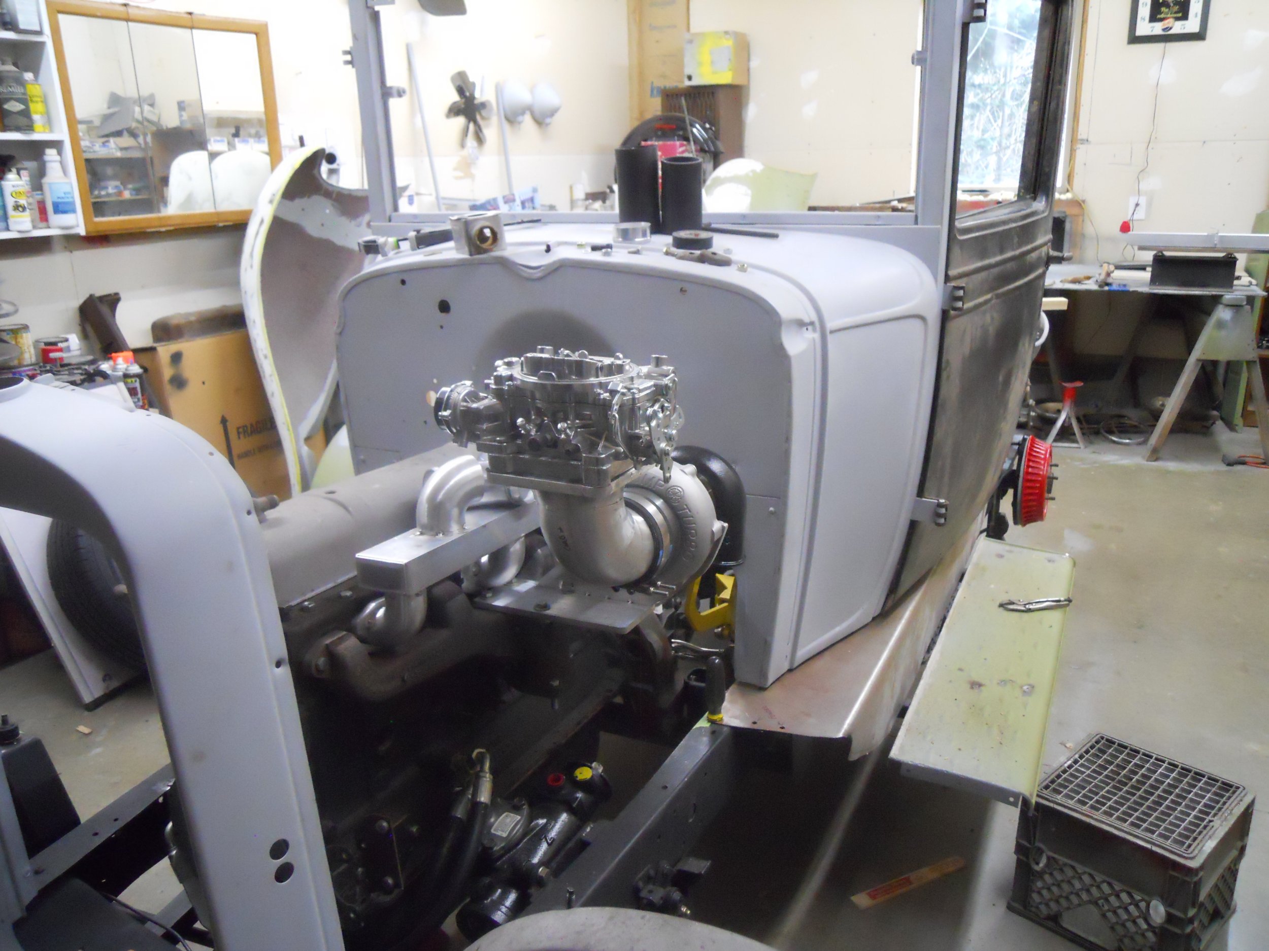

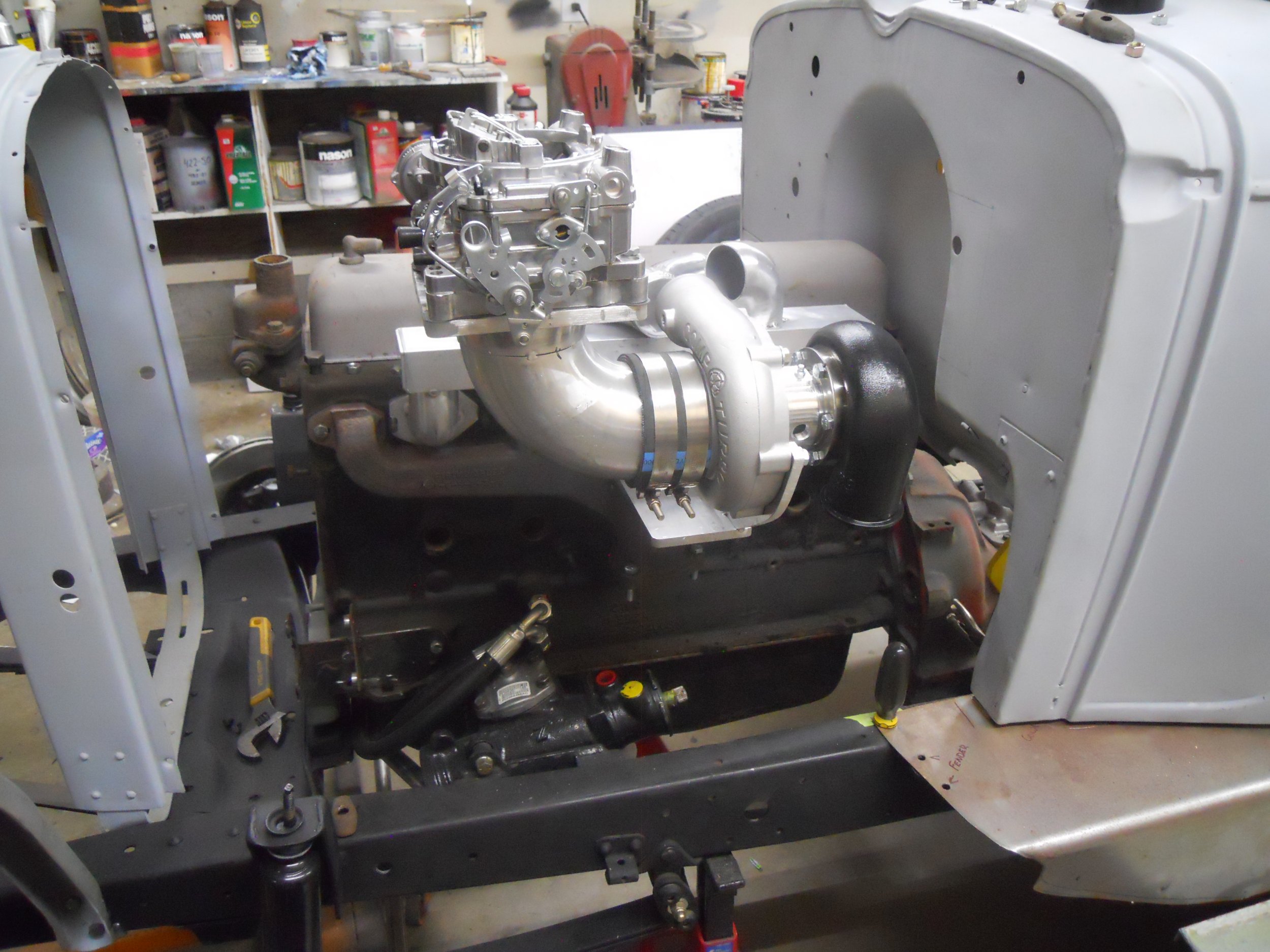

    i'm doing a draw through turbo on a 302 gmc six, the configuration more less makes me mount the 600 Edelbrock carb back wards. has anyone done this?? i had a guy tell me that the secondary's will open erratically because of the counter weight on them is working backwards. give me your ideas... thanks Jay D.

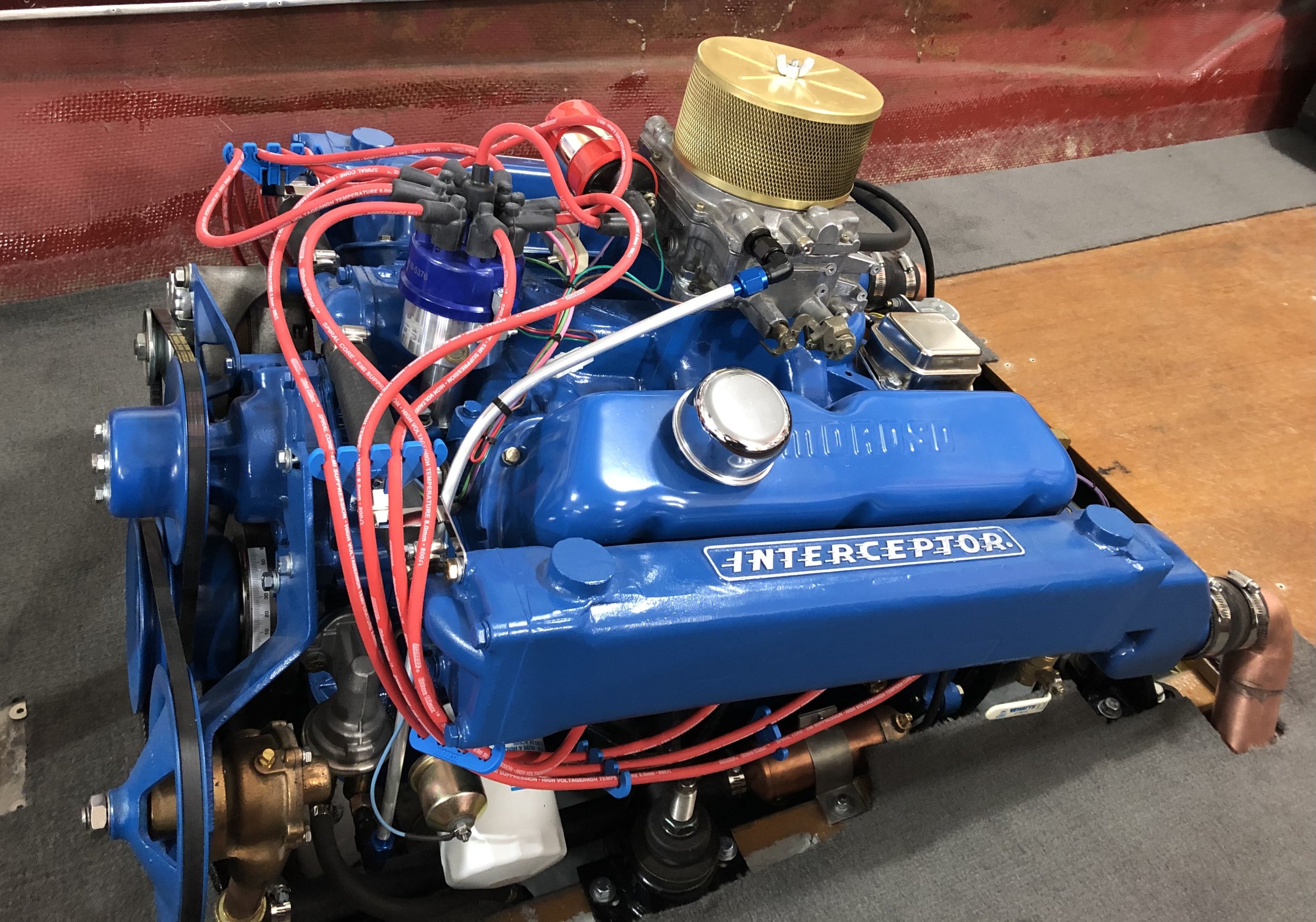

    Mounted backwards and at a severe angle on my ‘66 Correct Craft. Runs great.

    THANKS everyone, i'm going to try it this is what its on 31 chevy pickup 270 GMC.
    Jay D.

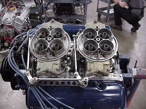

    Mount them however you need too. Sometimes there isn't enough room for "normal" mounting. dominator 8v.jpg
