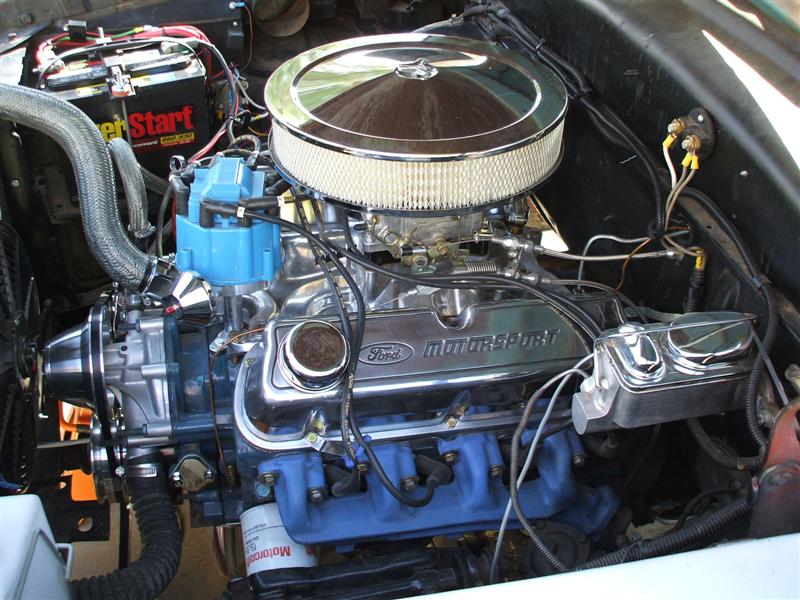

    I have a Professional Products polished intake on my 302 Ford the casting is smoother by far than the Edelbrock I had, it also has rear water p***ages as a plus which made things easier to hookup,the Edelbrocks water p***age in the front was so close to the distributor it made it difficult to time.
