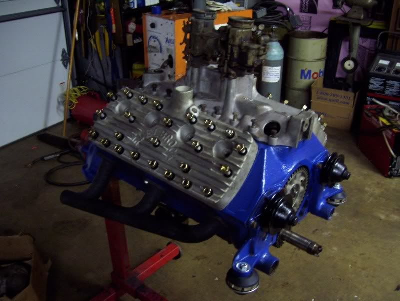

  12. Ask NealinCA he is running one. I have an original and it runs great, just the usual troubles of tuning the carbs and keeping them tuned. Definitely not a bottom end intake, they tend to run better at higher RPM, just as you would expect from a tunnel ram type of design.
    http://www.jalopyjournal.com/forum/showthread.php?t=400406
    here is a pic of mine:

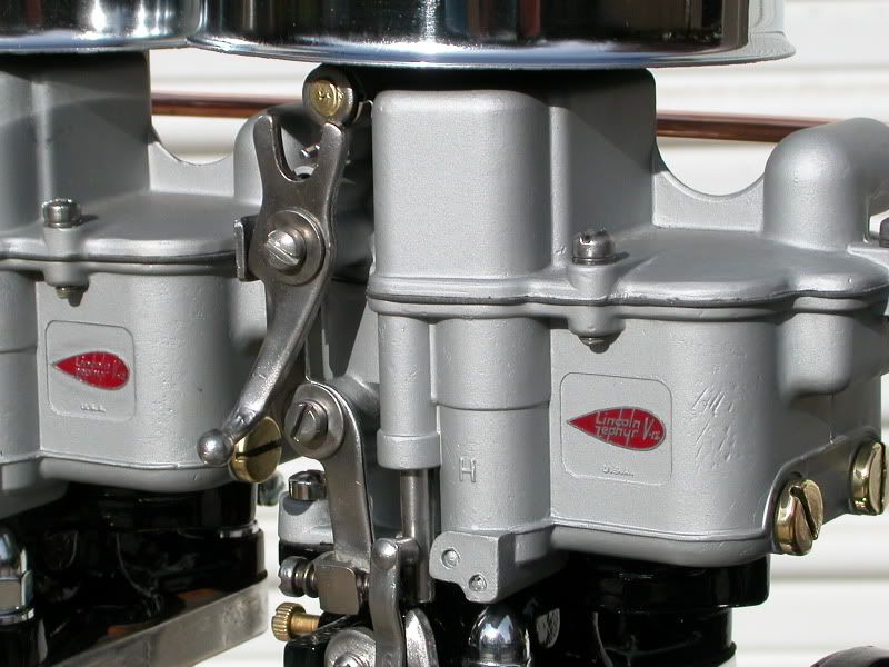

    Once I got through the fuel system gremlins, my rpu is running great with the Slingshot...
    I tried quite a few combinations...progressive linkage, plugged power valves, different power valves, jets, etc...
    The engine is 262 ci and I am currently running a pair of 91-99 Lincoln Zephyr "94"s with 4.5 power valves, .048 jets, and straight linkage. I am real happy with the performance.
    Neal

    Aw **** Neal, now I'm am going to have to find some Zephyr carbs now that I see yours. :D (I'm running the same Zephyr caps) :D
    I didn't realize there was a pre-war Weiand either.

    good luck finding the LZ 91-99 carbs. It took me just under 2 years to find my pair. They are a ***** to find in good shape. 39-40Lincoln only, and to make matters worse the 39-40 Lincoln also got Strombergs also, depended on which carb were available on the ***embly line. Lincoln was having problems with Stromberg, so they started using the Holleys. 1941 Lincoln was fed up with Stromberg and went exclusively with Holley, Lincoln went so far as to change their intakes to 4 bolt flange so that no Strombergs could be used on them.
