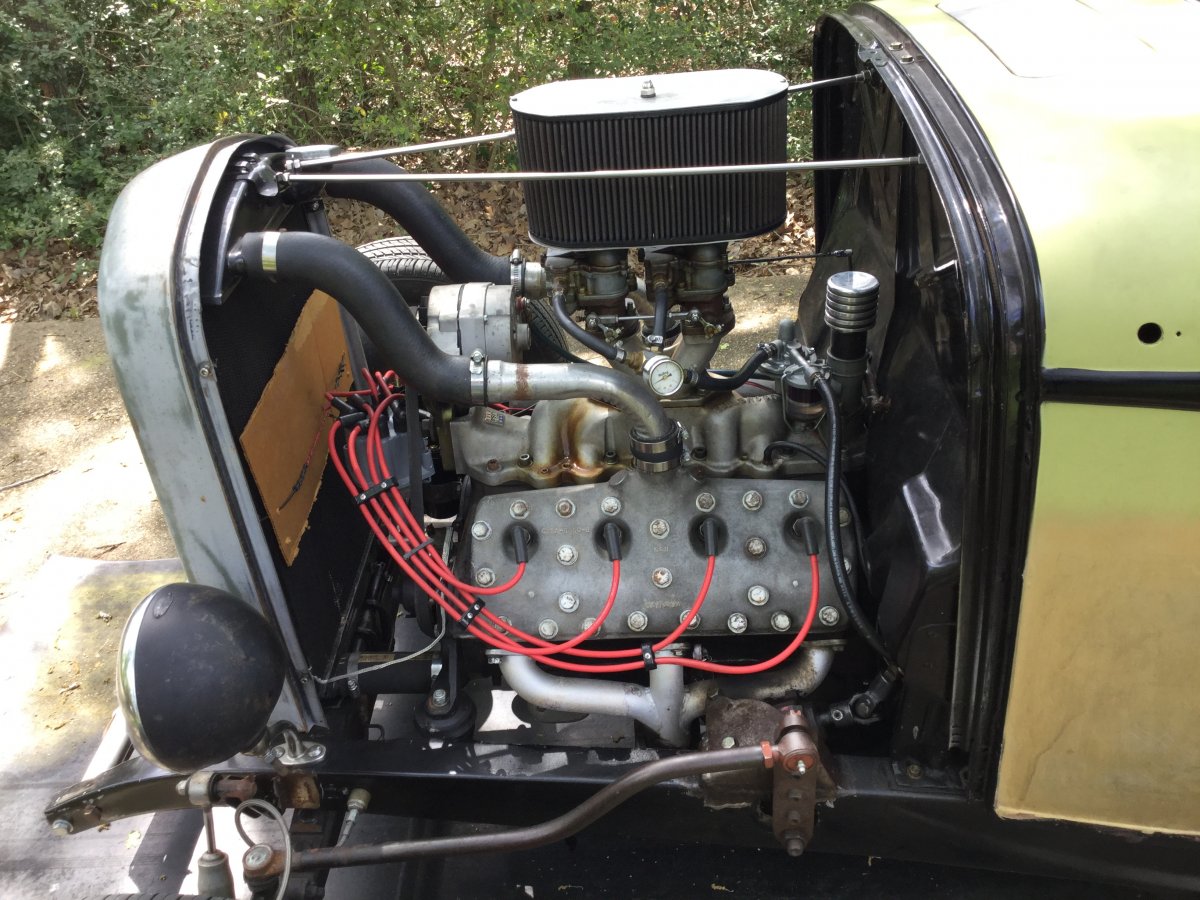

    You can use this intake on an 8BA, you just have to change over to an older style oil filler tube that has the breather and fuel pump mount in one unit. [​IMG]

    That's a very nice looking engine right there.

    I have started installing a slingshot on my 8BA. There were a couple obstacles that I encountered.
    1. I had to grind a part of the casting on the underside of the manifold that was hitting the oil vent tube inside the block. I don’t have a picture of where I ground the manifold, but it was about 1/8”, just match up the gasket and it should be obvious.
    2. The tracks in the front of the manifold for the generator mount are about .010 to narrow. I had to file the tracks out to fit the generator properly. Unfortunately I did not discover this until I already torqued the manifold down. I was able to file the tracks mounted on the engine, but it would have been better if the manifold was removed. I don’t know if an original manifold has the same issue as the new ones.
    Here is a picture of where I finished up today. I still have to fab up the fuel lines and the linkages.

    N
    Nice looking engine you have there.
