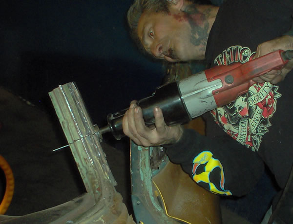

    next we laid out the cut lines on the a pillers
    thats jason(road zombie) pierotti helpin out
    then on with the show (cuttin that is )

    next we trimed the a pillers

    ok its time to set the a pillars and skoty chops stoped by to give me and lil dave a hand.
    as you can see the a pillars aint to far off

    not happy with the a pillars,
    (i thought they leaned back at 2 differant angles)
    me kool cat johnny (johnnykic) and lil dave cut the a pillars loose
    a pillars take 2
