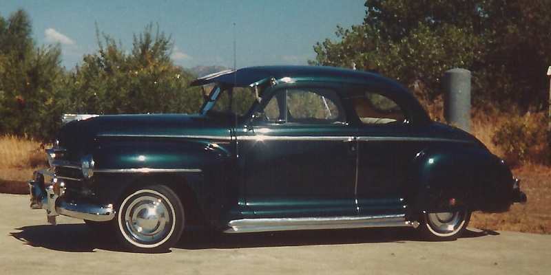

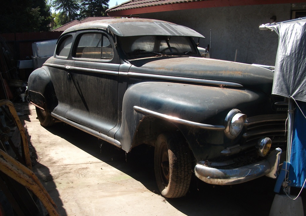

    I'm going to finally restovate my rusty Plymouth. Exactly how I'll do it up, I have not determined. I'm not exactly Daddy Warbucks, so modest finances will determine everything I must buy. A modern power train would be really nice if I can find the right donor cheap enough.
    Folks who have seen the "then and now" photos I've posted on the HAMB already, may have also read that I bought this 1947 Plymouth Special Deluxe Club Coupe as an amateur-restored mild custom in 1986. the first two photos are of "as it was" except without lowering blocks. I actually wanted to drive the car. LOL
    (Taken last week.)

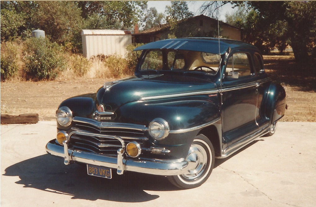

    Well she's aged a bit and gotten much dirtier since then. :rolleyes:

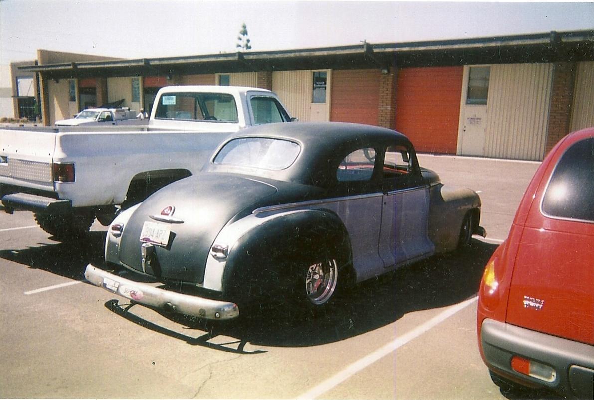

    Edith was a traditional lowrider (with the exception of not being a Chevy that is :eek: ) but I bought it to hop up, back in the days when smog laws had made older cars more attractive to hop up because new cars were untouchable by law.

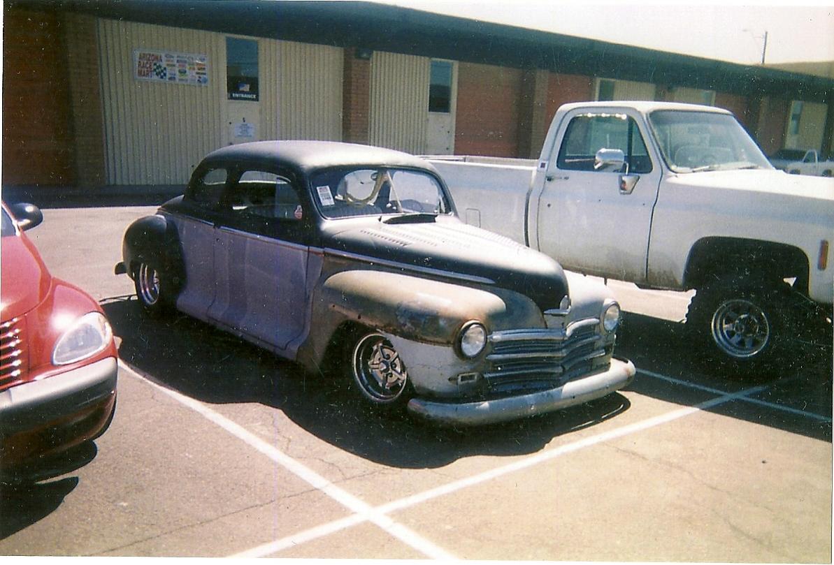

    After ditching some of the lowrider stuff (notably the VW tires, lowering blocks, bumperettes and lake pipes) I drove it as my daily ride through 1989, doing some needed mechanical restorations in the process. The brakes, steering gear, and electrical system were all a joke when I bought it. Lots of other shortcomings were became evident with the previous work.
    The paint started to crack on top after being exposed to fumes from a manufacturing plant, and eventually it started falling off.
    Man oh man, it's really falling off now!
    It also developed a wrist pin knock, but generally this car ran well. Eventually I took interest in other cars & drove it rather less frequently thereafter; and in 1992 I put it away in the garage and only did sporadic work on Edith. Other interests kept me away for some 10 years when we moved across town. When I parked it in the new garage I intended to start in again, but other jobs claimed my time and eventually Old Edith d' Plymouth was pushed aside to rust in my back driveway from 2004 until 2014.
    Times have changed for me and now I want this car again in the worst way. Go figure? Unlike a neglected woman, however, Edith is still all mine after 25 years of near total neglect. Time to renew some vows...:D

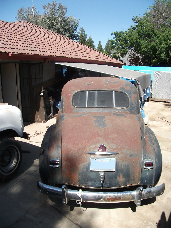

    I pulled it out yesterday so I could start work in earnest. This is what I found on the surface. (more photos of the crusty underbelly when I have time.)
    I built a cart from some old timbers and some new casters and bolts. I'll use it to move the frame out from under the body eventually, but immediately I had to monkey the Scout (the boat, a trailer, and a pile of rusty car parts & junk) out of the way for access, and that Scout was in a tight spot with frozen brakes and a seized engine. I put the scout on the cart and drug it around with a come-a-long. You can barely see the cart under the Scout here:
    It's 1963 BTW, with a '67 body & engine. I was 18 when Dad & I swapped it on back in 1973. I'll post it's resto photos some day (If I get it done) but on a 4WD forum. ;)

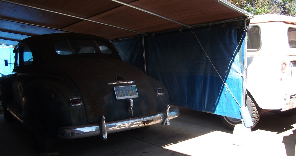

    For the first time in almost 10 years, Edith has a roof over her head! Well a tarp stretched over some cyclone fence poles at least. :eek:
    My intention when we moved to this house was to build a second garage/shop (the first being full) but the life and my family had different ideas for my money. I finally decided I wanted the car fixed no matter what I had to do, and so I will have to do the bodywork work outdoors, without A/C :eek: At least I have some place to work out of the sun, and plenty of spare concrete as I did manage to pour a 6-place drive way in the back in 2003 (Silly wife wanted more lawn...??? )

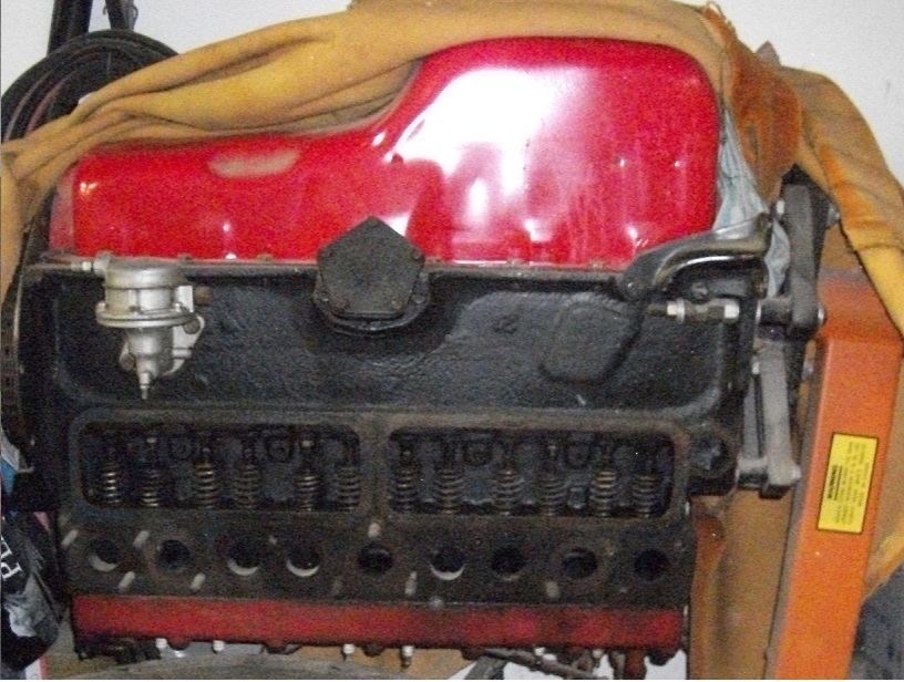

    Oh, lookie! '53 dodge 230cid & '49 (?) Plymouth w/ OD sittin' in my garage.
    I've got all the accessories (just stock. no fancy speed stuff.) I could keep it running. It would be fun too.
    The thing is that I already drove it stock for years, even though my original intention was to stuff this 350 Buick engine I had into it.
    And it was fun as hell; but I've been there, done that, & now I want something stronger.

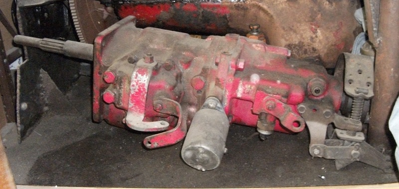

    I can't sell this one. My Scout was bought by my dad new in '63. I've had it since he passed in 2002.
    This is a Scout 80 with the bigger 4 cyl 1967 model engine & the 800 series body from a V-8 Scout we bought in Phoenix.
    Dad didn't like the heavy IHC V8 engine & had planned a Ford V8 swap since way back 1968, but it never happened. His new 289 crate engine wound up in my '66 Ford coupe. :)
    He wound up with a Scout turbo engine. It sits in my garage unused.

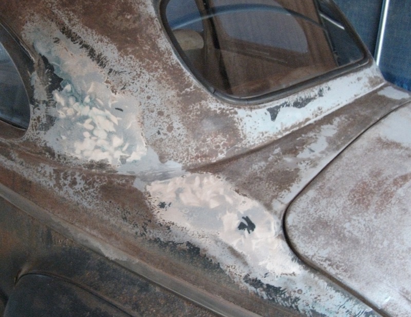

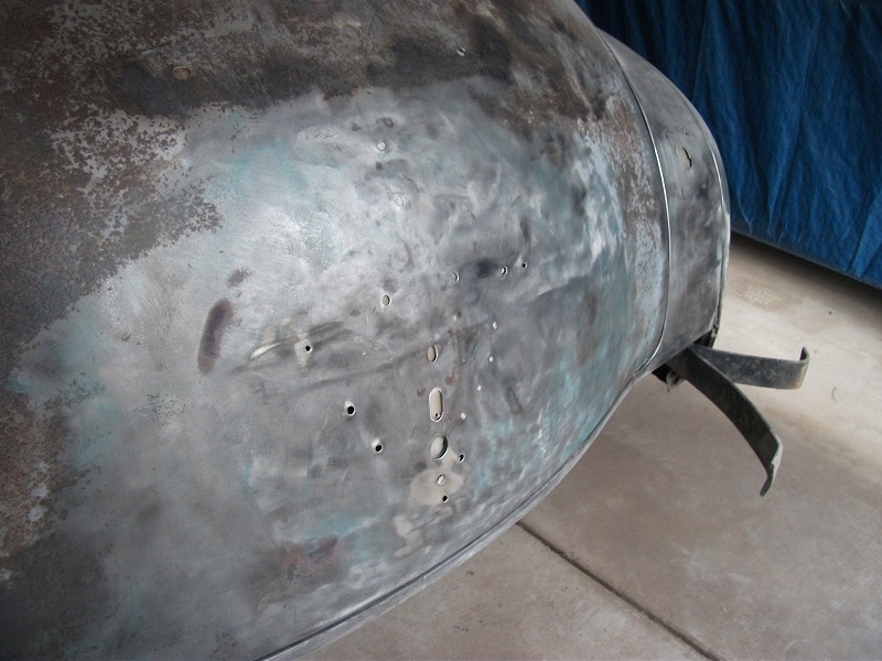

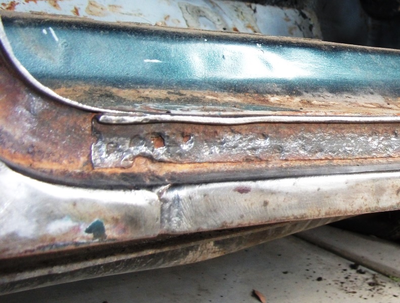

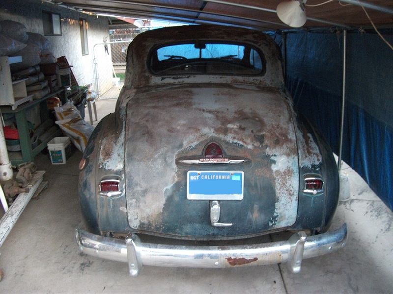

    After some other preliminary chores, the stripping has started.
    I can't strip the trim off yet, as I haven't got set up to store all the stuff in an orderly manner, but I had to start digging in. I've wanted to re-paint this car for at least 25 years.
    The lacquer and primer were very thick but here seems to be only about the normal amount of bondo, with some lead under that.
    So far, this spot is the only thing that has clearly rusted clear through. Actually this spot was nearly that bad in 2004 when I pushed her outside.
    EDIT: well that's not true. There's a spot in the driver's floorboard where the rubber "running board" tits go through the floor.
    I'll have to get a shot of that when I get it jacked up.
    Otherwise I don't know of any other spot with real rust-through.
    I may find out different when I get all the paint and filler ground off though.
    :rolleyes:

    I found no original paint on the outside so far. I believe this car was a bit rough all over when it was repainted in the '70's, owing to the thickness of the filler primer used. I'll see what it's like underneath the paint all over soon, but I'll probably be digging out lead also. I found a bit of hokey leadwork already, right above the upper left corner of the trunk lid.

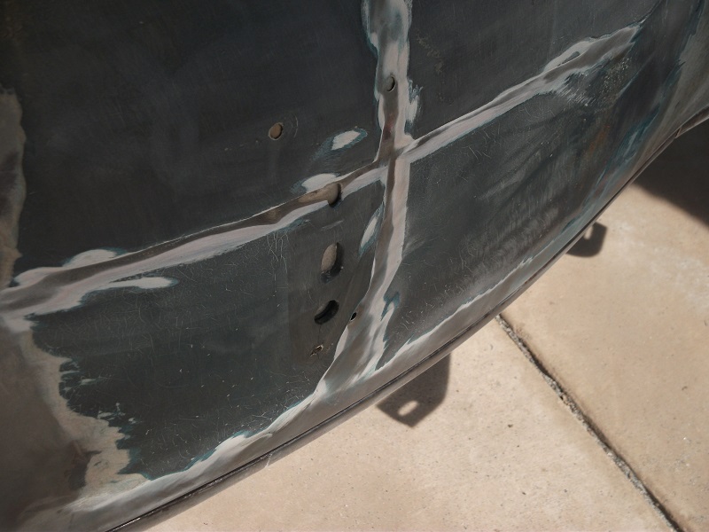

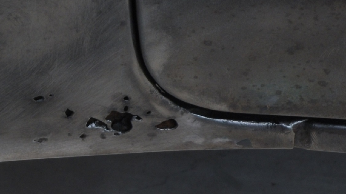

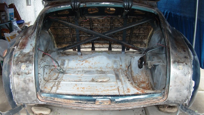

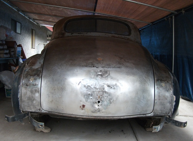

    OK some new pics. I got out last night and went after the rear quarters and trunk lid.
    "X" marks the low spot and the arrow shows the rot.
    I quit grinding when the bondo got thick:
    Yeesh! close to 1/4" at the worst spot so far:
    Here's the rot, all exposed.
    I'll probably cut that out tonight. I want to have a look at the bottom & the back of the inside panel & seams first, to make sure I'm cutting enough.
    There's a little more I'll show later, but this is the worst spot on the whole body, as far as I know.

    Oof! I just ground out all that bondo. It was nearly 1/2" at one spot.
    Now I'm wondering how bad the rockers really will be. ???
    There was torch work evident under the lock mechanism, and puller holes galore, but no evidence of competent bodywork.

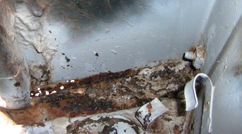

    I took some more photos this AM, after cleaning all the junk out of the trunk. I'm really smiling at what I discovered, too. :cool:
    The trunk floor is in really good shape. I haven't dropped the tank yet, so no telling what's below, but from the top she's pretty primo.
    That weatherseal retainer lip is rather eaten at one end, but what's behind it is absolutely solid from what I see below.
    There's that rotten spot on the left rear QP, from the inside. After digging out the tar-type body sealant, what is seen from the outside is the worst of it all by far. (The passenger side was 100% perfect under the tar too. :) )
    The inner floor edge is just barely damaged, and appears to be not rusted back, but bent back just a trifle. I think this spot was bent and straightened long ago, and the unvisible floor edge just ignored.
    I thought this spot (the trunk latch striker pocket) would be cheese, but not a speck of it!
    I really lucked out, and also I'd repaired the trunk seals years ago, and in 9 years of sitting in the rain it never leaked. No evidence of carpet mold when I pulled it out, and just the most minor rust in the spare tire well.
    I darkened the shadows on this photo so you can tell how lumpy the lid is after removing the bondo. At one point I was using a mallet & chisel on the thick spots, and that bondo was actually very solid. There was some minor surface rust under it in spots, and it was lifting slightly here & there but I suspect it would have made it many more years.
    So far every bolt and screw has come out easily, and I'm having a fine go of it all. This is what they mean in Hemmings when they advertise "easy restore". God I remember what cars looked like in Minnesota after just 5 years. My 6-year old Ford from Baudette Mn. had holes the size of a baseball in the QP.
    I'm feeling really lucky and very thankful here guys! :D

    I went over the fenders, tips & door bottoms with a strong magnet. I spotted a bit of bondo at the rear fenders, but not insanely thick. Can't tell about the rockers until I get the trim off. I think this car might wind up with a custom-by-ulu tin rear apron. Edith has always had a draft up her butt due to the missing apron.
    Maybe one of the P-15 owners would post up a pic of their rear apron so I can get an idea what they look like? I thought about making a custom front visor as well. The one I have now is just too hokey

    I left that job in 1989. :) They did painting and annodizing. The air at my desk was OK, but I wouldn't want to work over those tanks for long.
    It's a great old car still, but I dunno how great the actual build will be. Remember, I'm a hobbiest who's been out of the loop over 20 years. It's been almost 40 years since I last painted a car.

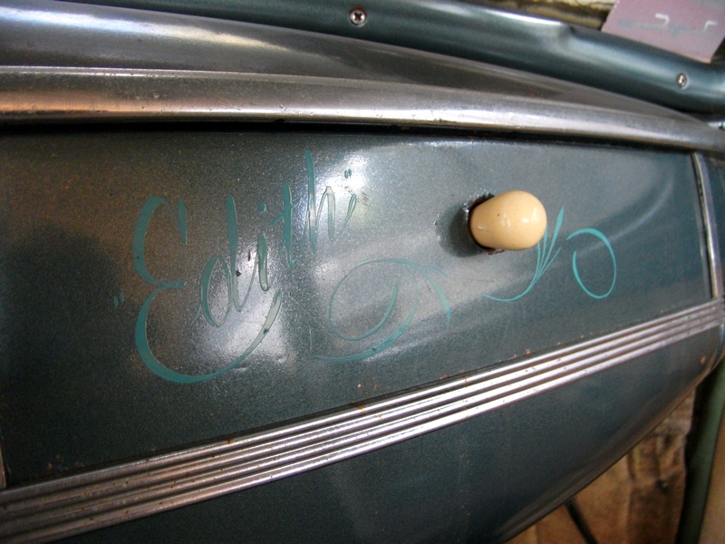

    I did do some custom work, though. I stripped (EDIT: striped not "stripped" big difference!) my '66 Ford. (turned out awful.) I did a few motorcycles with funky '70's style psychedelic crap, which truned out good. I also laid out the flames on a 5-step flame job on a 32 Ford PU, but did not paint it. I merely directed the painter on that one, but it was pretty dang good.
    HOWEVER: I painted my little boat about 12 years ago with urethane, and these new paints scare me! I might have Edith's parts pro-primed in epoxy, in batches, then just finish it myself in lacquer.
    All I can say for 100% certain is that 30 yeas ago I saw it done on this old GM car with IFS very similar to the P-15 IFS & it had the top arms flipped. That car was in the weeds too, with forward rake & I dug it, but never saw the owner to ask. It appeared to be an old Chevy 2dr sedan with a maybe a '41 Buick grille & Convo Pro wheels. Awsome wheels. :D

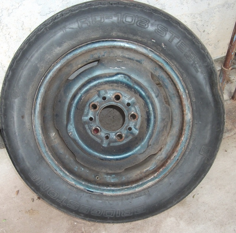

    I did a lot more metal finishing on the deck last night. Except Edith doesn't have a deck. It's more of a bustle. (Cue, I Love Big Butts)
    I'm sorry now I let her rust, but a year ago I simply didn't care. I had a new car and a new hot-rod truck, and a big touring bike, and a fishing boat, plus the right seat in a lightplane. I had other interests that I'm ignoring now. Aw, with the drought you can't fish much here anyway...LOL
    This was the spare, but it's not an original wheel. I think it's 60's Ford or Mopar. That's a VW radial 165-80 P series.
